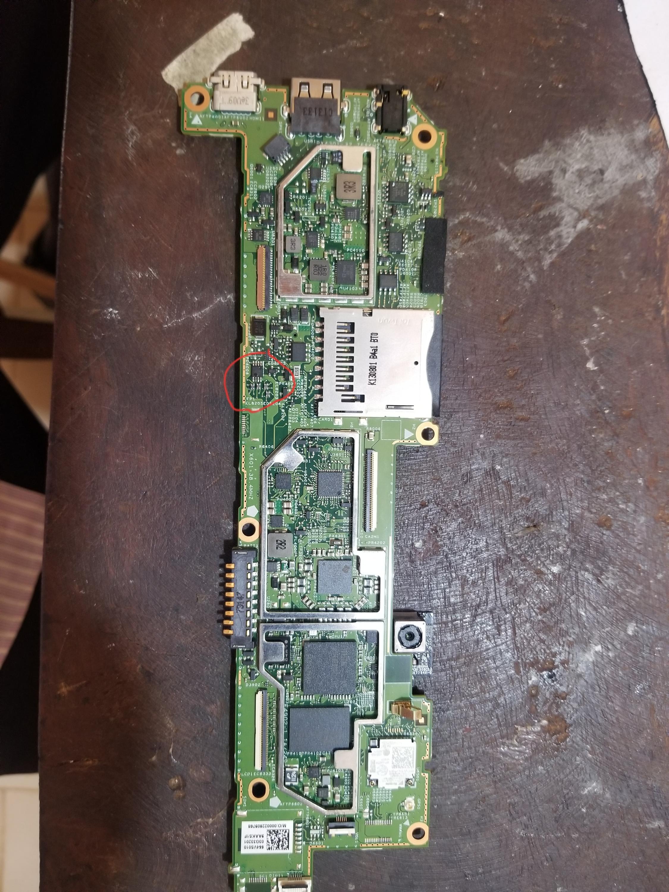

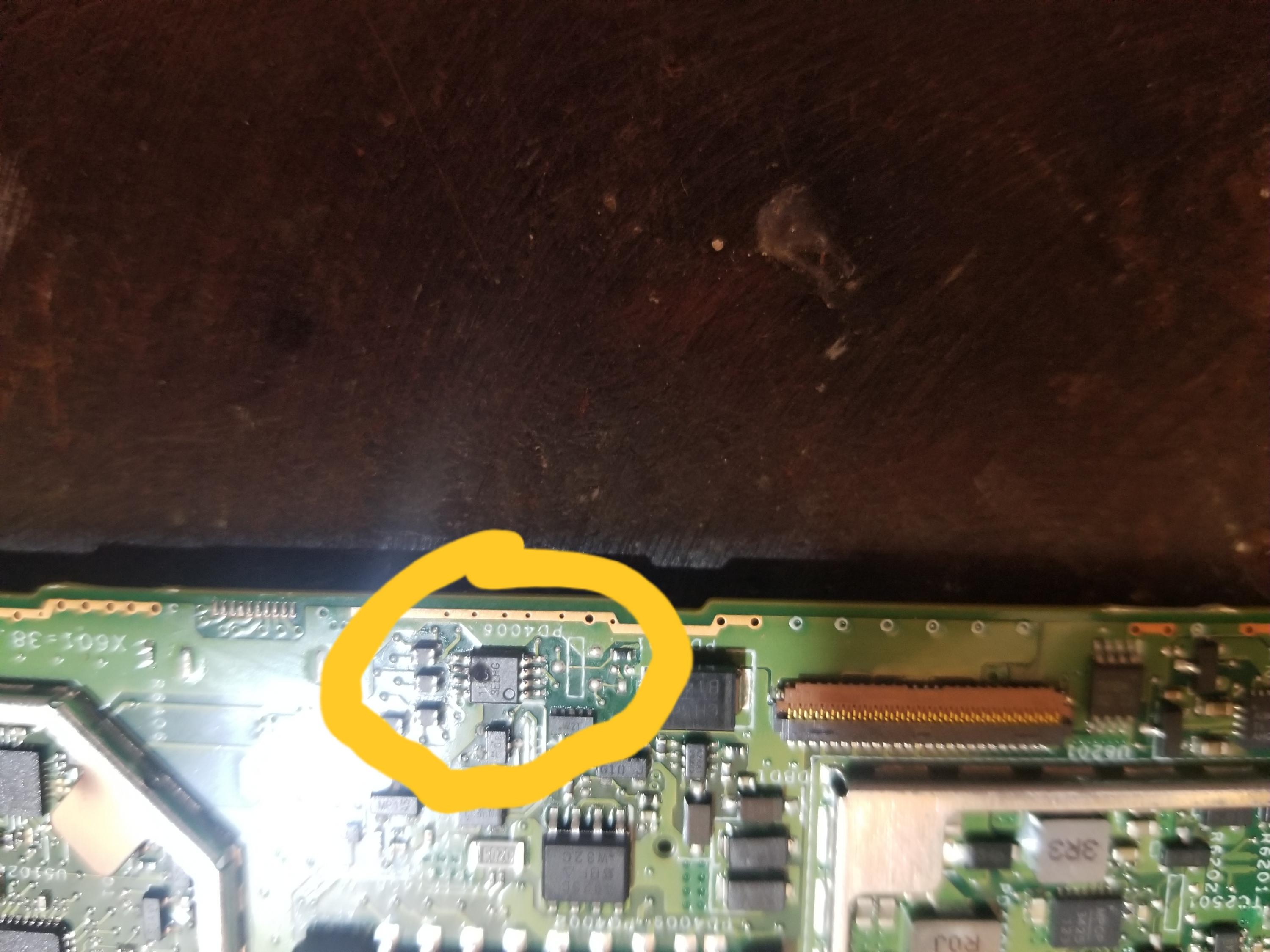

    Greetings....
    The above tablet is not turning on nor charging. I noticed a diode close to the battery connector has blown. The number on the 8-legs diode is "3EEHG"
    I'm having problem identifying this part for replacement.
    Please help

    Post a clear and zoomed up picture of the part.

      Attached are the pictures of the board with the burnt part circled

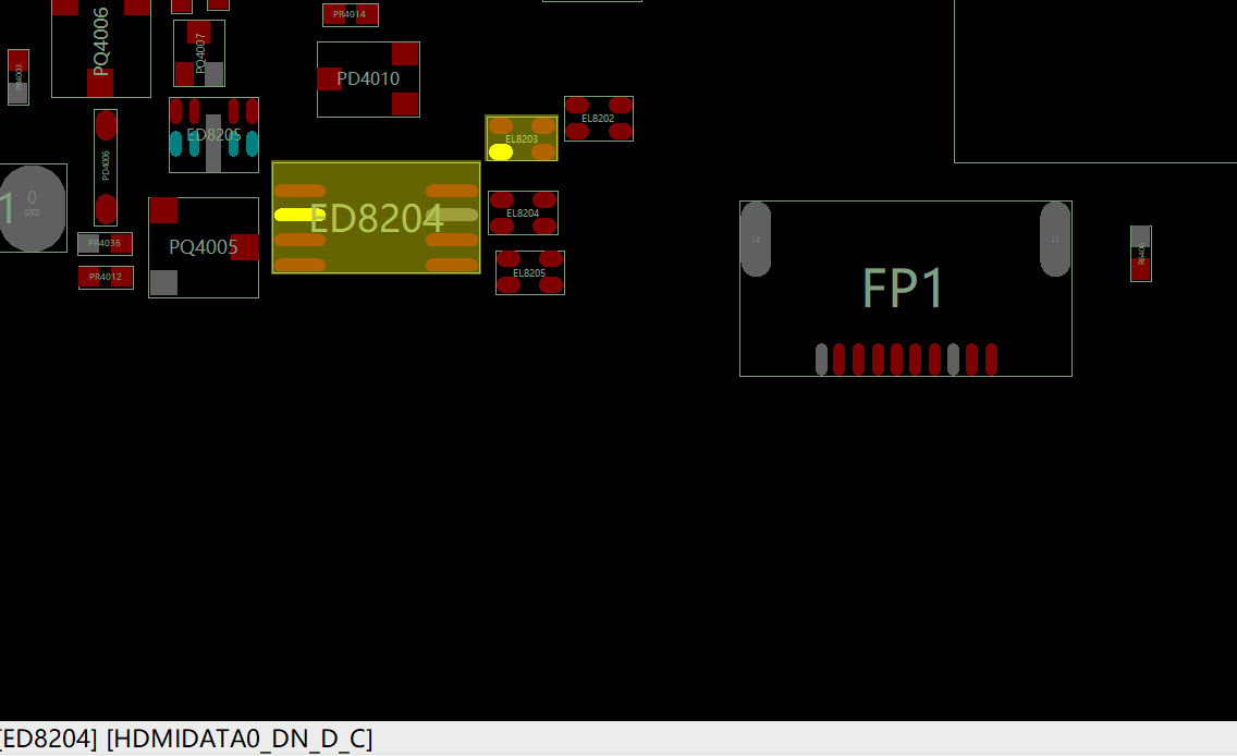

        There is schematic for this, but only on paid sites like vinafix, I couldn't find anything free.

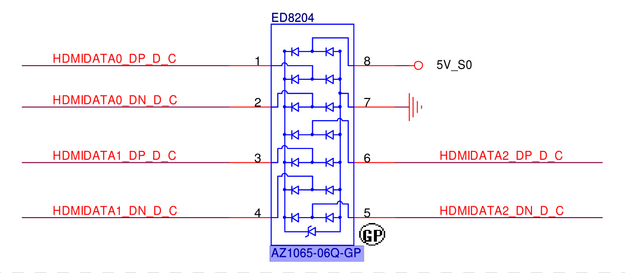

          See attached. Mystery solved. Do not ask me to explain the trail that got us here but it makes perfect sense.
          This is an ESD protection array for the HDMI section that Dell / Wistron likes to use.
          Datasheet is attached. You should be ok to find these on Aliexpress and also possible to replace with others.
          The real p/n is on the TOP LINE which was damaged and is '118'.
          The 2nd line that is visible = datecode for the actual part.
          Here is one store of many that can supply this part:

            Thank you so very much.
            Thank you
