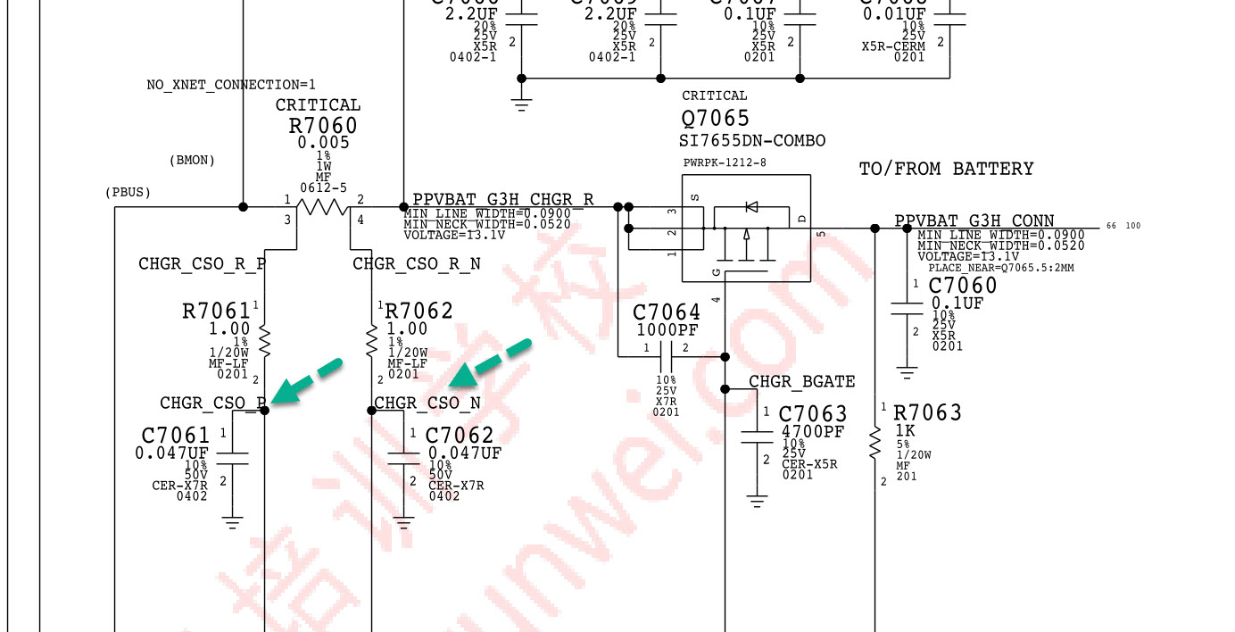

        Other areas to explore after the above is to check the charging circuit but the detection is often linked to this area / physical connector faults.
        The charging circuit will have a current loop that must function properly. If the loop is broken, the charging circuit will shut down.
        See attached - check the voltage at the green arrow points to confirm there is a minor or now voltage differential on the 2 legs.
        Post the voltage readings on each side. You can also remove all power -> meter in resistance mode -> check the resistance on each leg to confirm the series resistors are as per the schematic values.
          R7061 & R7061 shows no difference in voltage, and resistance value looks good as the schematic ones.

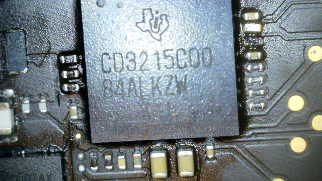

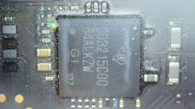

          But then.. inspeting under the microscope other areas, I found this little corrosion around U3100:
          R3103 (UPC_XA_R_OSC) and R3105 (UPC_XA_UART_RX) were mainly affected.
          I cant really figure out how liquid reached that parts, there is really no other evidences of how could it be penetrated.

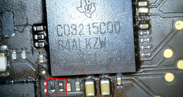

          Then I start cleaning it using IPA and toothbrush to gently remove the corrosion. After that amtech FLUX and reflow the whole area, including U3100.
          This is the result:
          Then re assemble, plug in DC in and now it was taking 20v and more than 1A, finally charging! I was able to finish DFU revive and get it back to work. Now it seems that all usb-c funtionality are back (charging, video out, data exchange and so on.)

            Change this two resistors just to be sure that it won't happen again. I see that the first one still has damage from corrosion.
