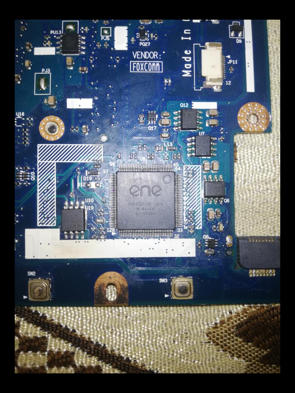

    Sir, gate voltage remains almost same when I press on/off button
    PL5 (batt+) 55.5 k
    PL7 (+1.8VP) 174 ohm
    PL11 ( +1.05VSP) 23 ohm
    PL10 (+CPU_CORE) 62 ohm
    • mcplslg123
      • Jun 2015
      • 7262
      • india
      Re: Acer aspire one not power on
      Post a clear pic of SIO.
      • usyusy
        • Sep 2021
        • 171
        • Pakistan
        Sir as desired
        • Udemzy
          • May 2017
          • 151
          • Guatemala
          3.3v/5v present and power button led light glow for some seconds and turn off, check your SIO requirements.
          But before then check if standby IC pgood is available. Check if 3.3v/5v coil frequency is fine,output and input before moving to sio, check if rsmrst# is available (active low or active high) when power button is press.
