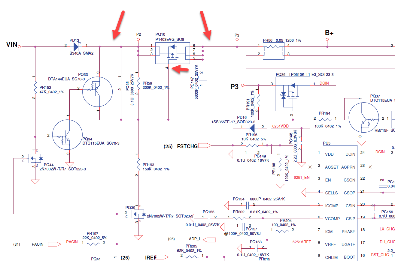

    See attached. Review the details of PQ10 DCIN mosfet.
    Post the voltages on the pins shown with the arrows.
    Next, remove all power -> check the resistance across the mosfet pins.
    See the many other threads here on how to test the resistance to confirm if the mosfet is defective or not.

        Sir, on PQ10 DC IN mosfet:
        Voltages on
        Source: 19.7
        Gate. 7.8
        Drain. 19.7
        Resistence: on 200k settings:
        Drain & source 44.3 k
        Source & gate 81.6 k
        Gate & drain (on 2M setting): 590 k

            Replace PQ10. The resistance is too low to be a good mosfet.

                      yes i know this site , it was a nice advice from you from another thread....but still confuse , the reading of usyusy are perfect to me...did you compare it with another same mosfet or from mosfet datasheet
                        Re: Acer aspire one not power on
                        No. Do not have these parts here but expecting a much higher resistance reading for the same measurements (100kohms++).
                        Since the resistance checks are similar for both parts on the logic board, the mosfet may be ok but let us wait on the OP to post the resistance values of the mosfet while it is out of circuit.
                        The support components on the logic board may be influencing the resistance values.

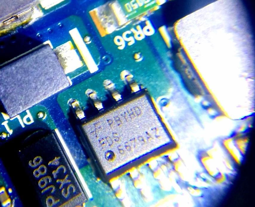

                              Replacement done with another mos
                              Drain & source 322 k
                              Gate & drain 588 k
                              Gate & source 197 k
                                Ok. What mosfet was used for the replacement ? Share the part number.
                                With the new mosfet, what are the results ?
                                What are the voltages on the source, gate, drain pins of this mosfet ?

                                  Its was Pbyhd fds 6679az something written on it, pic attached
                                  Results are same
                                  Voltage :
                                  Source 19.7v
                                  Drain. 19.7v
                                  Gate. 7.7v
