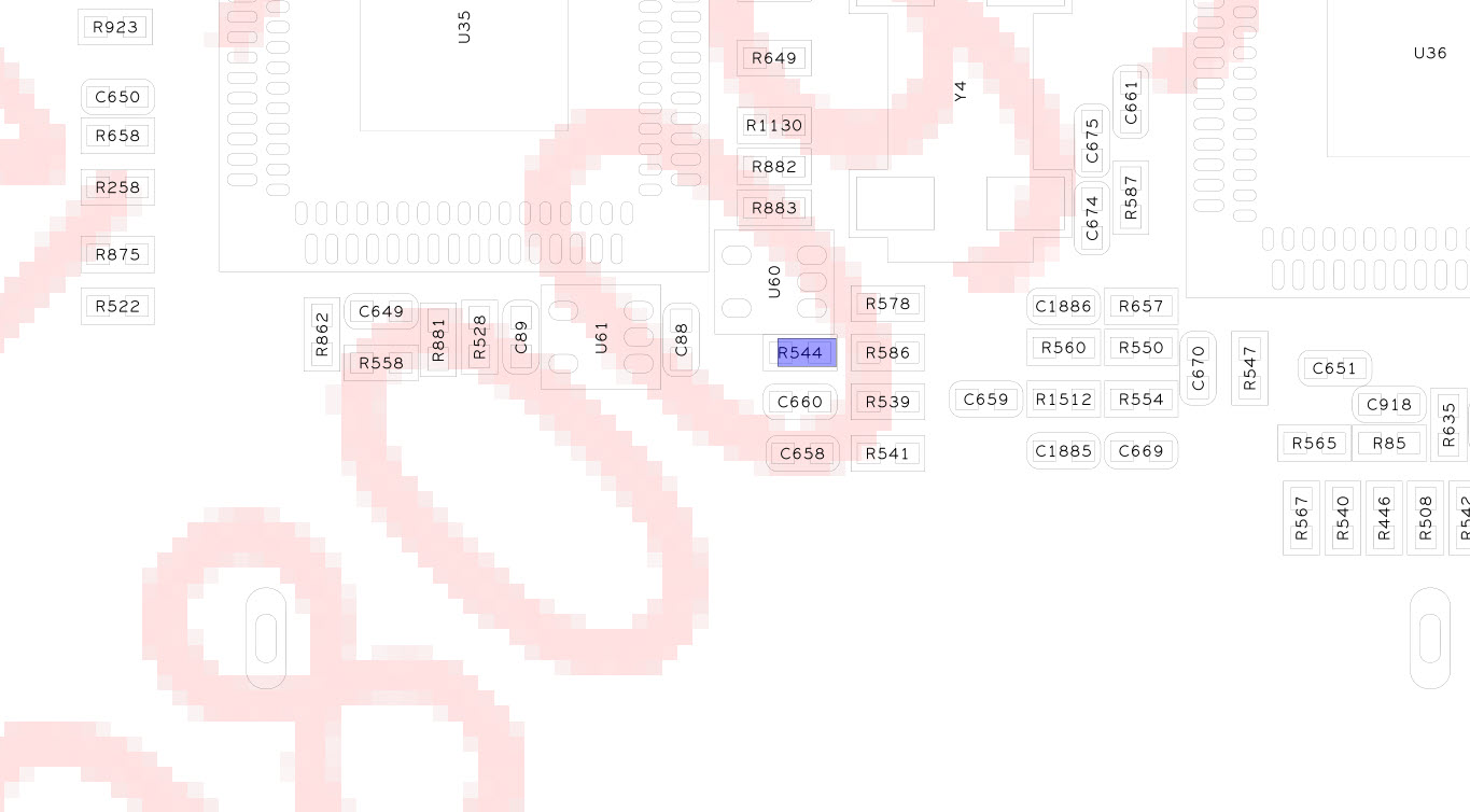

                  if there is a boardview i want to find r544
                  • mon2
                    • Dec 2019
                    • 14666
                    Re: dell E6410 no power
                    Attached. It is from a paid sub that is locked.
                      https://www.badcaps.net/forum/showthread.php?p=868883
                      Download from post #17 if you don't have allegro viewer brd file from piernov

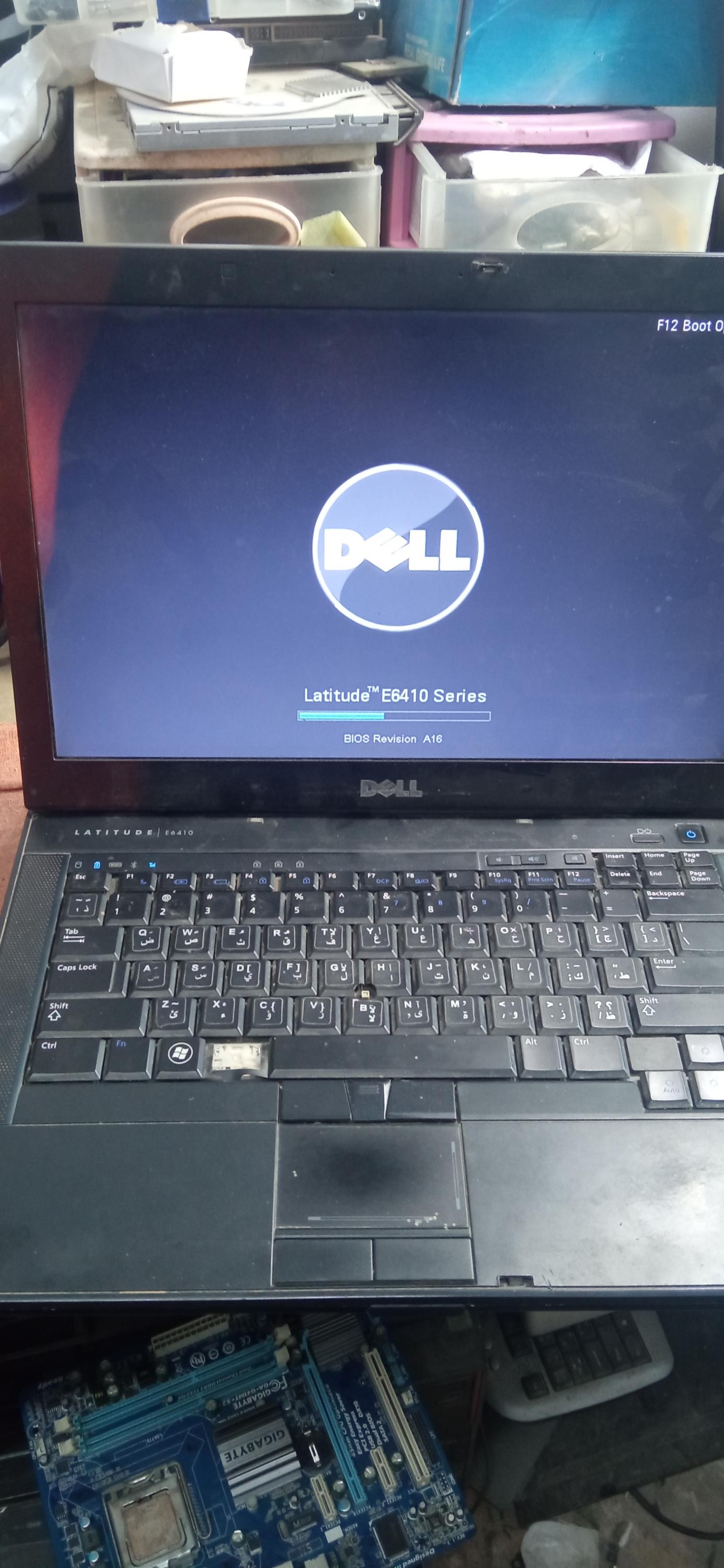

                        Done thank u bro
                        • mon2
                          • Dec 2019
                          • 14666
                          Excellent. What was the fix ?
