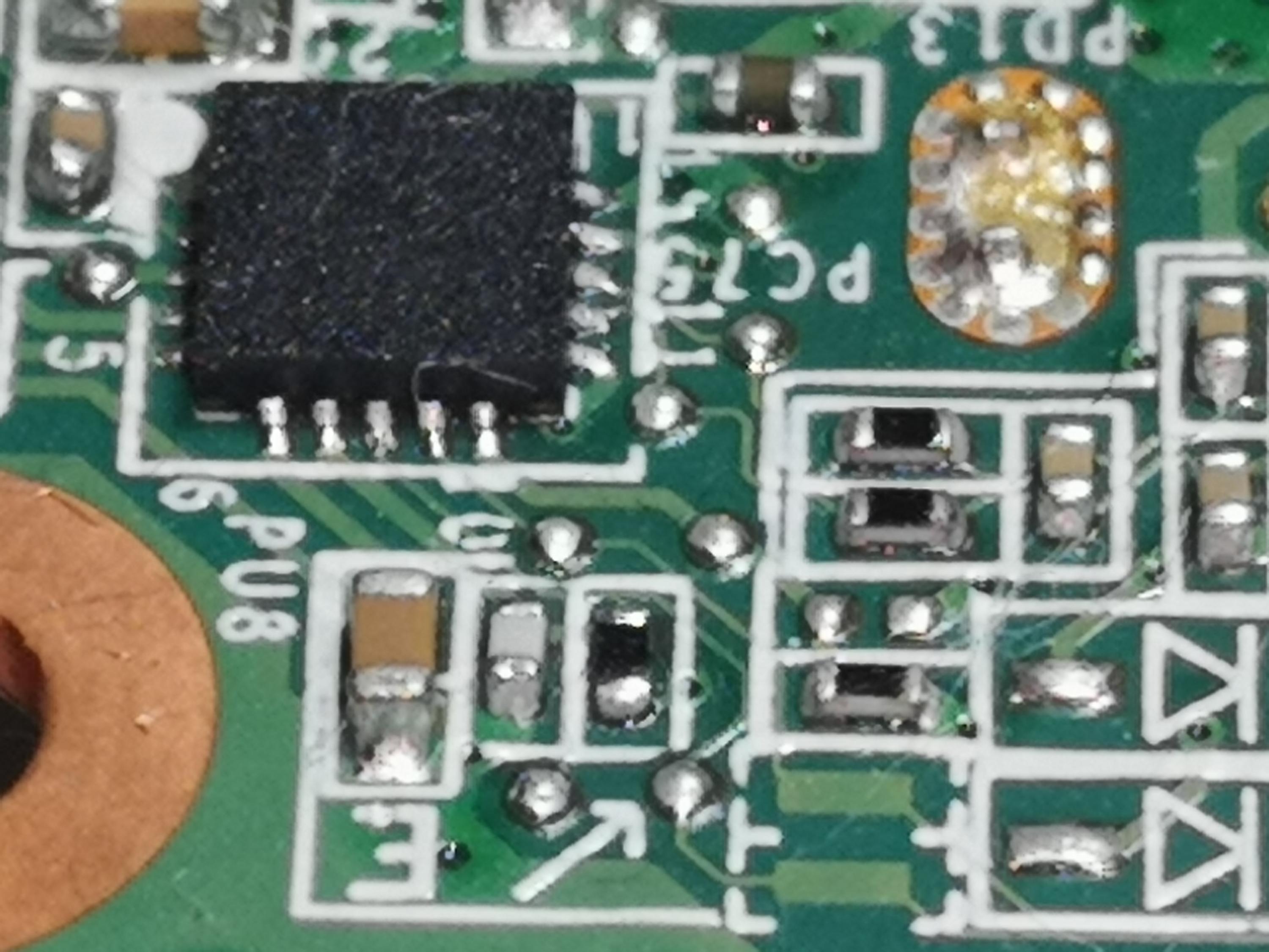

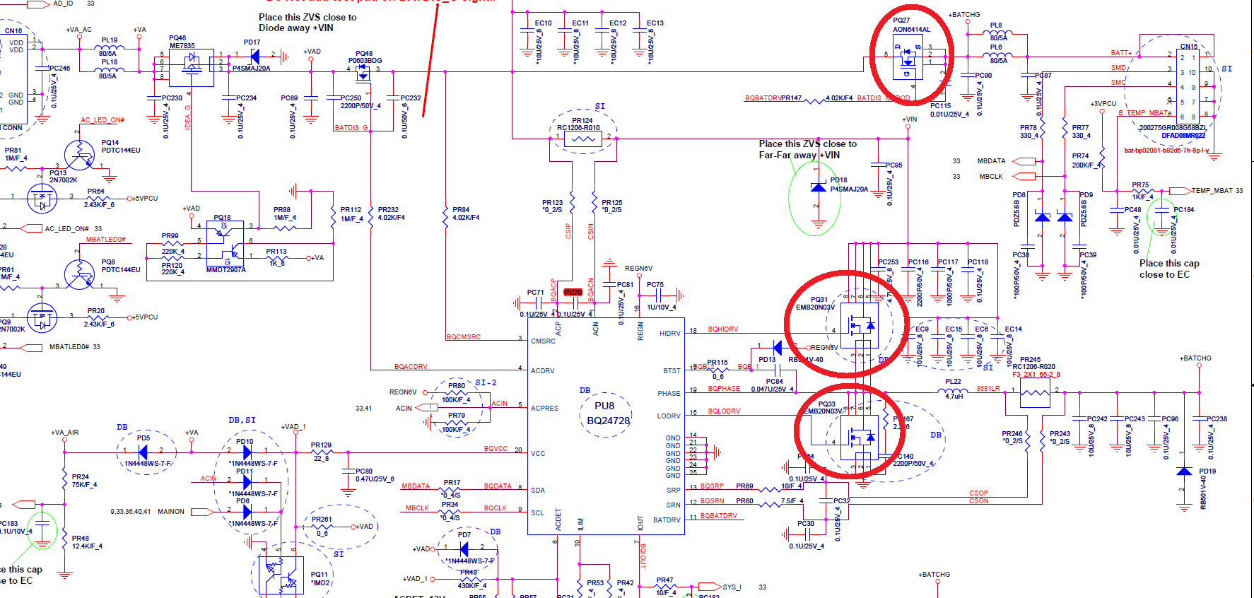

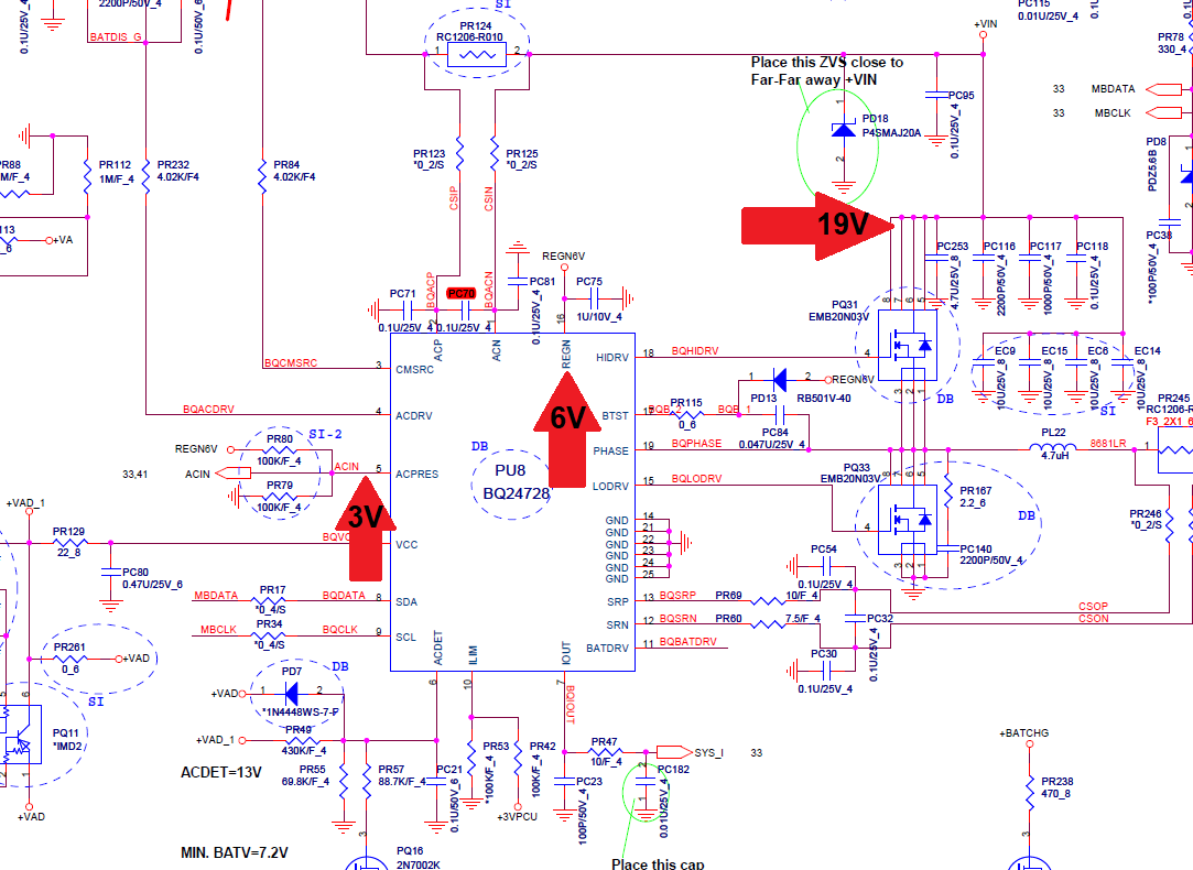

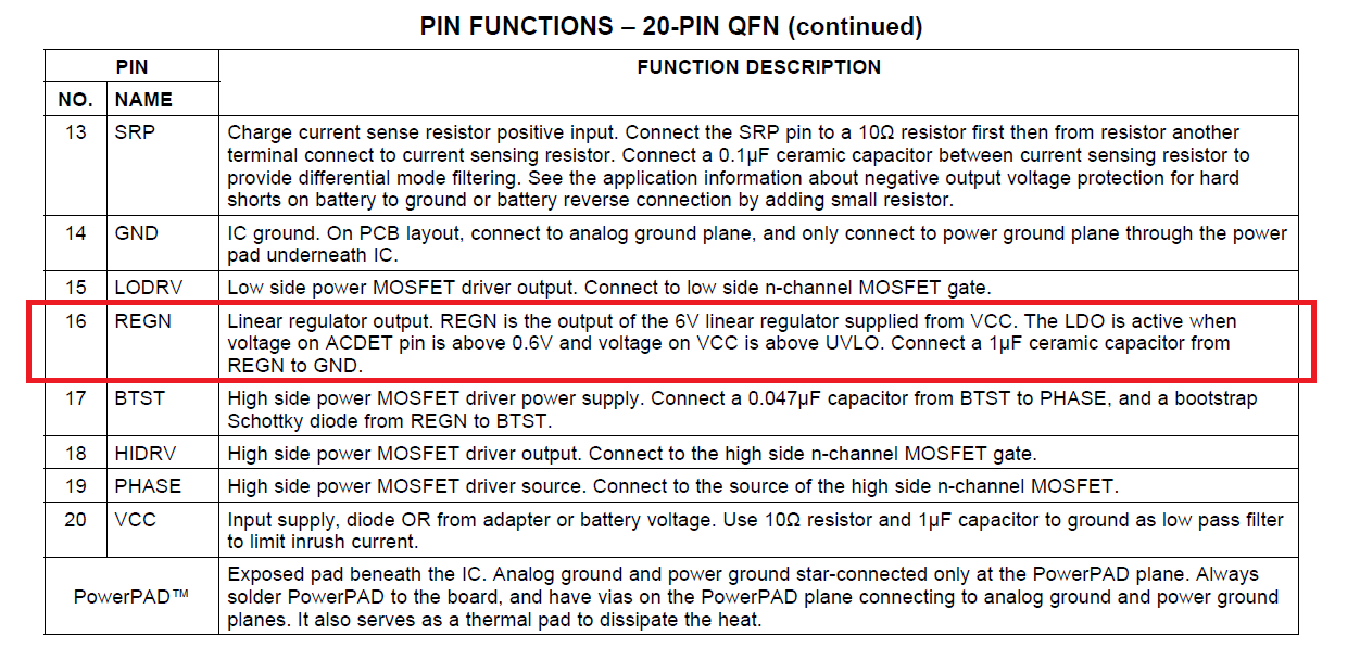

    Focus on PU8, the charger IC.
    What are the voltage readings for the following?
    +VIN
    ACIN
    REGN
    • Spongebob89
      • Mar 2021
      • 24
      • England
      Re: HP DA0R53MB6E0 S5_ON not present
      +VIN
      ACIN
      REGN
      I measured the below. Also, as I saw on the datasheet of PU8 (BQ24728) the voltages that I measured must be ok. Any else idea for what to look? Many thanks for your reply.
      +VIN = 19V
      ACIN = 3V
      REGN = 6V

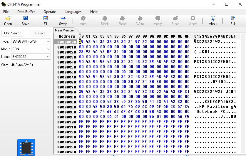

          I measured the below. Also, I re-flash the bios but nothing new happend... the same thing. Also, if I install a wrong version of bios the white light at the power connector don't shine. What else I have to look (this failure is mind blown). Thanks for your reply.
          AD_ID = 0,774V
          AD_TYPE = 0,766V

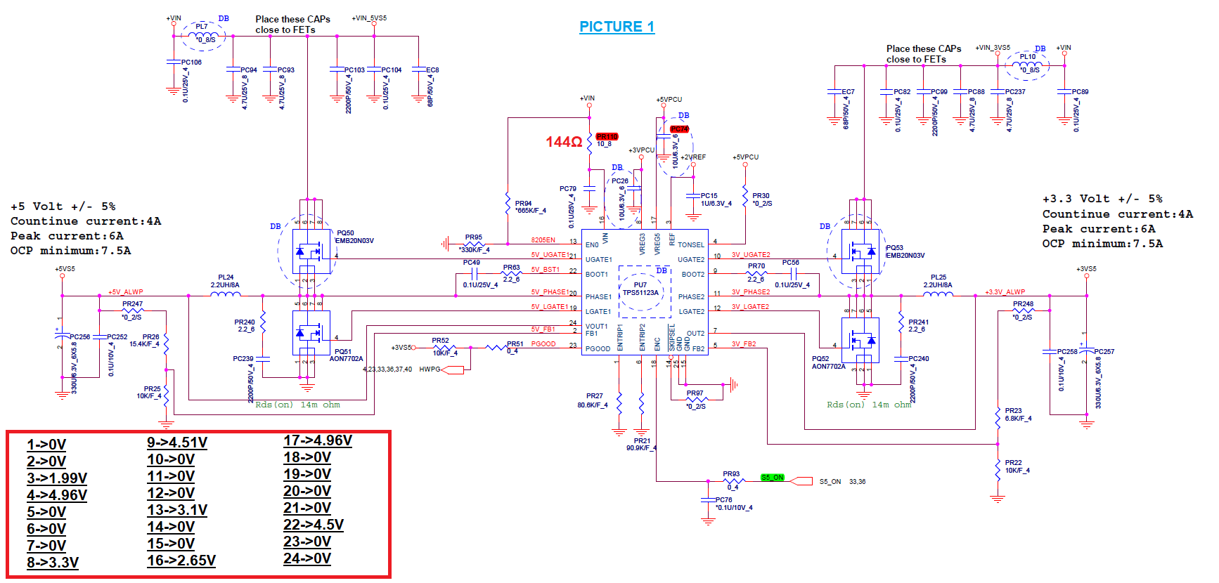

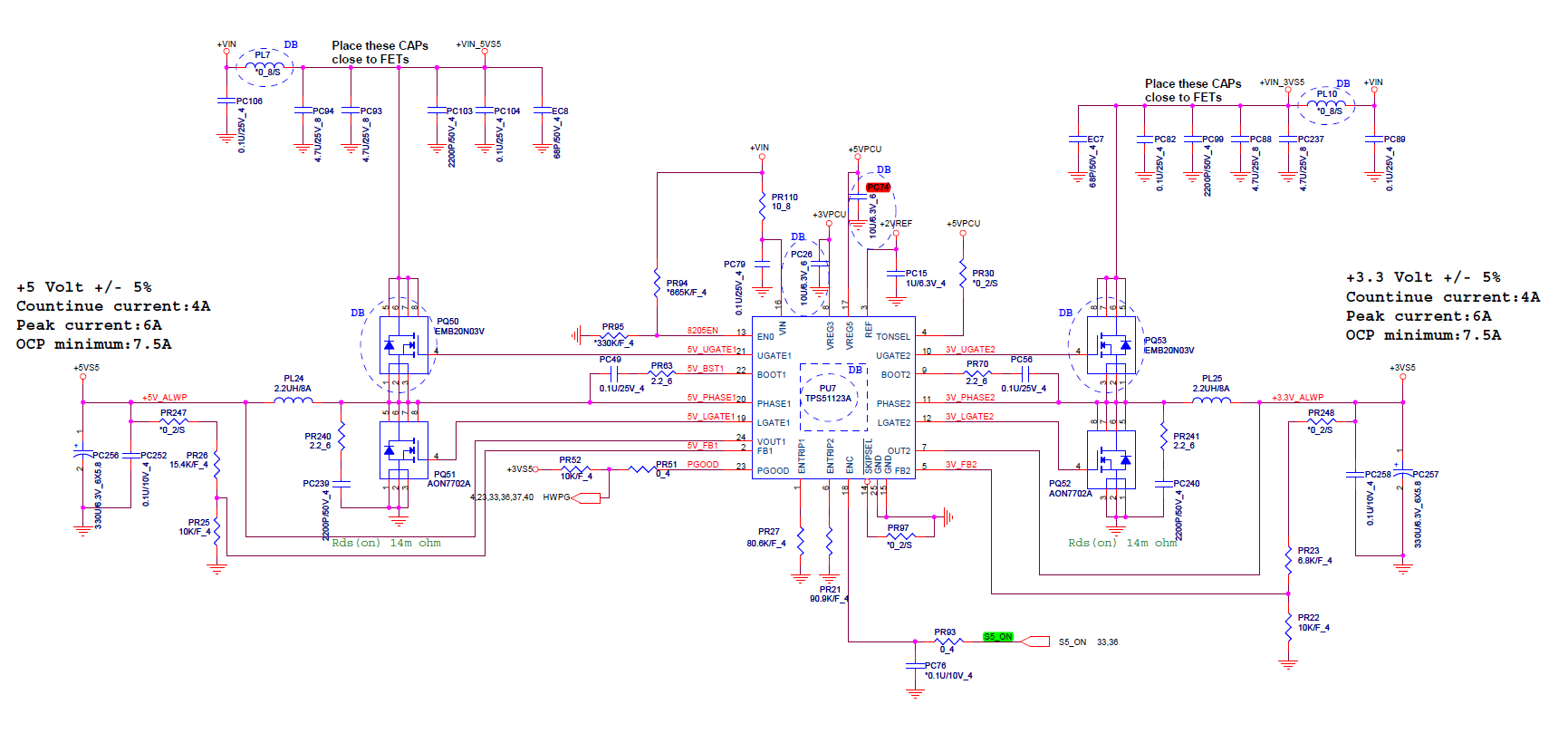

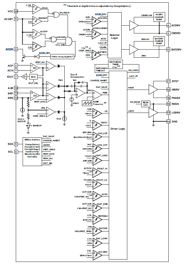

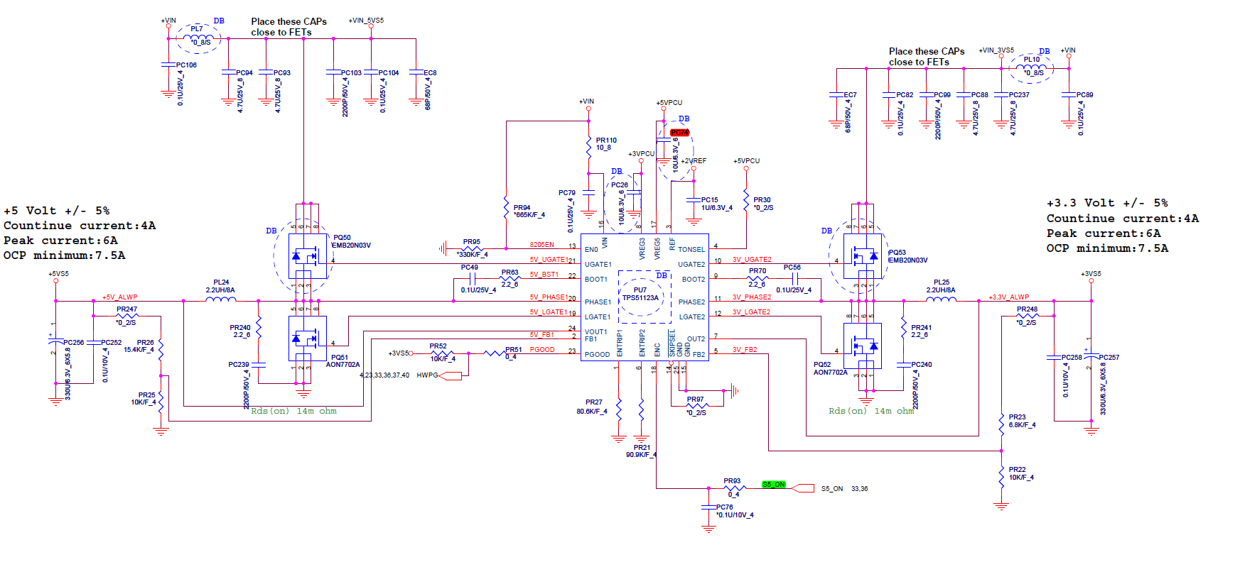

            Post a clear picture of TPS51123 area. The AD_ID seems fine.
            • Spongebob89
              • Mar 2021
              • 24
              • England
              At the attachements I have the full design of TPS51123.
              • mcplslg123
                • Jun 2015
                • 7262
                • india

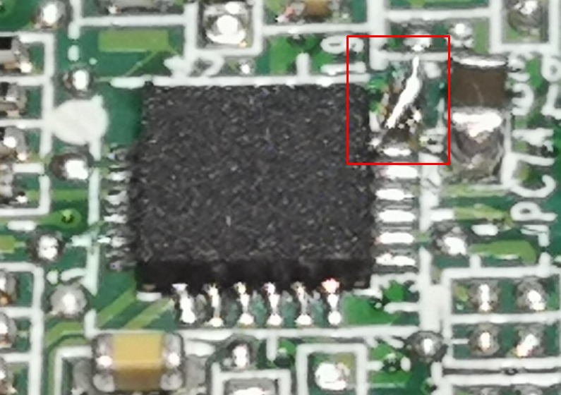

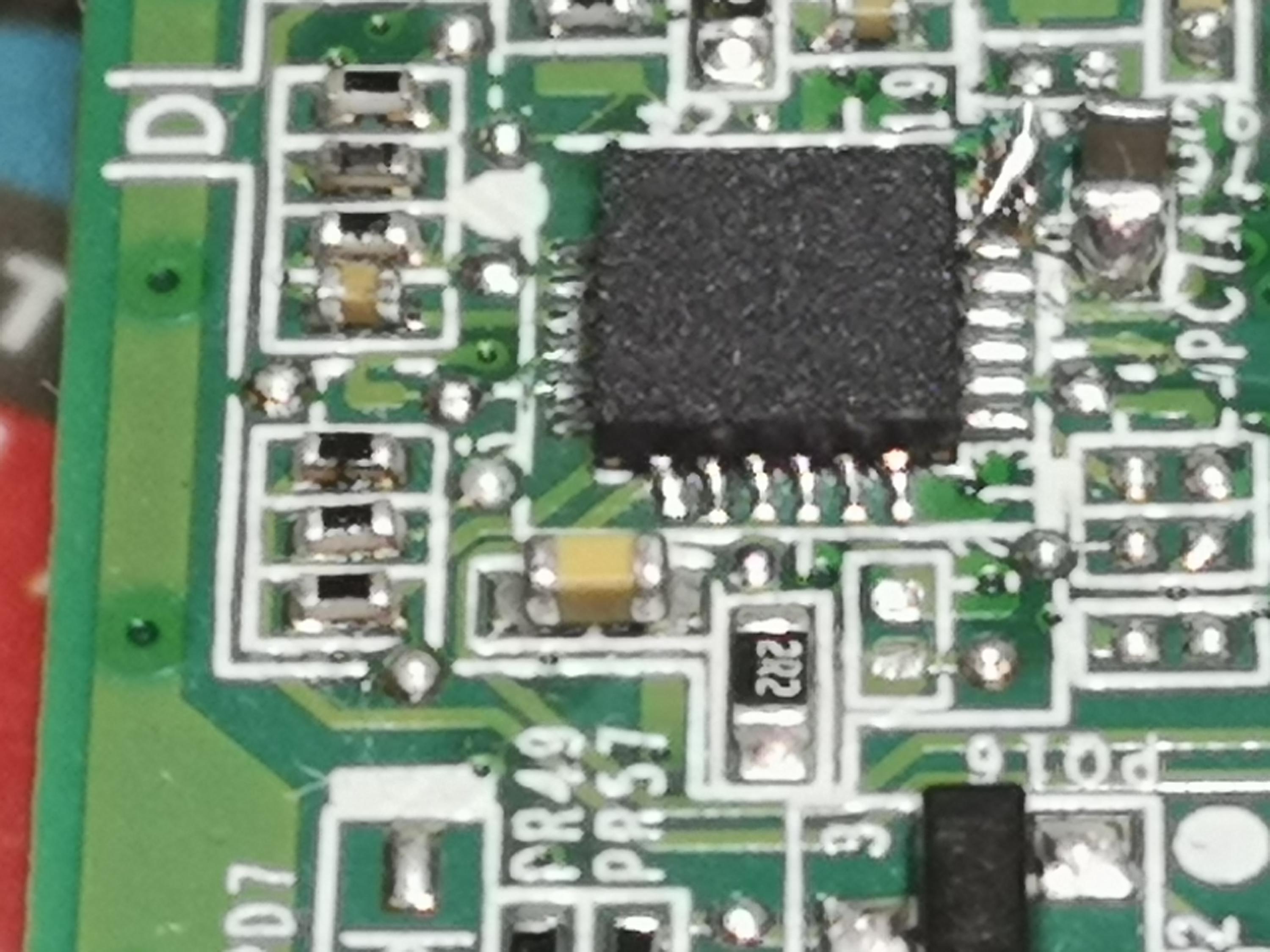

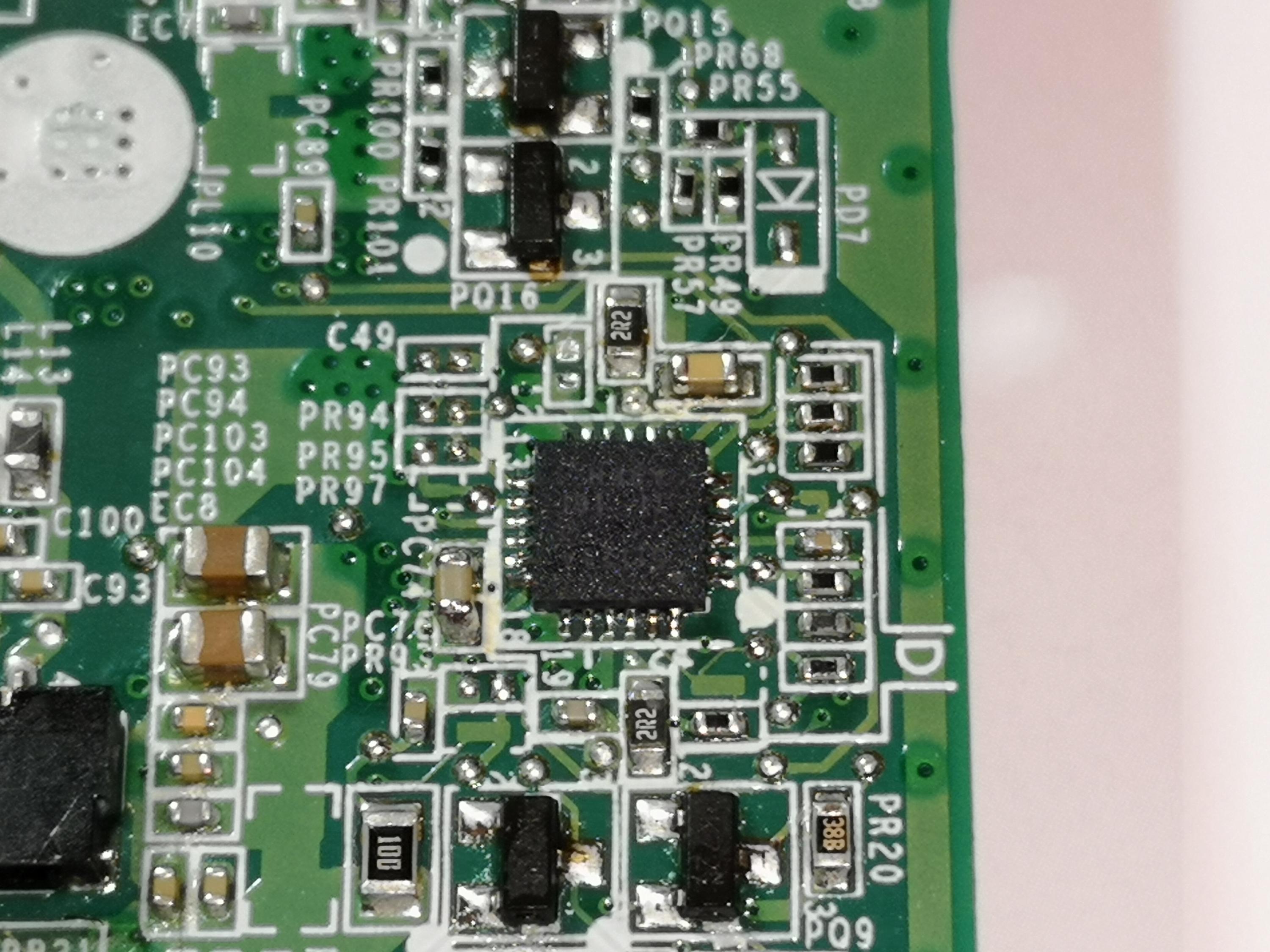

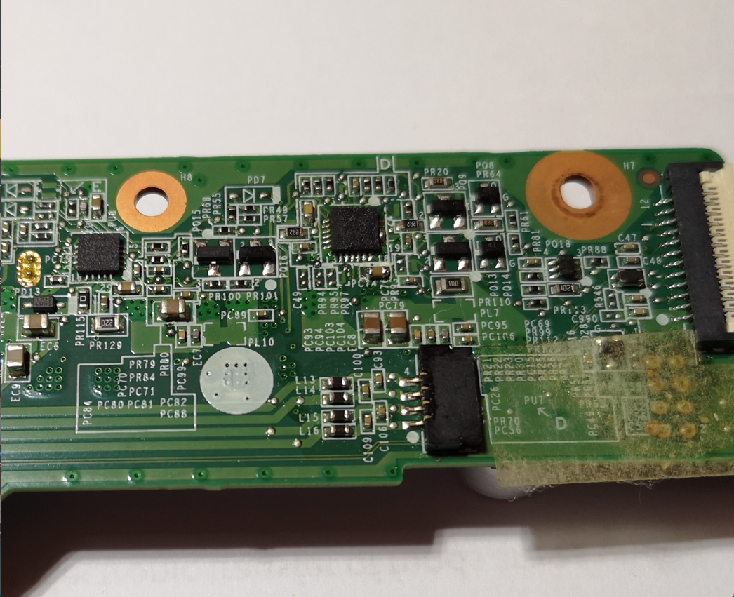

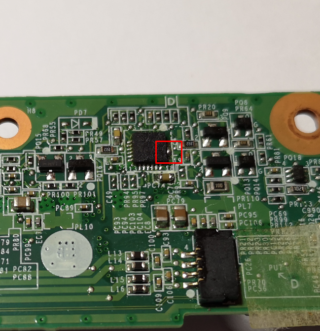

                I didnt asked for diagram of TPS51123 but a clear pic of the mb area.
                • Spongebob89
                  • Mar 2021
                  • 24
                  • England
                  I hope this will help.
                  • mcplslg123
                    • Jun 2015
                    • 7262
                    • india
                    The soldering seems to be poor . Apply bga flux and touch all the pins with solder iron first.
                    • Spongebob89
                      • Mar 2021
                      • 24
                      • England
                      I did it but not working again... This motherboard is going to crazy me.

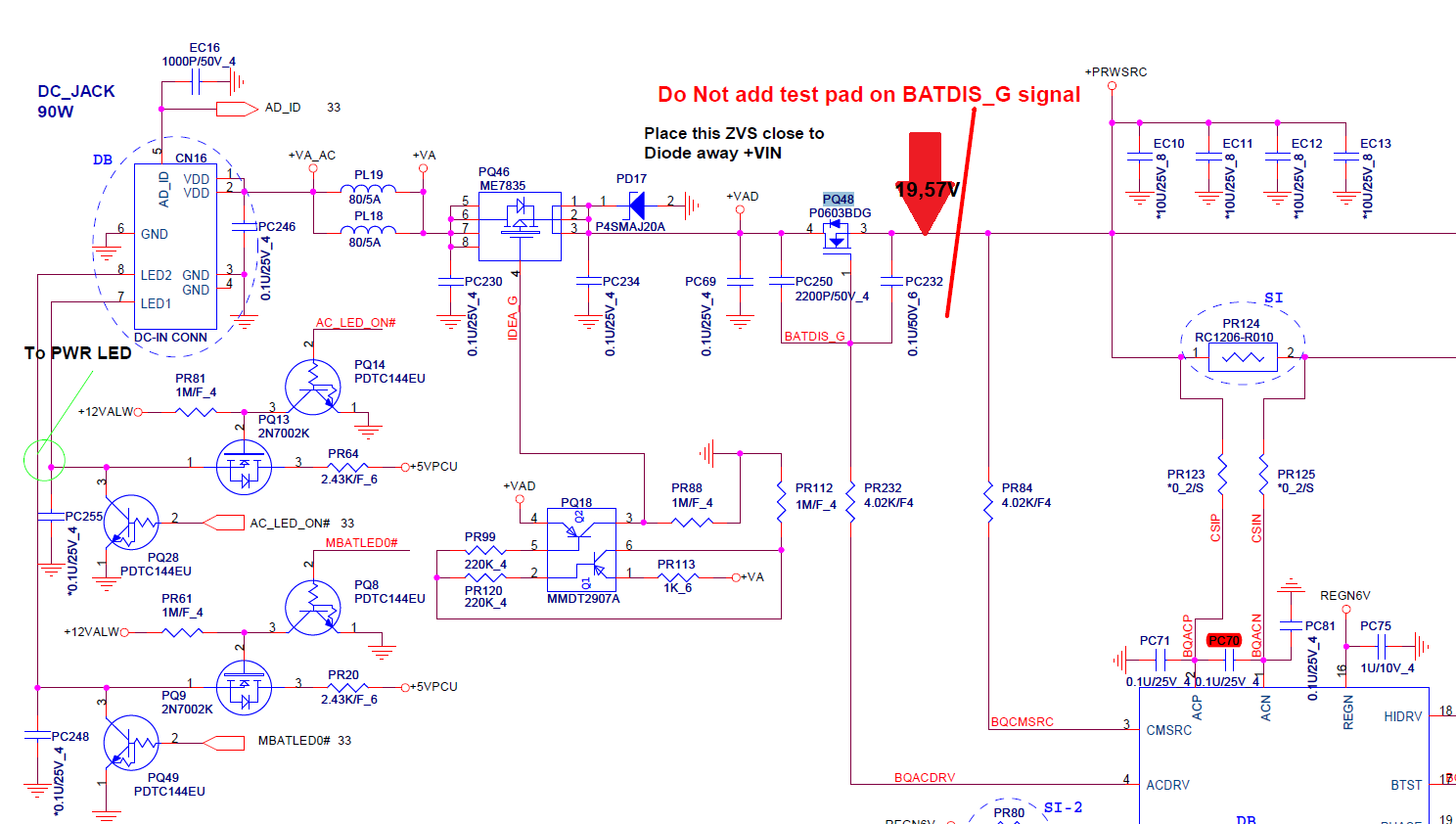

                        Have you confirmed that DC-in mosfets are not shorted / leaking (PQ46 & PQ48) ?
                        Remove all power. Meter in resistance mode.
                        Check the resistance across the mosfet pins
                        Source (1-2-3) & Drain (5-6-7-8)
                        Source (1-2-3) & gate (4)
                        gate (4) & Drain (5-6-7-8)
                        Post the resistance readings for each mosfet. Also include the meter scale used for the measurements.
                        • Spongebob89
                          • Mar 2021
                          • 24
                          • England
                          I measured the mosfets on the PCB (without desolder them)
                          Multimeter Fluke 28 II (Autoscale)
                          PQ46
                          Source (1-2-3) & Drain (5-6-7-8) ->Resistance: 336Kohm (Diode: 0,534V)
                          Source (1-2-3) & gate (4) ->Resistance: 1,29Mohm (Diode: O.L.)
                          gate (4) & Drain (5-6-7-8) ->Resistance: O.L. (Diode: O.L.)
                          PQ48
                          Source & Drain ->Resistance: 1,69Mohm (Diode: 0,464V)
                          Source & gate ->Resistance: 1,696Mohm (Diode: O.L.)
                          gate & Drain ->Resistance: 300Kohm (Diode: O.L.)
                          After PQ48 I have 19,57Volt, so these mosfets must be ok.
                          • mon2
                            • Dec 2019
                            • 14106
                            The voltage can be present if the mosfets are leaking or shorted.
                            The ~300k resistance readings are still a suspect for each mosfet.
                            Recommend to replace both of these mosfets.

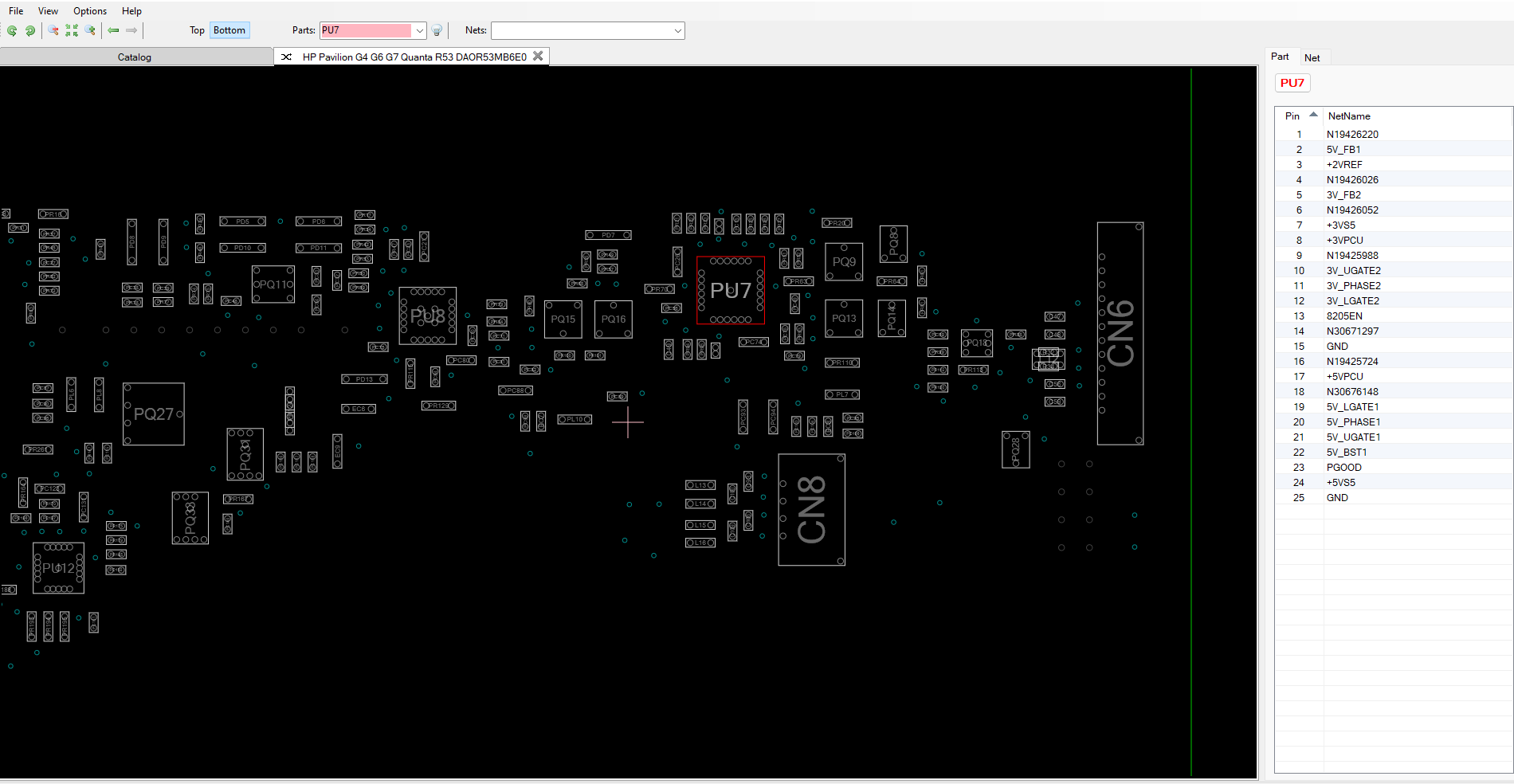

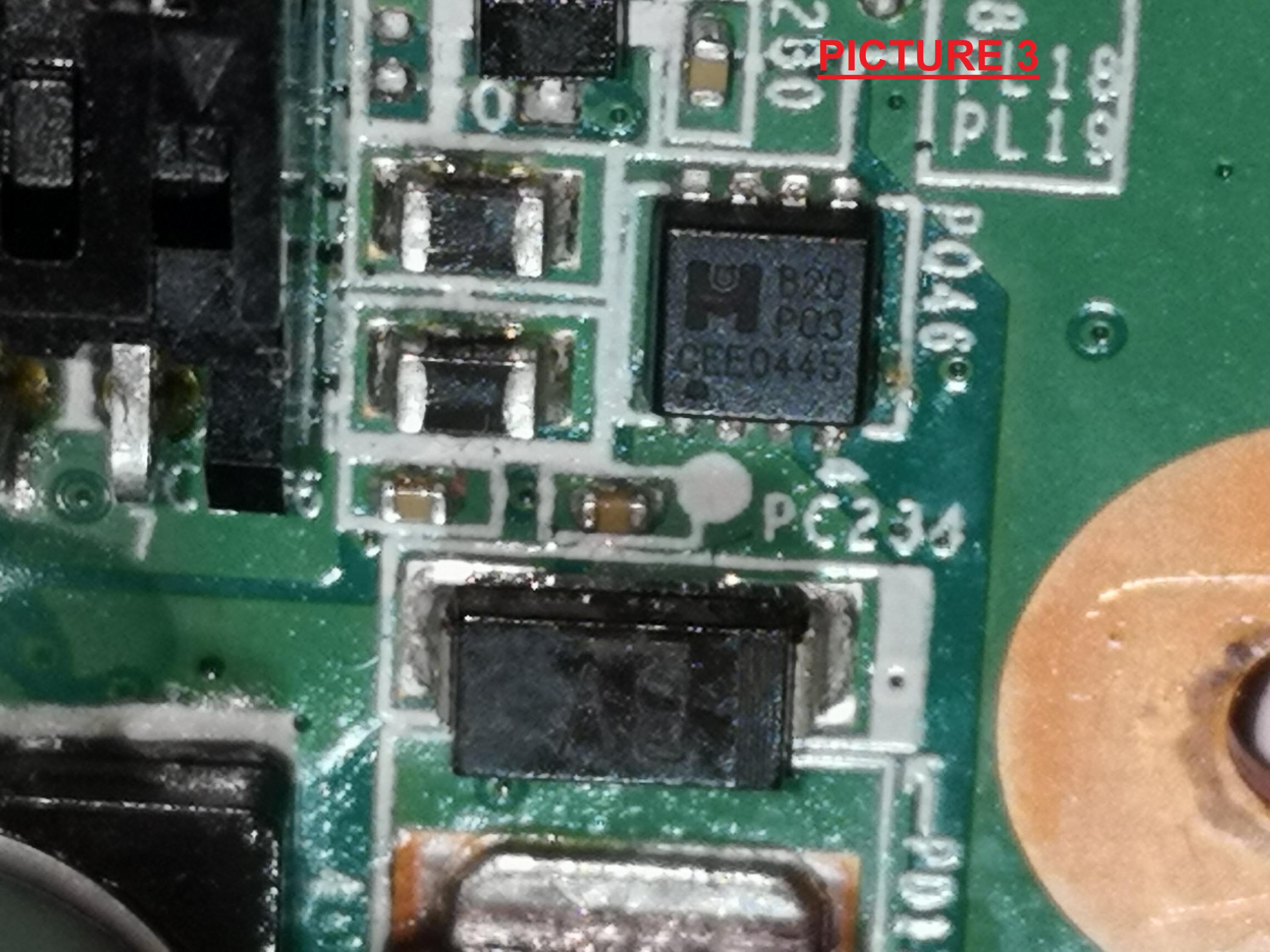

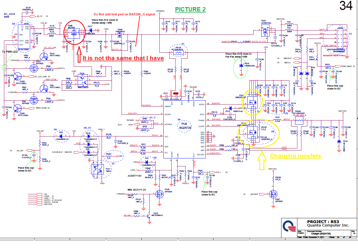

                              Hi, I after measurements of measurements I found that the value of the resistor “PR110” was 114ohm instead of 10ohm and I replaced it. After that I measured again the voltage across all the pins of “TPS51123A” (my measurements are at the attached image). About the mosfets I am not sure that are shorted because I inject voltage at the output capacitor of 5V & 3,3V and the current consumption was 110mA. I found the below mosfets on ebay.. except from the “ME7835” (this one that is on me motherboard are different – picture 2).
                              If I desolder the charging mosfets (PQ31 & PQ33) it will start the motherboard without them, so to make sure that this is the problem or no?
                              10pcs AO 77O2A AON77O2A 7702A AON7702A QFN8 IC Chip
                              https://www.ebay.com/itm/27397142832...wAAOSw3TldW-ip
                              10pcs 820 B2O 82O NO3 B20 N03 MTB20N03V8 B20N03 EMB20N03V DFN3x3-8 IC Chip
                              https://www.ebay.com/itm/40307641324...YAAOSwoKBfvm-S
                              1PCS Brand New BQ728 BQ24728 BQ24728RGRT BQ24728RGRR QFN IC Chip
                              https://www.ebay.com/itm/27484317257...gAAOSwVPZg0znG
                              10pcs M3O16D M30I6D M301GD M3016D QM3016D TO252 Transistor
                              https://www.ebay.com/itm/40167510818...sAAOSw-FRcJxY6
                              this is not like this I have on my motherboard (CEE0445) - Picture 3
                              ME7835
                              https://www.ebay.com/sch/i.html?_fro...E7835&_sacat=0

                                Proceed to check the resistance of the other mosfets linked to this IC = 1x battery mosfet; high side and low side mosfet used for charging.
                                Yes, every mosfet is a suspect.
                                Remove all power and measure the resistance across the pins of :
                                PQ27 = battery mosfet
                                PQ31 = high side charging mosfet
                                PQ33 = low side charging mosfet
                                Post each reading.
                                If you find that removing PQ31 / PQ33 allows for the laptop to turn on normally then the fault is with PQ31 / PQ33 area.
                                    Your soldering is very bad, apply more flux and use Amtech NC-559, even chinese copies from aliexpress work very good, at least for me.
                                    https://www.aliexpress.com/item/3286...23080556%21sea
                                    I don't provide help for people using CH341A and a clip.
                                    • Spongebob89
                                      • Mar 2021
                                      • 24
                                      • England
                                      These are old photos... I rework all the solder.
