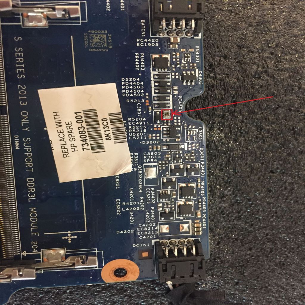

    Hi, I have the following problem with HP 450 G1
    When I turn on the charger, the element I showed (resistor 330) becomes very hot and hits light current when touched. The laptop does not turn on.
    I'm a beginner so I'm asking here if you can give an idea where to look for the problem
    Greetings

    Re: Problem with resistor HP 450 G1
    follow the trace, but i bet one of that diaodes is shorted
    remove resistor and i bet that one side have voltage and other side is shorted
