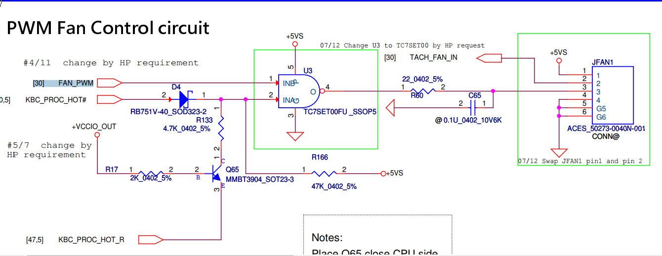

            What is the voltage of pin # 2 (TACH_FAN_IN) on JFAN1 connector when the fan is normal speed ?
            What is the voltage of this pin when the fan is in crazy spin mode ?
            The fan speed is decided by the SMC @ U17. This component sends out the stream (pin 121) of the PWM signal to speed up or slow down the fan.
            • RODAKSAN
              • Jun 2022
              • 17
              • Mexico
              Re: HP Zbook 15 G2 laptop won't turn off completely
              ACH_FAN_IN 3.3v, zbook turned on with no fan movement, it starts to spin seconds later
              ACH_FAN_IN 1.72v, in normal speed
              ACH_FAN_IN 1.72v, fan at full speed (zbook powered off)

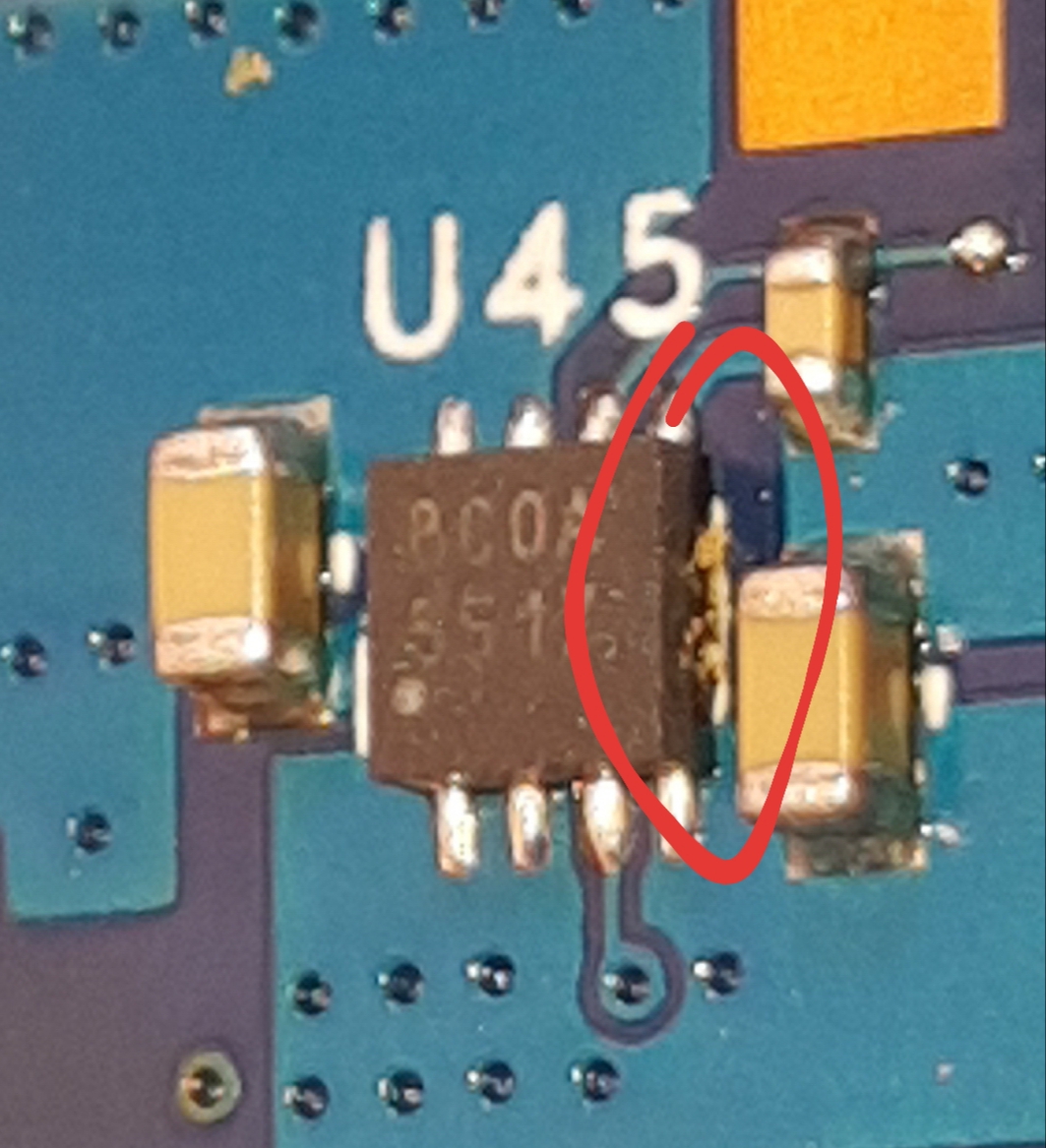

                  Thank you mcplslg123!! I found u45 burned, now I'm looking for a replacement. Once u45 replaced, I will post the result.

                    Success!! I replaced the U45, brand new part from china (take so long time to get here :p) but the laptop works again normally. Thank you all who helped me, specially to mcplslg123
