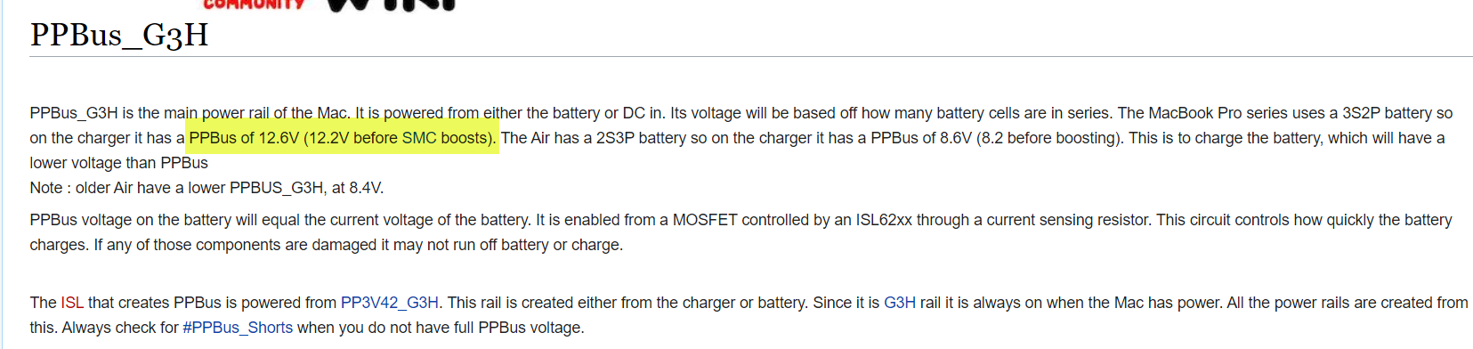

      • mon2
        • Dec 2019
        • 14342
        Re: MacbookPro A1398 (820-3332-A) auto-start on battery no initialization
        See here & attached:
        https://www.logi.wiki/index.php?title=PPBus_G3H
        So the SMC has not yet boosted this voltage.
        Could be a SMC communication fault...
        See attached.

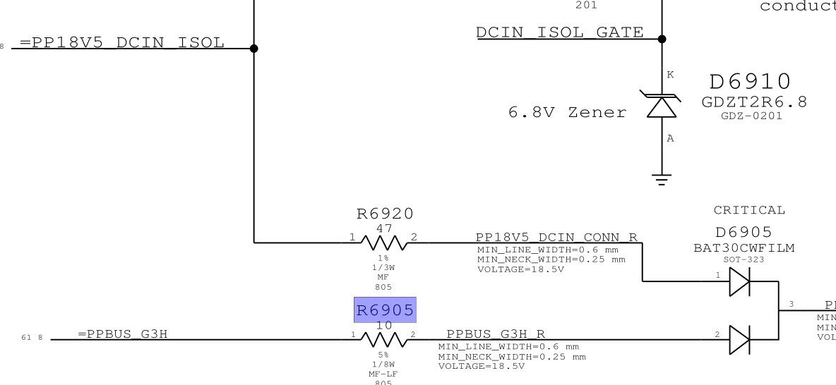

          • mon2
            • Dec 2019
            • 14342
            Are you testing with an original 85W magsafe 2 power adapter ?
            Follow this thread and continue to post your updates:
            https://boards.rossmanngroup.com/threads/a1398.62533/

              • mon2
                • Dec 2019
                • 14342
                Q1: Are you testing with an original 85W magsafe 2 power adapter ?
                Q2 : What is the voltage of PM_BATLOW_L ?
                PPBUS_G3H on R6905 15.14v
                Seems high. What is the voltage again @ F7040 ?
                Maybe you are measuring the voltage on R6920 ?
                  sorry didn't have time. yes, before that I used a 45 watt adapter and when connected it was orange, today I found 85 watts and when connected there was an orange indicator, then after reconnecting it does not light up. Now ADAPTER_SENSE 12.2 ,PM_BATLOW_L 0v
                  R6905 PPBUS_G3H 12.2
                  • mon2
                    • Dec 2019
                    • 14342
                    From Rossmann forums:
                    BATLOW is often missing because of bad/incorrect charger....
                    See attached.
                    reference:
                    https://www.it-tech.com.au/mac-q-a/pm-slp-s4-l-timing/
                    PPBUS_G3H 12.2
                    This means the SMC has not properly boosted the PPBUS_G3H regulator @ U7000.
                    Check the voltage of:
                    SMBUS_CHGR_SCL
                    SMBUS_CHGR_SDA
                    Post the measurements.
