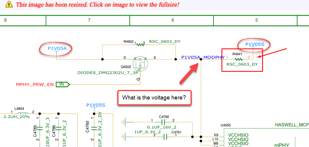

    I have a motherboard 6050A2560201 MB A03 which is missing one component, which is as shown in the picture below
    then I tried to look for references on the internet and got some information, that apparently the missing component is as shown in the image below
    and the information I got from the schematic is that the missing component is a resistor as shown in the picture below
    but this information is still not enough for me, please help to determine what components are missing and what are the specs like? how many ohms? what type? I'm looking for a replacement
    Thank you for the help

      Hi. It should be fine to just short the location with a solder blob.
      From my understanding you have 2 rails that can power the VCCIO.
      One rail will be active when the logic board is awake = main power rail.
      If the logic board is in sleep mode, the main power rail will disable and the always on, lower current rail will be switched to power the VCCIO pins.
      The VCCIO pins need to be present to perhaps power devices like a mouse -> when the mouse is moved, the logic board can then wake up again.

        ok, i will try to connect it now

          thanks a lot bro, you saved my life, your advice really works
