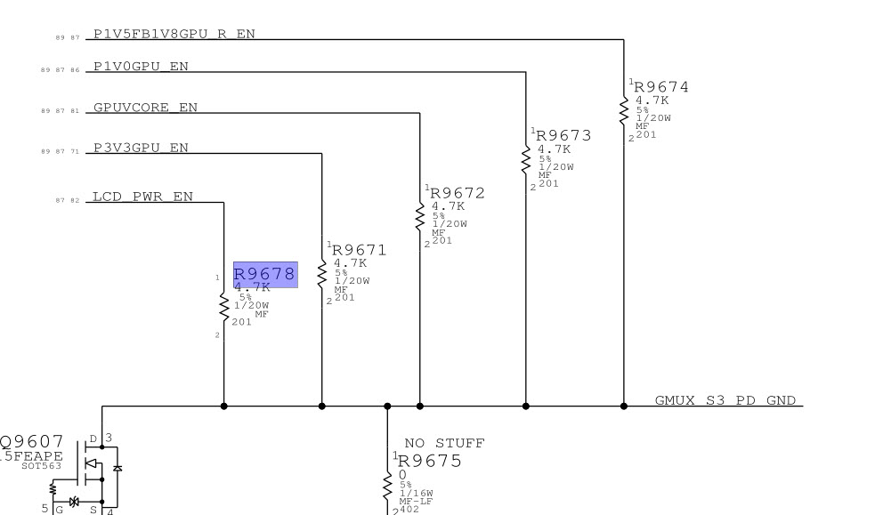

    Hello
    I have this a1286 with minor water damage, after cleaned ISL area turns on and chimes , load os but: no image no backlight.... LCD_PWR_EN is 0vol ..
    I have done gmux bypass to many a1286s with gpu issues, so though this would be the case. routed jumpers to avoid the gpu and removed resistor r8911 as usual to disable ati gpu... but still no LCD_PWR_EN signal...
    what can be going on to not have LCD_PWR_EN enabled? i do have 3.3v in pin 4 at lcd connector but not pins 2,3, because u9000 is not enabled by this missing LCD_PWR_EN
    thanks in advance
    pd i did not remove gmuch chi only bypassed in site like this img:

    What is the voltage of R9678, pin # 1 ?
    • marce002
      • May 2018
      • 316
      • Argentine
      Re: A1286 820-2915b chime ok, but no image no bklight
      Hi mon it is 8.2mV at #1 and 2.66V at #2.. resistor is in range

        Check the resistance to ground of LCD_PWR_EN pin. Any liquid damage in this area ? Trace is ok from source (U9600) to target ?
        • marce002
          • May 2018
          • 316
          • Argentine
          it is 8.2kohm and traces are ok there around...
          remember that i have a mod jumper from #1 of r9678 (lcd_pwr_en) to R2015 pin 1 (lvds_ig_panel_pwr)

            R2015 is the source for my lcd_pwr_en after my mod.... is it? .. which in fact should be 100kohm and i have it at around 8kohm... mmm
                  nop no image no backlight but do have brain ...replaced that resistor and after soldered in it is 8kohm so in circuit resistor parallel afects messurement.
                        fixed it was bad corrupted efi bios so if you have chime but lcd pwr on signal not enabled might NOT be a bad pch or bad connector screen or coils around... thks mon
