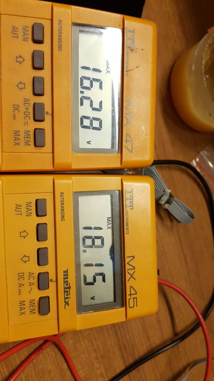

          1) Regn seems stable at 6v (5,95v) with dc adapter connected. 0v on battery.
          2) No corrosion/water damage.
          3) Each trace and current sense seems to reach the charger ic.
          4) Not always the dc passes the 2nd fet. But in both cases the initial situation is the same. I get about 1v between PQ1 and PQ9054 slowly increasing to about 3v, then:
          option 1: the voltage rises rapidly to 12-15v and B+=12-15v, ACOK goes low.
          option 2: the voltage decreasing slowly to 0v and B+=0v, ACOK goes low.
          5) All measurements result in > 1.5Mohm except for source-drain of pq29 that is 200Kohm slowly increasing to 350Kohm. All fet closes correctly to 0ohm if tested with 2 testers in diode/beep mode.

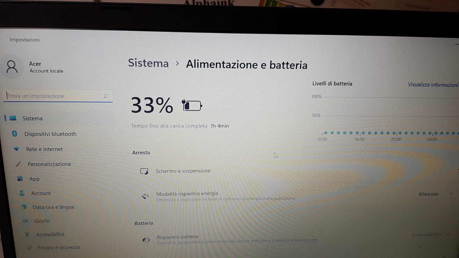

                the new bq24780s from mon2's chinese seller has solved the problem.
                while connecting cd jack:
                ACDRV 0->~5v->25,5v
                CMSRC 0->~7v->19,5v
                ACOK 0->3,1v->3,1v
                then stable:
                ACDRV 25,5v
                ACOK 3,1v
                battery is charging, nothing is heating, no strange noises, 1.2-2.5A current draw with windows started and battery charging.
                thanks to all users those who helped me in the repair and (especially) in understanding the operation of these chargers. it will be very useful for next time.
