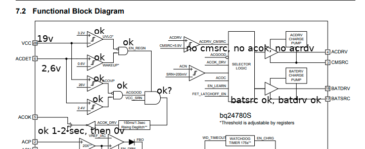

          Some updates:
          1) The ACIN pin in the ITE chip is probably programmable as input/output, when the EC is powered on i read 2,8v, so the chip should be ok.
          2) There isn't any mechanical problem (i think). I tried folding, heating or cooling and nothing changed.
          3) When the dc voltage is less than 17v (acdet < 2,4v) the ACOK is floating and is not pulled low. increasing input voltage, after about half a second that acdet > 2.4v, the acok pin goes low.
          In this time sometimes there is an instant where there is 2-4v after the 2 mosfets pq1 and pq9054. then it returns slowly to 0v (probably for capacitor discharge).
          At this point i believe there are 3 options:
          -a) the 24780s chip is fake, it doesn't work, the chinese programmer who engineered it was drunk
          -b) the 24780s chip must be programmed using smbus or internal registers as mentioned in the datasheet
          -c) there is a problem with some component in the charging circuit and the 24780s goes into protection immediately (paragraph "7.3.9 Device Protections Features" of the manual)

                        Re: Acer A315-55G / DA0ZAWMB8E0 not charging
                        When DC IN is < 17v, what is the voltage on ACOK ?
                        That is, does the charger enable the 6 volt LDO REGN and allow for ACOK to be ~3v (due to the resistor based voltage divider on ACOK leg for about 50% of REGN voltage) ?
                        • vannix
                          • Mar 2018
                          • 74
                          • Italy
                          #32
                          ACOK is floating when DC IN is < 17, and 6v REGN is present. So, if i reconnect the cutted trace from pin 5 ACOK to the voltage divider (and the ACIN in the EC) i read about 0.7v. This value is only if the EC is not powered. When the EC is powered i read about 2.9v in ACIN/ACOK.
                          If the DC IN increase to 18 or 19v (>17v) the ACDET is > 2,4v and the ACOK is pulled down from the 24780s after some msec.
                          I need to completely remove the power to get ACOK floating again. Decreasing the DCIN doesn't do the trick.
                                a few days ago i casually read this post on the forum: https://www.badcaps.net/forum/showpo...81&postcount=6
                                so i tried to connect a 4k resistor from 19v to CMSRC (pin3). in this way ACDRV remains active (but is 19v instead of 25) and ACOK is 3.3v for about 2 seconds, then it returns 0v.
                                could the problem be around PC1 and PC2? I tried to replace them with the same value but nothing has changed.. maybe you or someone experienced with 24780 know some tricks

                                  I still don't understand how the ACDRV works. more precisely i don't understand how/when the bq24780 decides when to activate the first mosfet..
                                  Is it opened by the bq24780 after the CMSRC is present or is it opened by the bq24780 when VCC is present and (only after this) the bq24780 check if the voltage passes from the mosfet through the CMSRC??
                                  This would be crucial to understand why the fet is not closed correctly. Can any expert explain this to me?
                                    TBH - found the same issue to be a puzzle - which comes first ?? The chicken or the egg ? The TI documentation is written in a format that only twins can understand.
                                    The following thread is a must read - the 3rd from bottom reply from wang5577 explains it well:
                                    https://e2e.ti.com/support/power-man...-don-t-turn-on
                                          Thank you for your reply and for sharing this link. I read lots of thread in TI's forum, but not this. The situation is similar, and also in my board i can enable ACDRV only if inject 19v on CMSRC.
                                          Probably in my board the bq24780 realizes that something is not correct, so it sets ACOK to 0v and removes +6v of the regn from the ACDRV (probably can't bring ACDRV to 0v if CMSRC remains active), so this brings about 16v in the B+ rail, and without ACOK the battery is not charged.
                                          I believe that in the circuit of Martin Andersson70 (of your link) the problem comes instead from the too low voltage which leads the 24780 to suspect an excessive absorption / short circuit.
                                          After its modification, ACDRV remains active, but note that a higher voltage is supplied to CMSRC than the input voltage of the N5800 mosfet, therefore the mosfet could be fully close even without +6v of the REGN and probably the bq24780 realizes that there was no short circuit / excessive current draw since after the fet there is the right voltage without any delay.
                                          The solution of my problem is probably in the "SELECTOR LOGIC" indicated in the attached image (taken from the datasheet). Without knowing its operating logic it's difficult to understand where is the problem, since all the components look good and/or have been already replaced.
                                          Unfortunately i'm not an expert on these ICs. An attempt could be to cheat the current draw control, but.. how??
                                          AFAIK,ACDET must be in range, CMSRC must be 19V along with LDO being present are the 3 pre-requisite for ACDRV to work on BQ24780S.
                                          Thank you too for your reply. All requirements are present, but without ACOK there will be no ACDRV. Without ACDRV there will be no CMSRC. Without CMSRC there will be no ACDRV. Without ACDRV there will be no ACOK, and so on..
                                          A IT engineer is required to explain us the operating logic of BQ battery chargers
