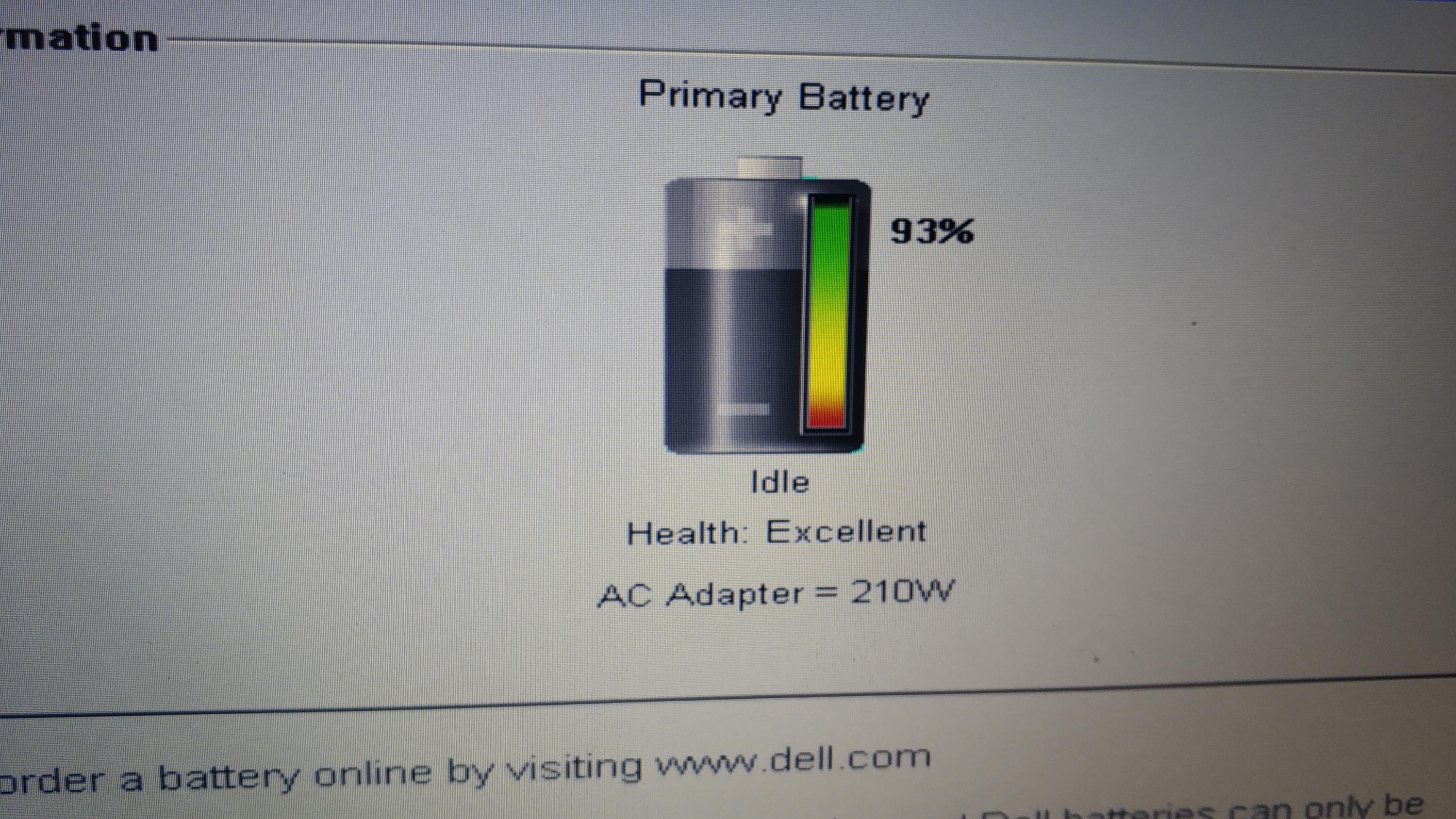

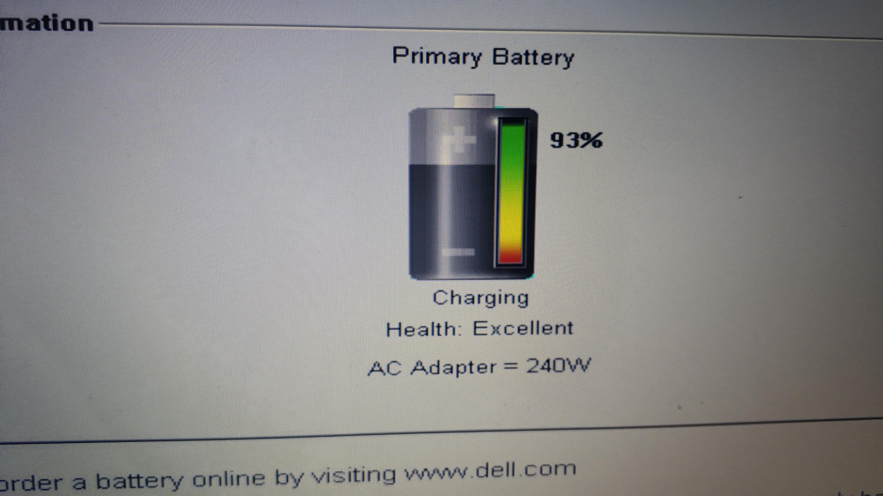

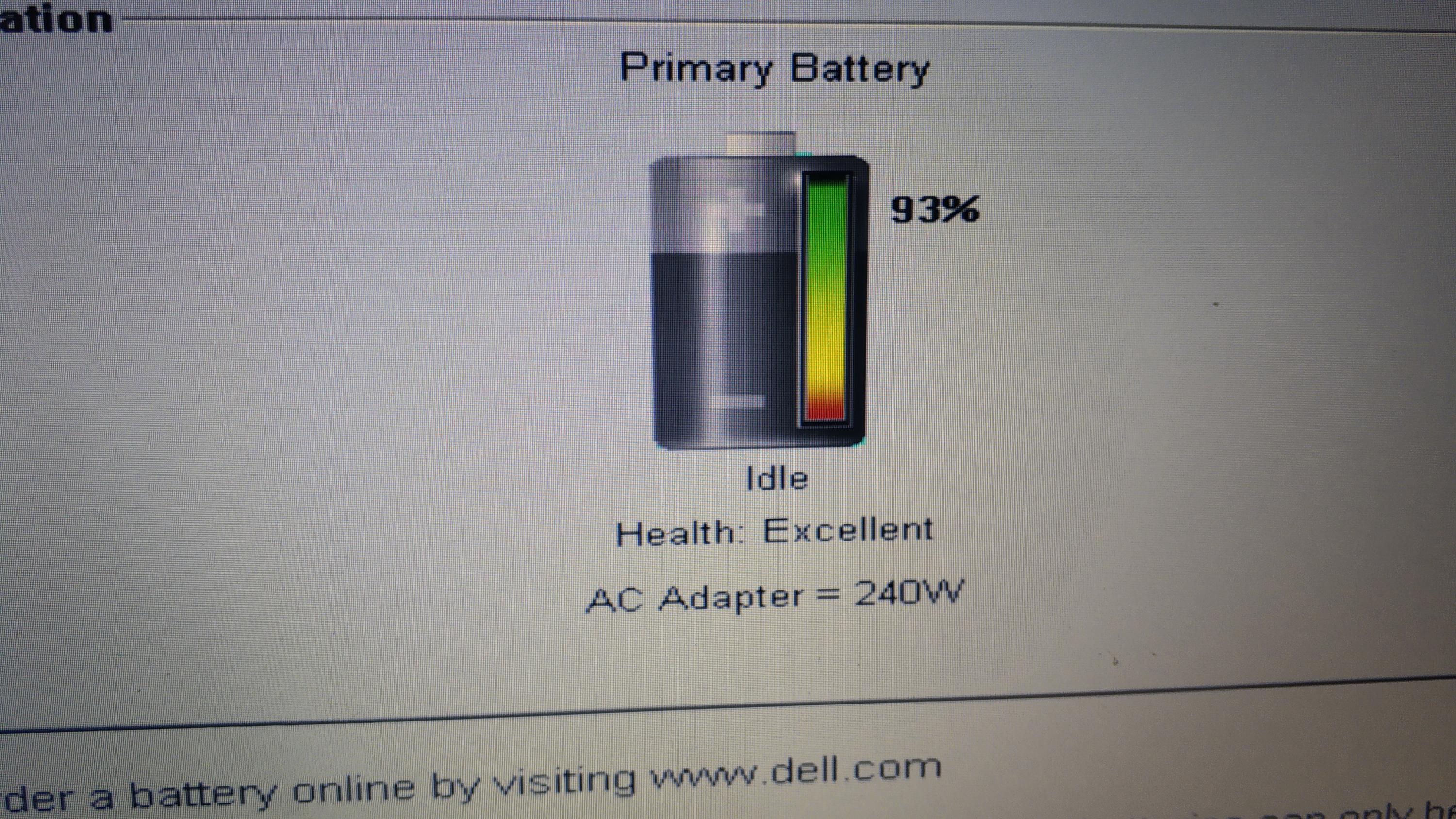

    Hi guys,
    I'm having now a final issue,
    The laptop can starts on battery or with AC, the both are properly detected, AC 240w and the battery health excellent.
    I can run starting on Battery, normal drain and use, plugged the AC, laptop continues working but not charges it, and if you remove the AC laptop shuts down like battery was not present.
    Also noted, with the battery attached, the battery light blinks each 2 seconds, like trying to charge, every time the battery light goes of, at bios the AC adaptor changes 1 second to 210w adapter and 240w again. Tested with other 240w AC charger and same.
    HWinfo reports a charge current of only 11mw, clearly insufficient
    Without the battery, with the laptop plugged, the battery light blinks 1 white 4 orange, cicling 3 times or 4 and after that orange blinking continously like a problem in the charge circuit.
    Any one could point any clue about what to check?

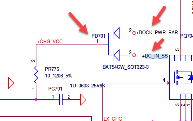

      Re: Help with Dell board LA-9872P blinking not charging and power off removing AC ada
      See attached.
      Review the voltage on each of these pins of PD701 when:
      1) powered through the external power adapter only
      2) powered by the docking station only
        Hello these are:
        PD701
        Pin 3 power External 19.48v P2 0,09v P1 19,19v
        Pin 2 power Dock 19,48v P3 0,05v P1 19,20v
        Seems that both lines are ok, not?
          Ok. Review page 62 of your posted schematic.
          There are 4 mosfets in the top left side of this page.
          With the dock station, the power rail to the logic board bypasses this group of 4 mosfets.
          Remove all power. No battery. Meter in resistance mode (2k is ok).
          Check the resistance of each mosfet of these 4 :
          Source (1-2-3) and drain (5-6-7-8)
          Source (1-2-3) and gate(4)
          Gate (4) and drain (5-6-7-8)
          Post each measurement and the meter scale used. Checking for a low resistance = defective mosfet. If you see '1' and 'OL' then switch to the next higher resistance scale on the meter to measure it.
