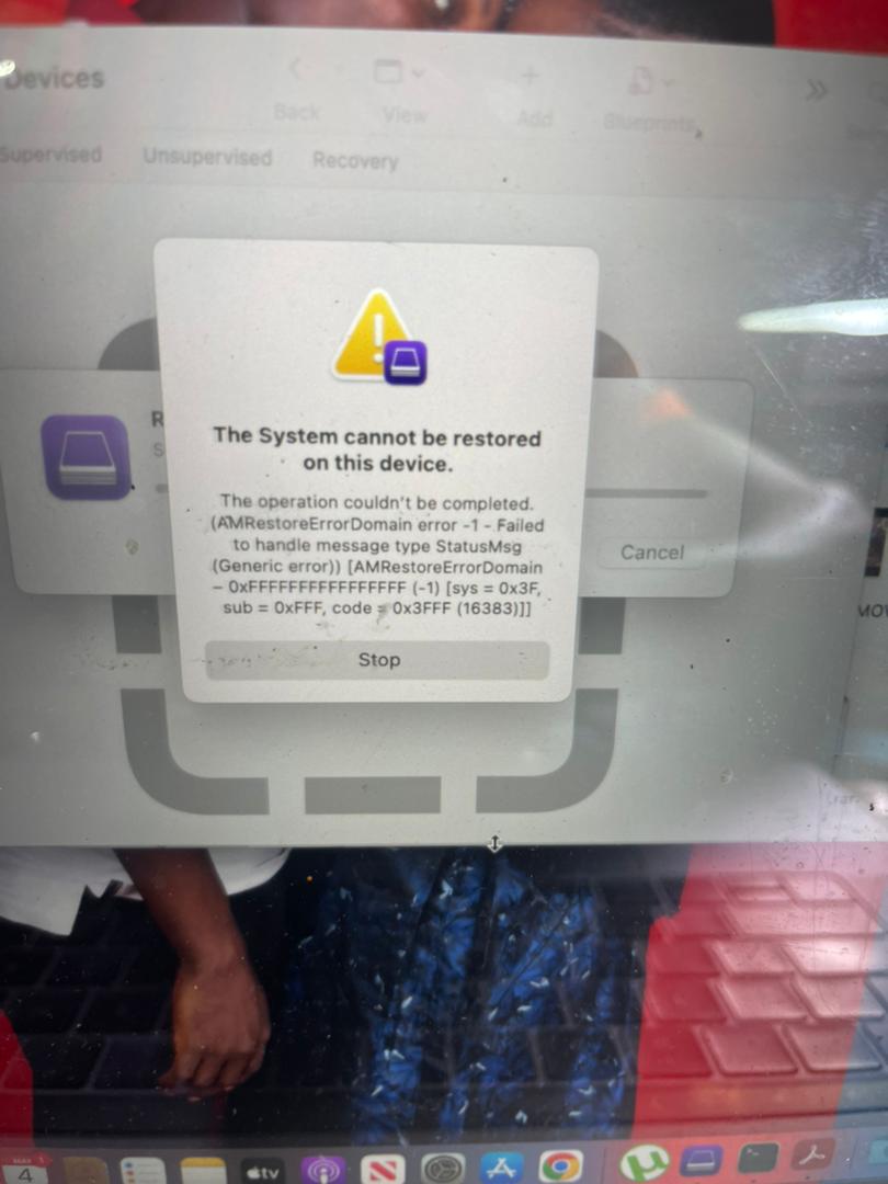

    Recently is seems all the A2289 boards that I am trying to revive or restore using Apple Configurator 2 gives me error -1
    Have anyone experienced this and how to resolve it?

    See here for some ideas:
    https://discussions.apple.com/thread/253371441
    BTW - About to work on a similar case - what is the HOST you are using to run the Apple Configurator 2 tool ? Have not had a need to use it till now.
    Do you see the 'DFU' message once the TARGET is in DFU mode with the hotkey presses ?
