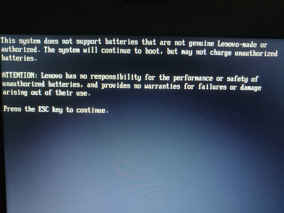

    I have this problem with a new battery

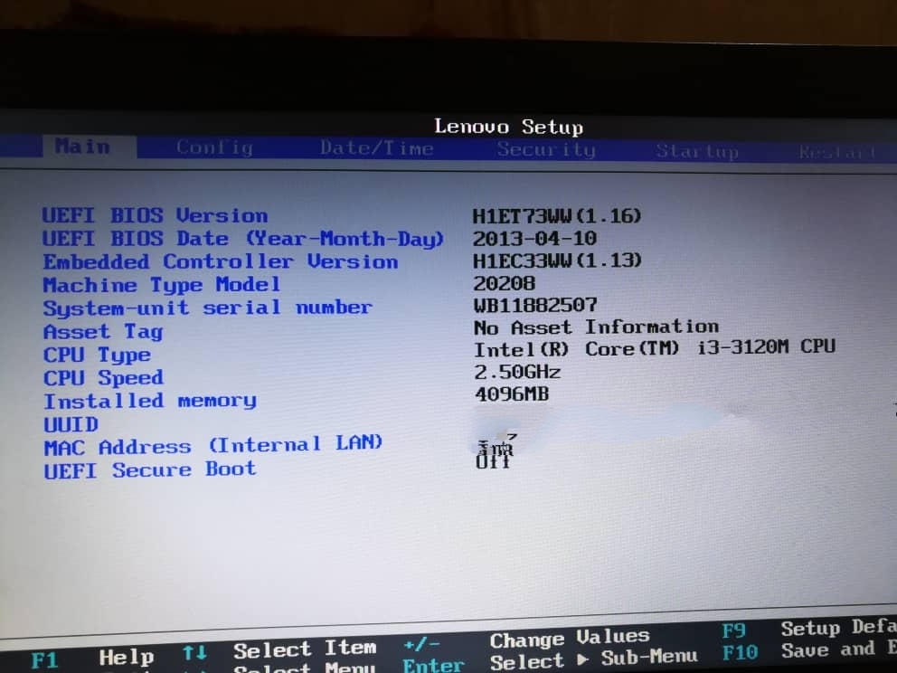

      I have this problem with a new battery, i don't know if it a problem with BIOS security ? can anyone help me please .

        Is the battery an original ? Sounds like the battery is a compatible model but the logic board wants to see some special token from the battery pack.

          This model has a white list of accessories approved by bios. need to delete it. (but I don't know how to do it).

            The solution is to flash modded bios where whitelist for battery is removed but i dont have such a file.

              There`s a B590 whitelist removal thread at bios-mods ,try there https://www.bios-mods.com/forum/Thre...telist-Removal
