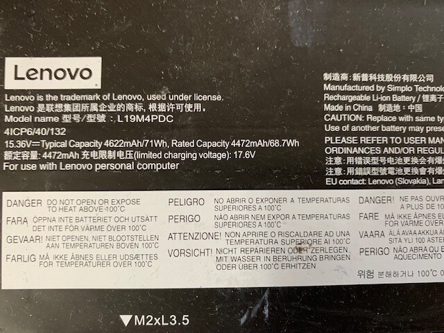

                                  • mcplslg123
                                    • Jun 2015
                                    • 7262
                                    • india
                                    Have you tried another battery?
                                    Too me nothing seems wrong here and perhaps the unit may be damaged by un-necessary steps at this stage.
                                    The compatible battery is simply not compatible with this unit.
                                    Post the original battery+new battery PICS
                                    • NConstantinou
                                      • May 2017
                                      • 351
                                      • Cyprus
                                      No i do not have that type but this battery works on another Lenovo.
                                      i am sending you pictures of original and compatible
                                        • 21993
                                        To save anyone else having to download,extract,rotate pictures and zoom in to see the part numbers i`ll post the pictures and part numbers
                                        Both battery models: L19M4PDC
