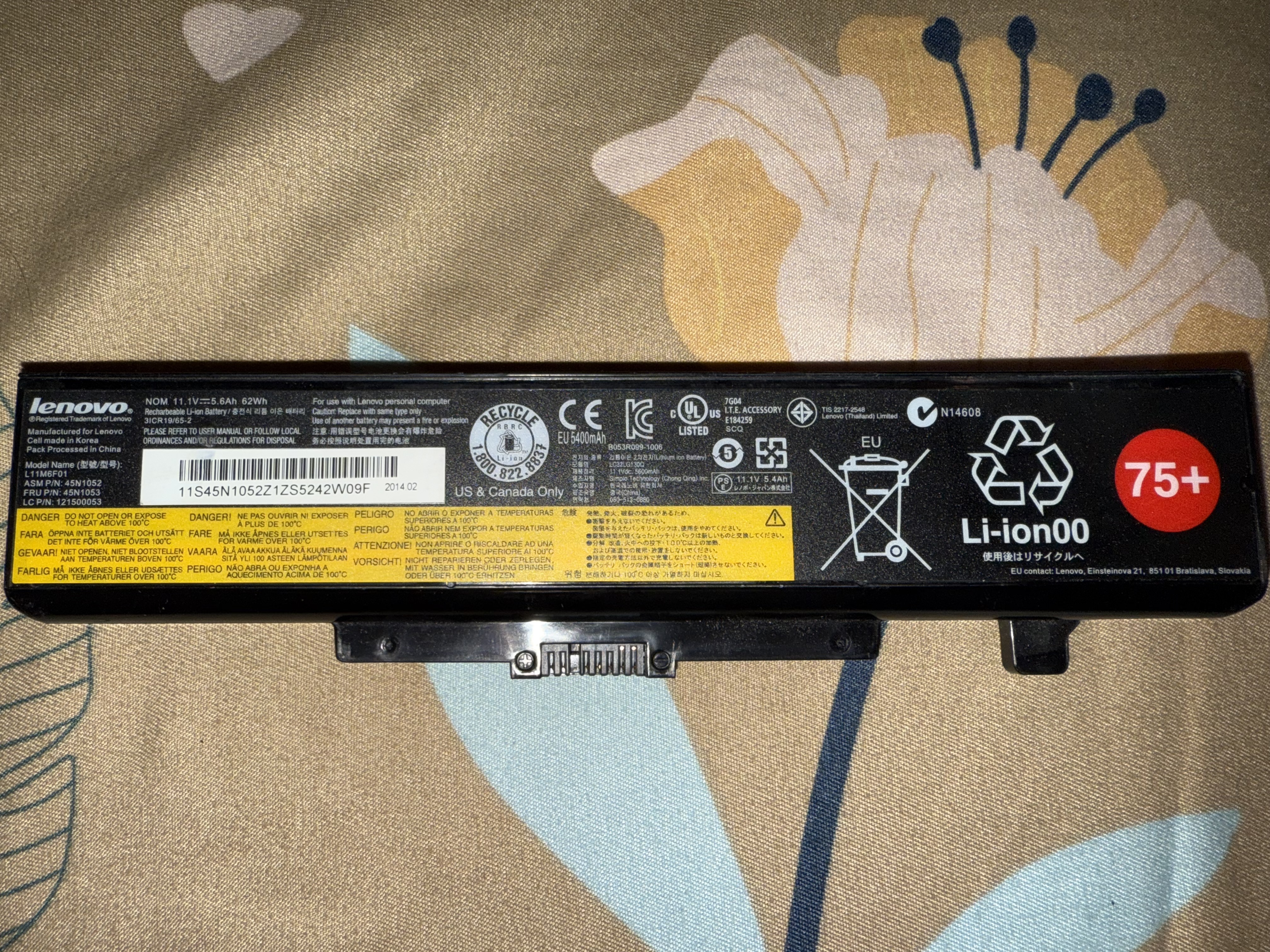

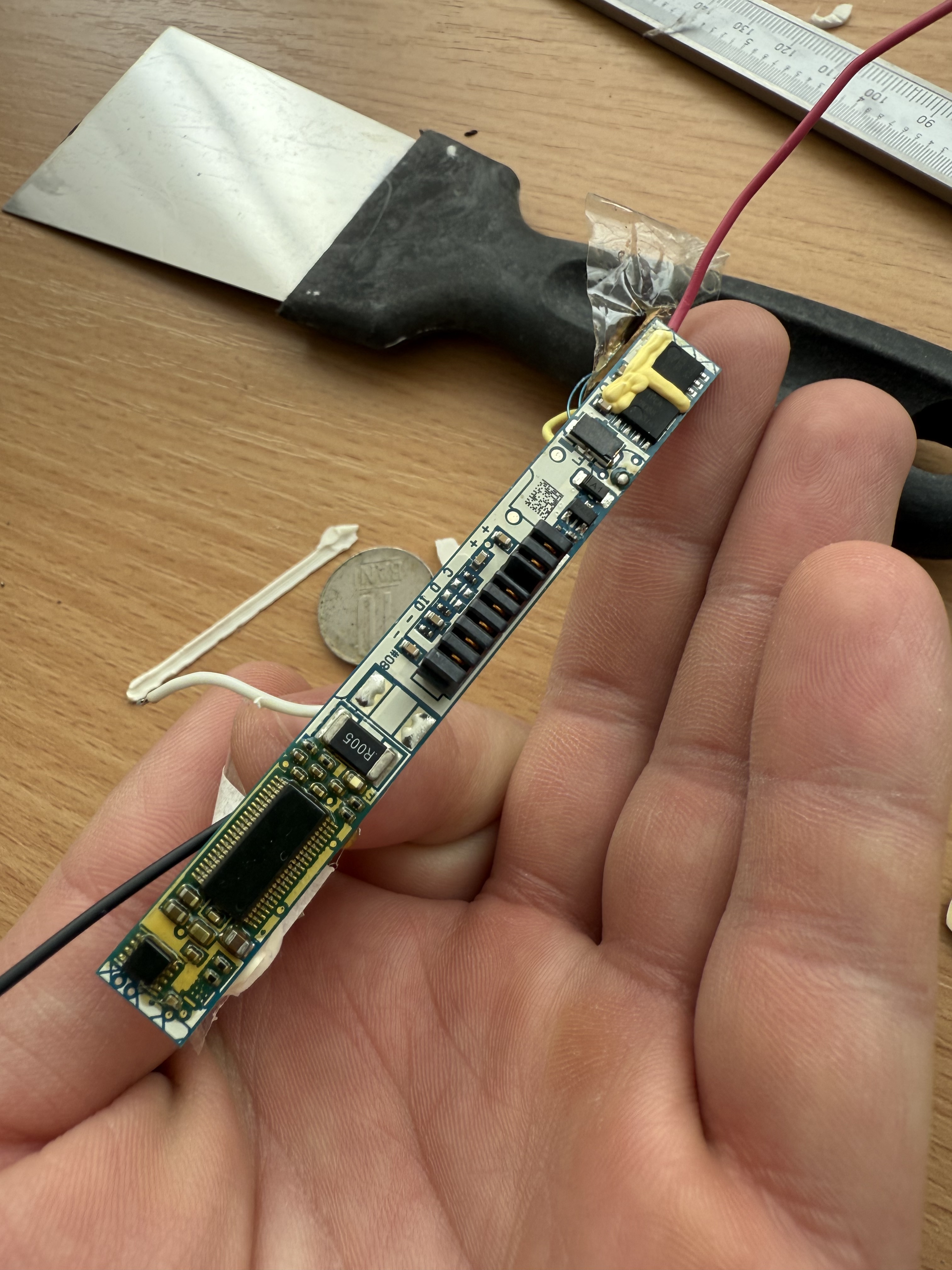

    Hello! I'm here to look for solutions to reset the EEPROM memory of a Lenovo E540 battery of 62Wh and 540mAh. I even bought a new one on the market (aftermarket BTIBM30) because I couldn't find an original one but it doesn't work. The laptop sees the percentage but blocks the battery charging probably because of the Chinese BMS. In the bios I don't have an option for the battery and I didn't find an older version (v1.57). I replaced the Lenovo BMS with Chinese cells but in windows it doesn't read the battery percentage and says it needs to be changed. I have 12v between D and the red wire.

    Suggest highly to consider a known good replacement from your local Amazon stores. You will have the best form of consumer protection if the battery is a dud and fails to work for your case. You can return it back to Amazon. Alternatively, the attempt is a hack and somewhat a guarded secret. You can check the NLBA1 tool which may or maynot work for you so best to ping them for support. The tool is not inexpensive.

      Hi! I gave up. I came to the conclusion that it is best to find a battery or use the laptop only on the charger. It is not good to repair the BMS. Thanks for the advice!

        It is very risky - can explode / cause a fire. The vendor may be close to you - you can always ask for advice on this unit.
