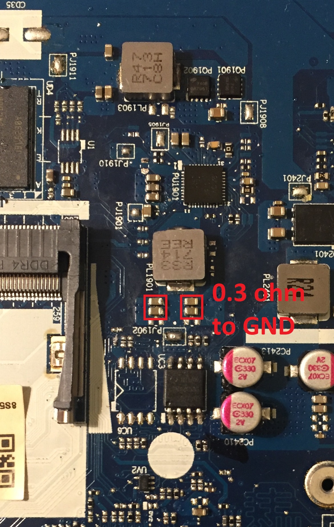

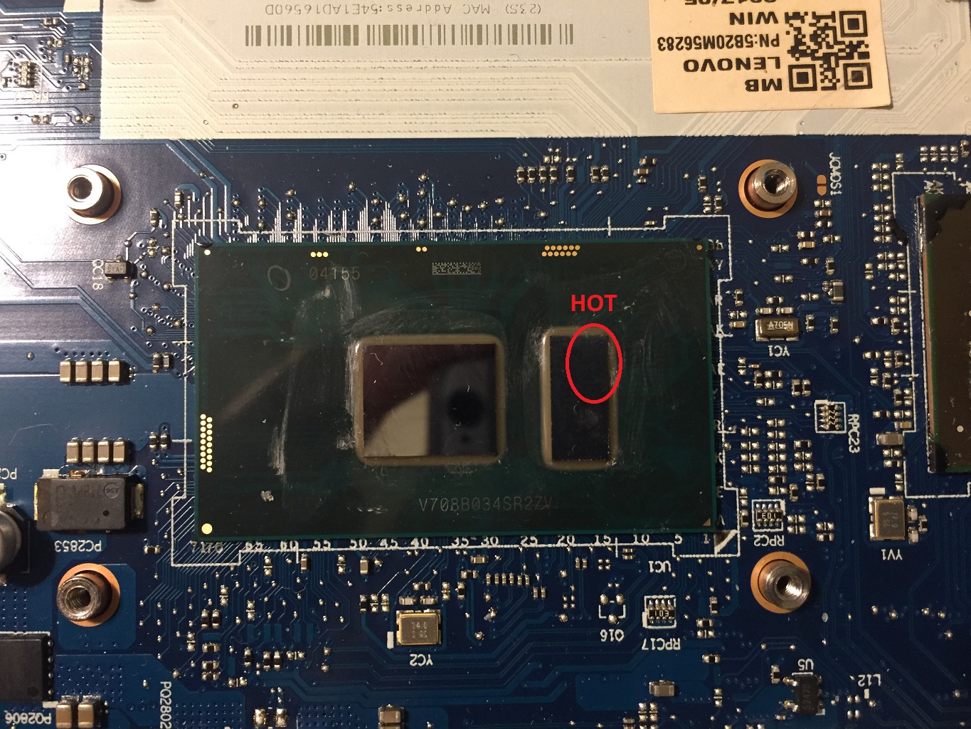

    Hi everybody, I'm back with another laptop to repair, but this time I'm not so confident it can be fixed
    It's a Lenovo V110-17ikb 17" with an i7.
    I suspect a short on CPU but I would like your opinion.
    This is the current status:
    - the bios battery was completely dead (0V)
    - without laptop battery the board draws about 150mA from the power supply.
    - the 19V main power rail is working correctly
    - +3VALW and +5VALW are present
    - power button and BIOS receives the 3.3v
    - When the PS is connected, the CPU warm up quite a bit in the area shown in the image (the PCH I guess)
    - There are few caps with very low resistance (about 0.3ohm) to GND in the area near the coil PL1901: PC1912, PC1913, PC1914, PC1915
    This coil operate on the +1.0VALW and there is no voltage.

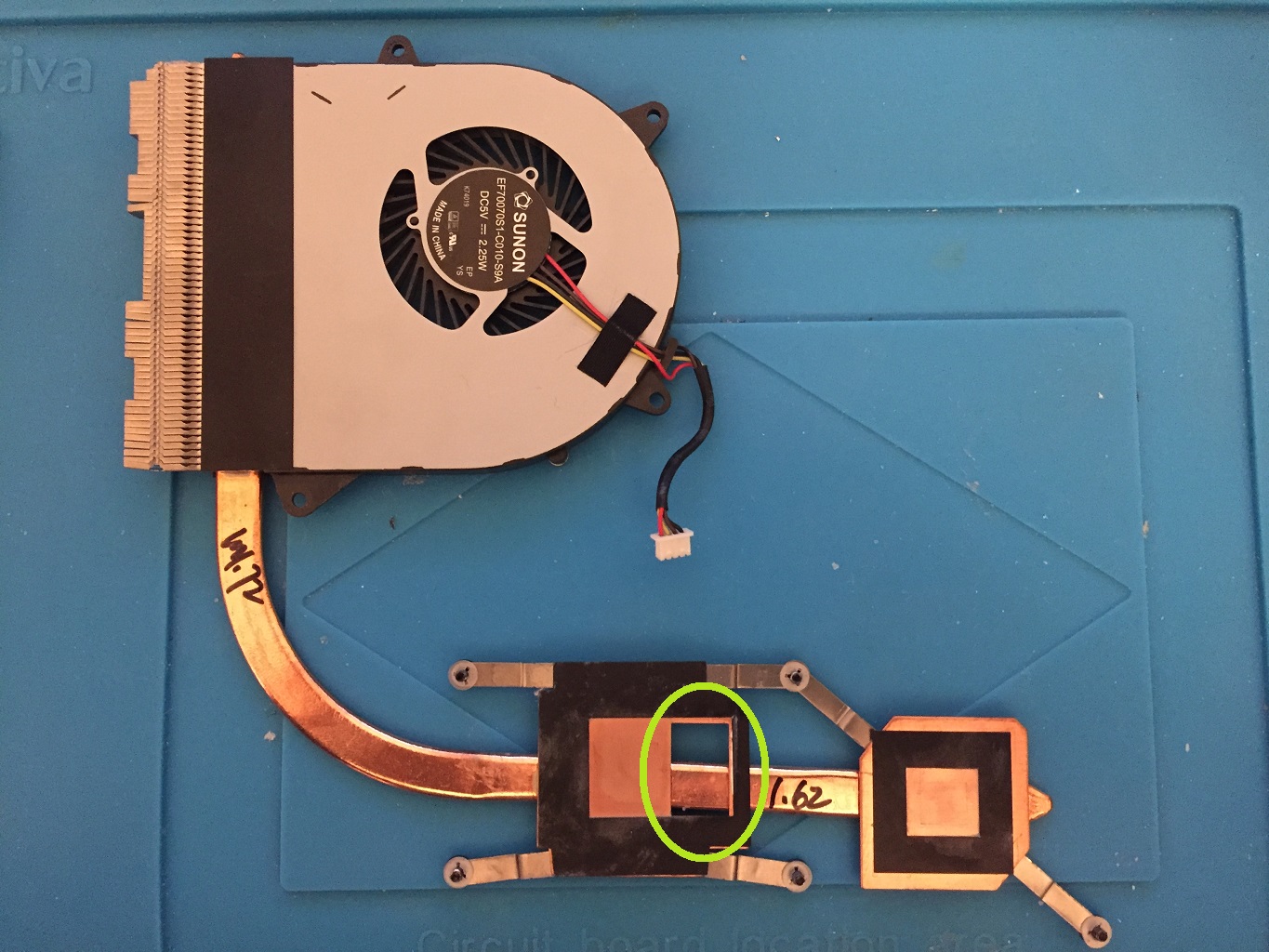

    Side note: someone can explain me why the heatsink has a hole right on the PCH?

    PCH part of the CPU is likely shorted. PCH doesn't generate that much heat so they don't provide any thermal management for it.
