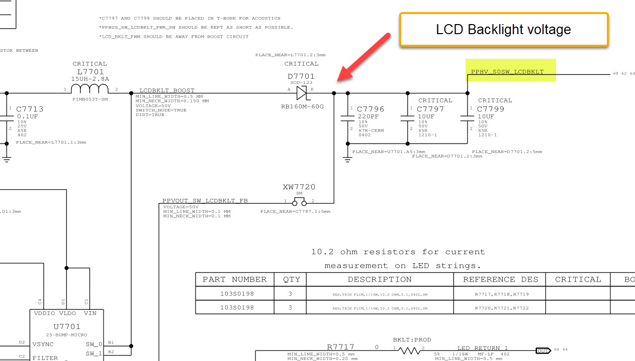

                            Attach the LCD again. Can you see the backlight after the fan spin ?
                            If not, measure the backlight voltage for the LCD.

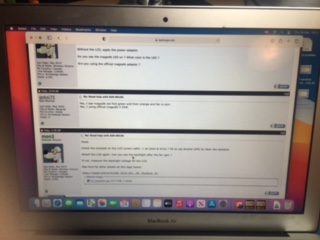

                              Checked contacts on the LCD screen and all is clean.
                              I connected lcd again and have this.
                              But the problem is still present after going into sleep mode it no longer turns on.

                                Good - can see my selfie.

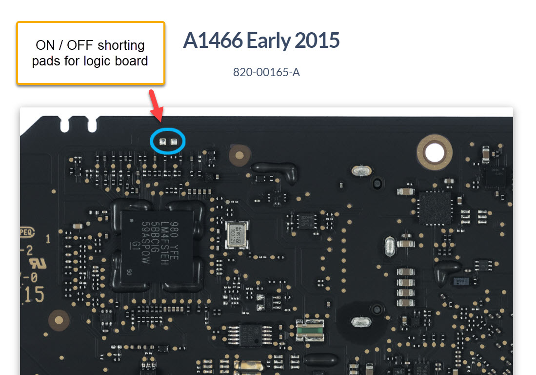

                                Remove all power. Remove the trackpad cable.
                                Power on again with the adapter.
                                See attached (stolen from beetstech website) - use tweezers to turn the logic board on/off across these pads.
                                Does the logic board power on and show the display every time you use the tweezers ? Repeat this testing a few times to confirm.
                                If not..
                                Remove all power. Meter in resistance mode. Confirm the resistance of R5171. Should be ~100k ohms.

                                  I did as you said a couple of times and logic board is power on and show the display every time, R5171 is 100k.
