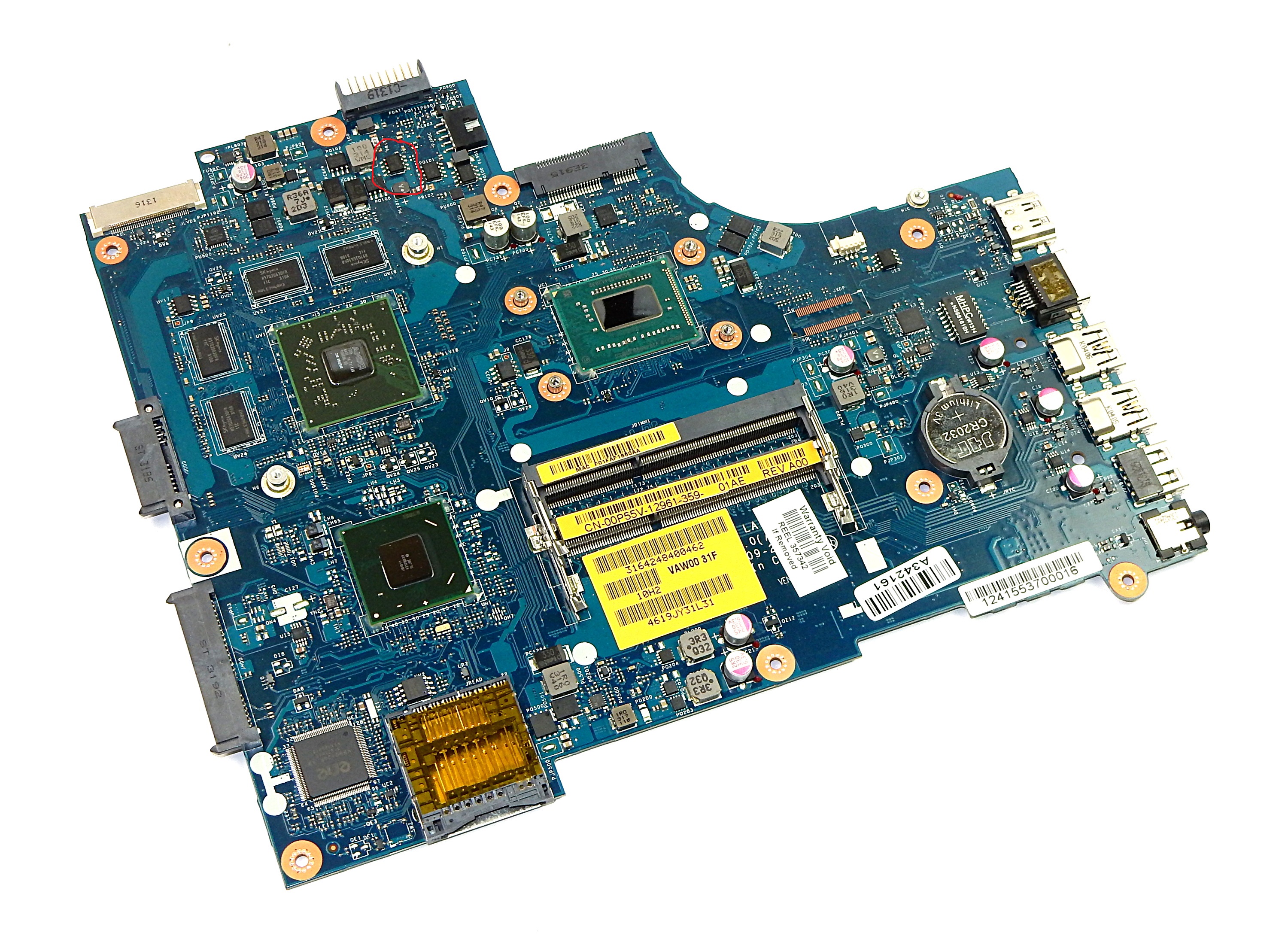

dell 5521-la-9101p
  • baki60
    • May 2020
    • 78
    • Türkiye
    dell 5521-la-9101p
    2 beeps no picture bios rewritten problem not fixed where should i check
    thank you masters
  • mcplslg123
    • Jun 2015
    • 7262
    • india
    Re: dell 5521-la-9101p
    Check voltage on QC3 -Pin1-4-8
    • baki60
      • May 2020
      • 78
      • Türkiye
      my master
      1:1.4
      4:14.1
      8:1.4
      • baki60
        • May 2020
        • 78
        • Türkiye
        mosfer 1-2-3 pin short circuit
        • Techtiger
          • Oct 2014
          • 1601
          • france
          What is the voltage QH2 A/B all pins ?
          • Techtiger
            • Oct 2014
            • 1601
            • france
            Those Fets are related to battery circuit , move on did you try with several bin file's ? What are the missing voltage? Take a pic note down missing voltage on the big gray coils !
            • baki60
              • May 2020
              • 78
              • Türkiye
              1 V
              1.4 V
              3.3 V
              5 V
              voltages in coils
