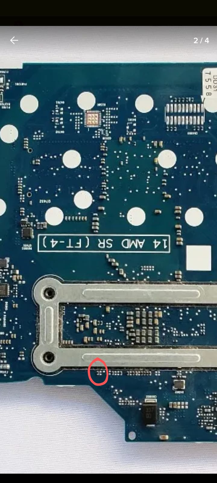

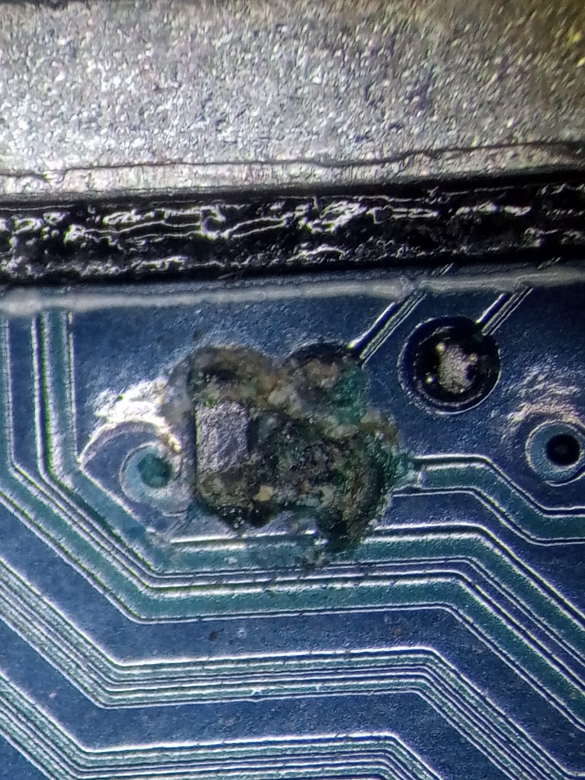

    I need help for identify this resistor. It was lost after cleaning the board.
    Mainboard is HAGRID 6050A2983401-MB-A02 (A2) for HP 14-cm /15-cm
    Thanks in advance.

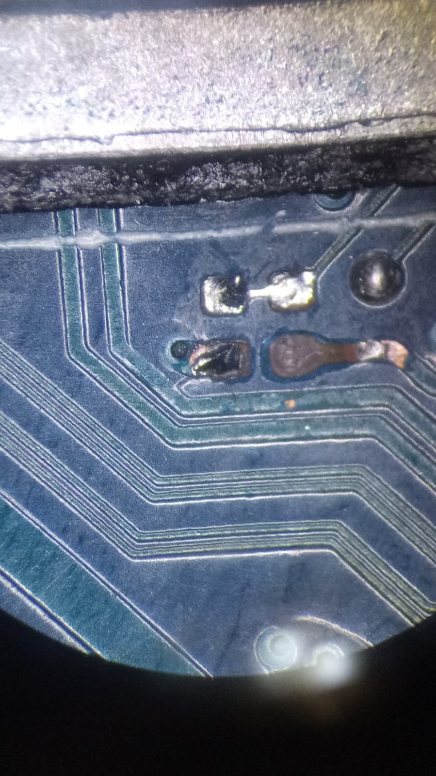

    Re: help for identify component on 6050A2983401-MB-A02
    Its hard to tell as i dont have such a board under repair. maybe someone have it under repair and give the exact measurement. Else ,you can try with a 100K resistor ,observe voltage at both ends after powering on and then gradually try a lower resistance like 10K-20K. The advice is means of last resort and has some element of risk but worked on many mobos where schematic/bdv is not avlbl. So proceed with caution.

      Today I received another laptop exactly the same model so I'll reply myself.
      This resistor measures on meter exactly 2K in both directions.
      Hope this help someone. 😀
