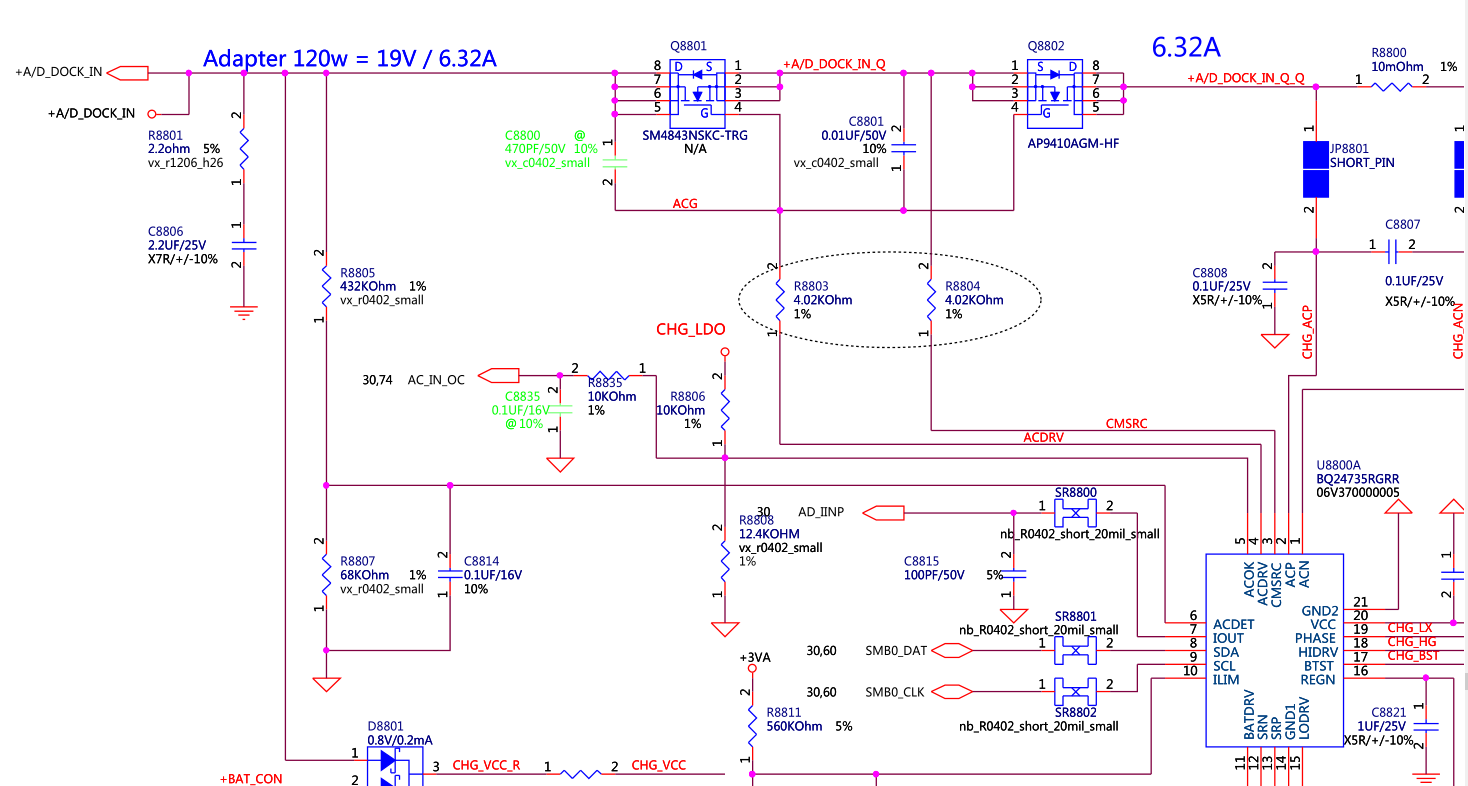

    any one can help , this laptop charging working normally ,and white led observed after power button pressed,
    3.0 volt is founded on power button in keybaord
    3.3 volt founded on bios chip
    3.3 &5.0 power system founded any help
    power consumption on power supply 0.03 mili ampere
    new bios file tried the same issue.
    nor cpu neither gpu & chipset get warm after power button pressed.

    Re: gl553vd
    Hi.
    1) Are you using the original power adapter rated @ 120W ?
    2) Laptop is charging normally but consumes 0.03 mili ampere ?
    3) Without the battery, the laptop does not work with the power adapter ?
    See attached.
    With the power adapter connected, measure the voltages on each pin of the charger IC. Post the readings.
    Most likely the fault is in the first 2 mosfets.

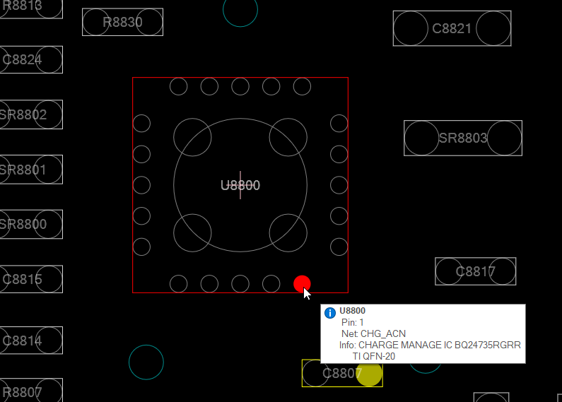

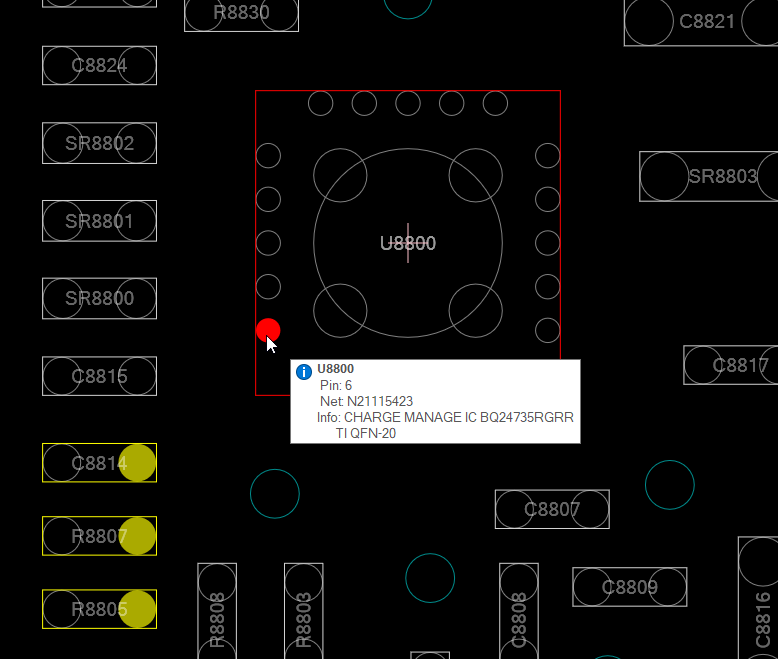

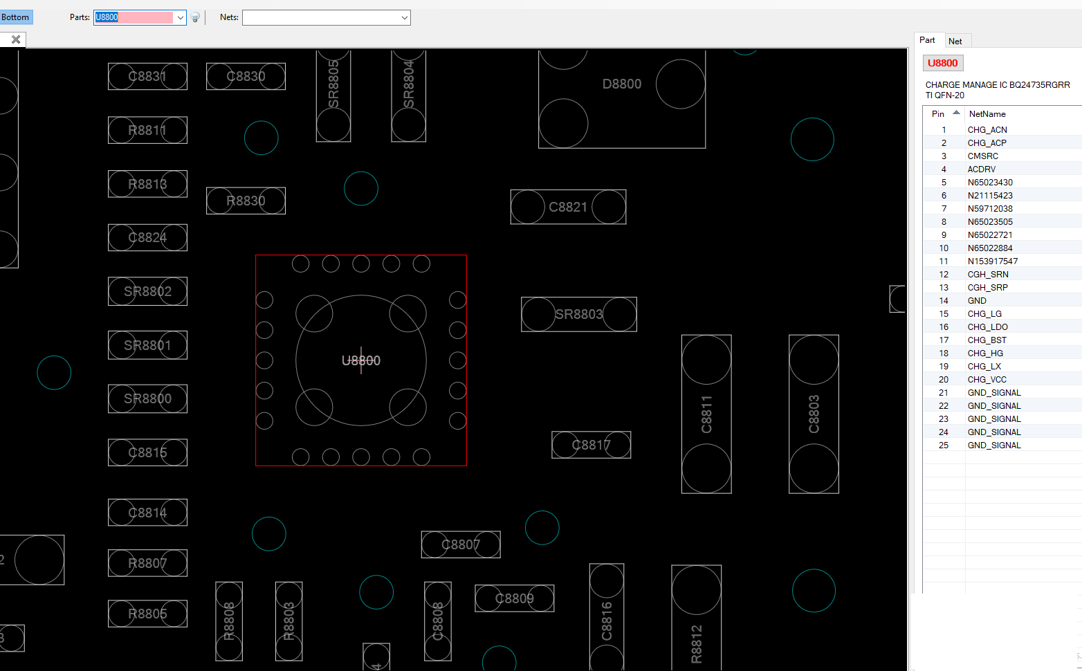

        Originally posted by mon2
        Hi.
        See attached.
        the voltage on pin 1 is 19 volt and on pin number 6 is 2.4 volt
        the laptop is 0.03 with battery and without battery and when press power button the white led light up but nothing on display

          Re: gl553vd
          Post the voltage readings on each pin of Q8801 and Q8802 mosfet. Use only the external adapter.

              Re: gl553vd
              q8801
              5,6,7,8 =19v
              4=24v
              1,2,3=19v
              q8802
              123=19v
              5,6,7,8,=19
              4=24v
              • mon2
                • Dec 2019
                • 14691
                Re: gl553vd
                Mosfets look good.
                Does this laptop work without the battery but using only the power adapter?
                Is the battery a good battery?
                Any liquid damage?
                Post the voltage on each pin of the charger ic but connect the battery and adapter.
                If the laptop fails to turn on, remove all power and check the resistance to ground of every coil on the board. These are usually grey in color and large parts.
