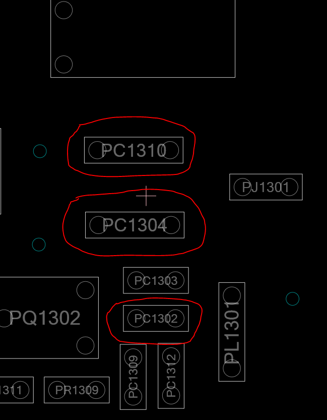

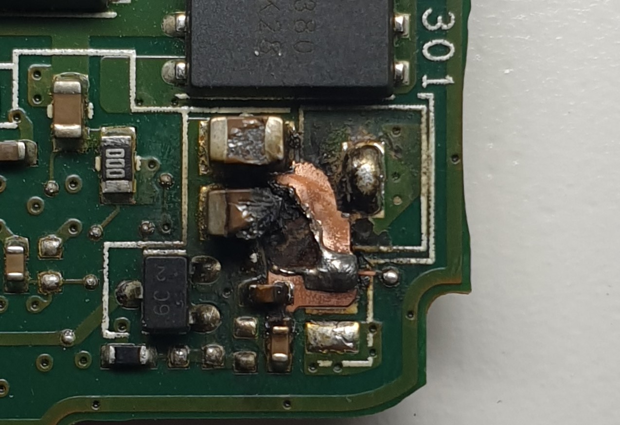

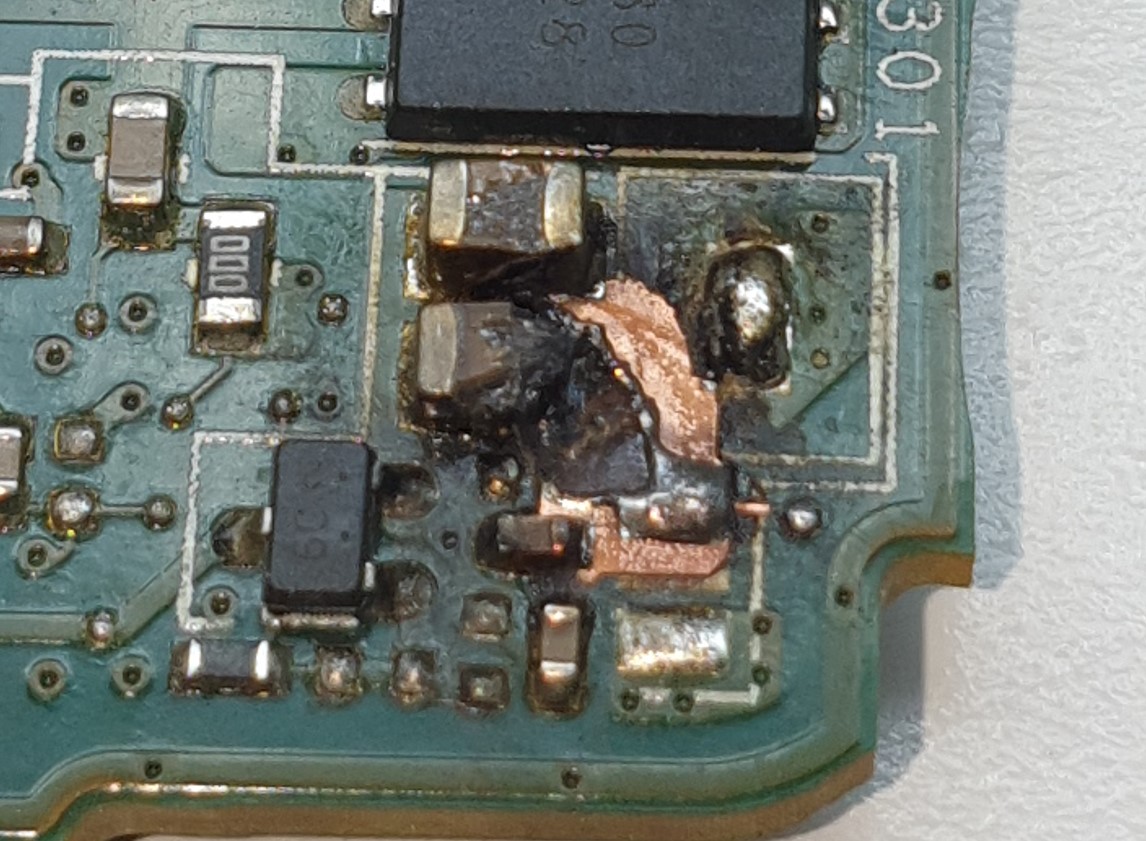

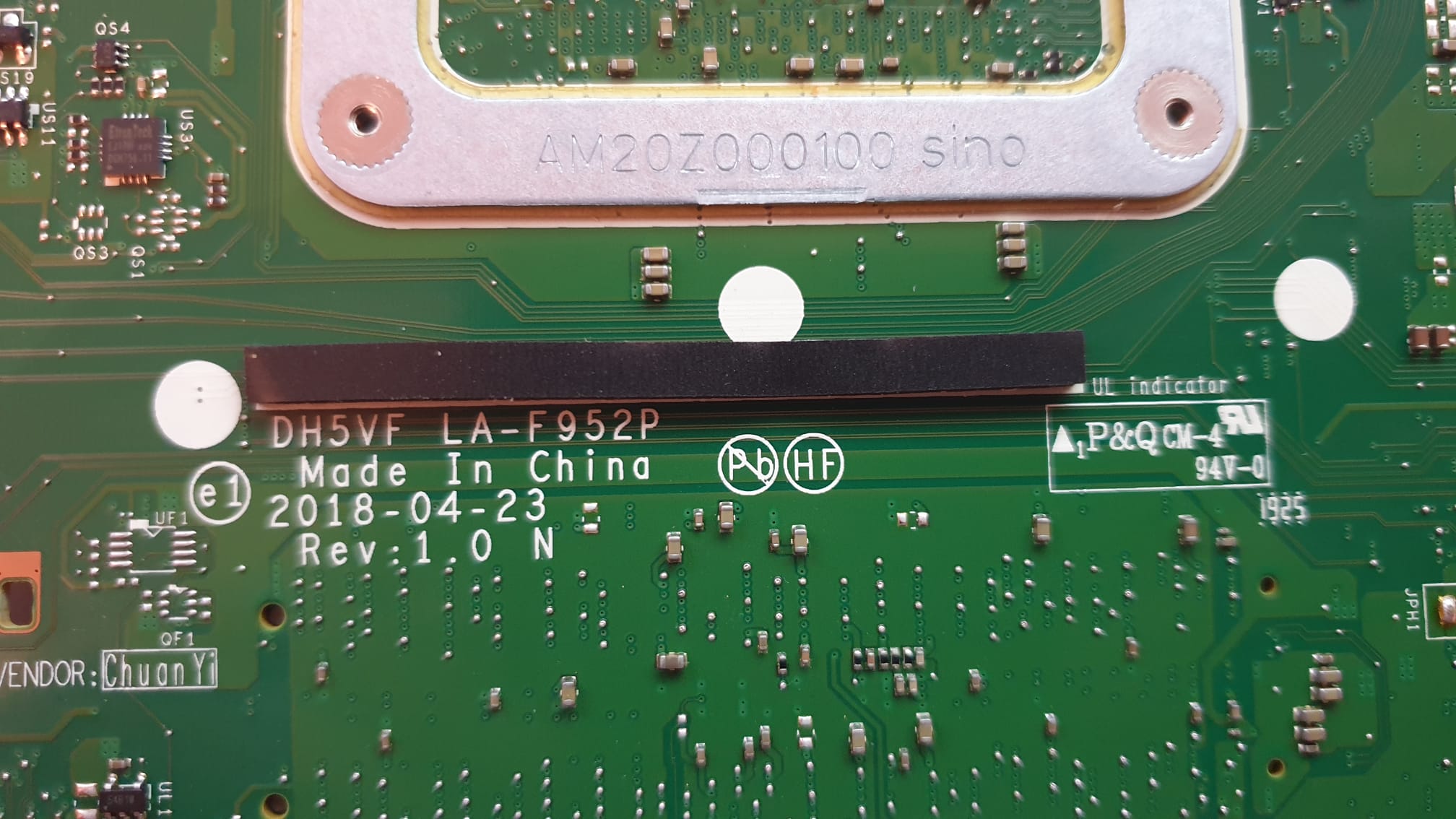

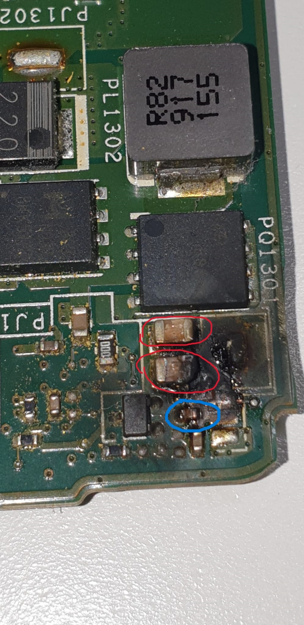

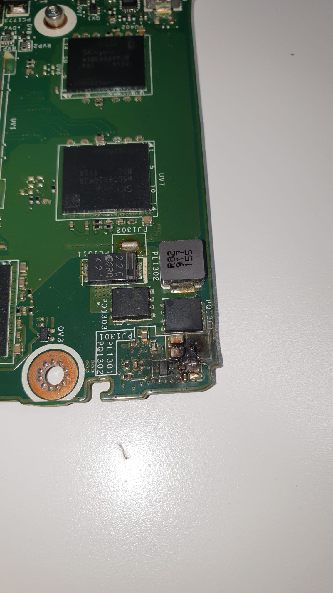

    Hello dear community,
    I have the following damage to an ACER AspireA717-72G, and I had a short circuit, attached are pictures of the damage.
    It's about the DH5VF LA-F952P motherboard.
    I will try to change the 3 transistors (2 marked red and one marked blue) and see if it comes on again. Can you tell me what the parts are so I can order them?
    I can solder but I'm not familiar with the construction plan of the mainboard, do you think it still makes sense, or can the mainboard be thrown away?
    Many thanks for the support

    Re: DH5VF LA-F952P Motherboard short circuit

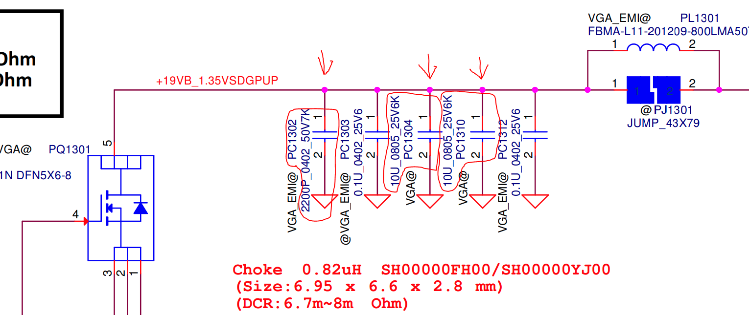

    These are not transistors, but ceramic capacitors, you will understand their denominations on the diagram.

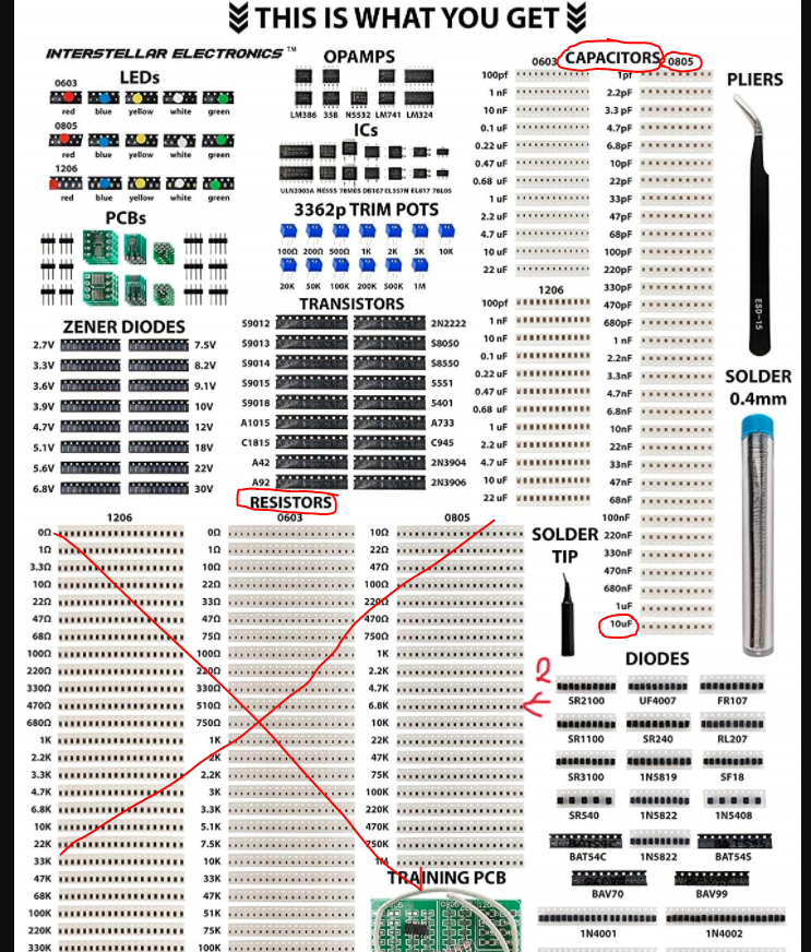

      Thanks for your pictures.
      I found these.
      https://www.mouser.de/ProductDetail/...3D&mgh=1&vip=1
      are they correct
      Unfortunately, I haven't found the PC1302 yet.
      • 247
        • May 2021
        • 24
        Hi, I have such a set, can I take the 2 with 6.8k? For 10U_0805_25V6KPC1304 and PC1310?
        Can I take something from the table for PC1302 2200P_0402_50V7K? Or is there no right one?
          If you have a short, then most likely only one component is shorted. You need to find which one and to remove only that one. Otherwise if you just start to remove all components you find "shorted" then it can take a lot of time and a lot of component.
          When one capacitor gets shorted on a power rail, many things that are on that rail can appear as shorted.
              10U_0805_25V6KPC1304 and PC1310 - Do you have these
              2200P_0402_50V7K PC1302 - You don't have this
