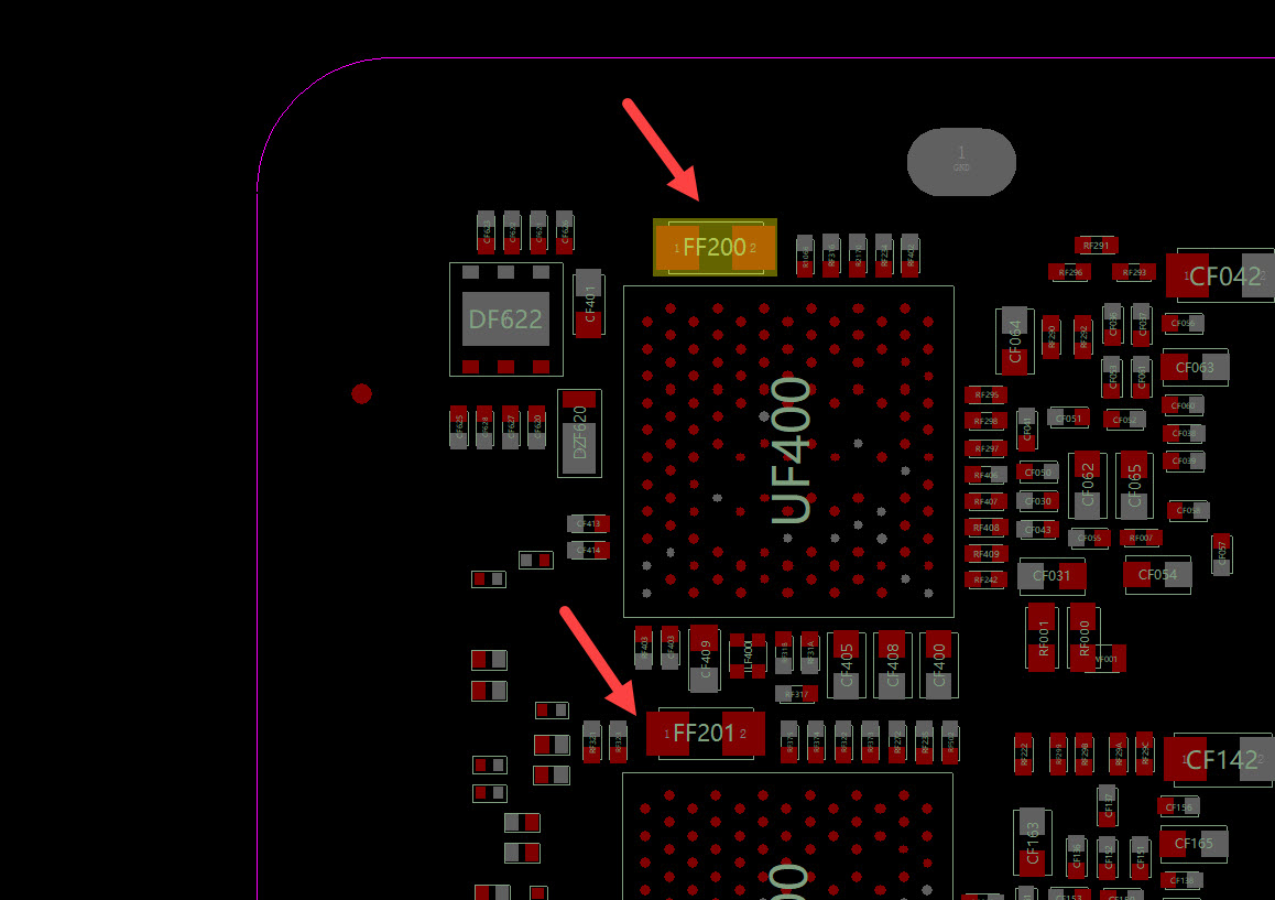

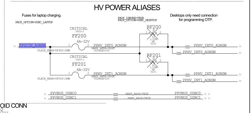

    Check each one of the fuses:
    (remove all power / no battery)
    Meter in resistance mode (2k is ok)
    Check resistance with meter across each such fuse.
    FF200
    FF201
    Update:
    You have some voltage so the fuses may be ok.

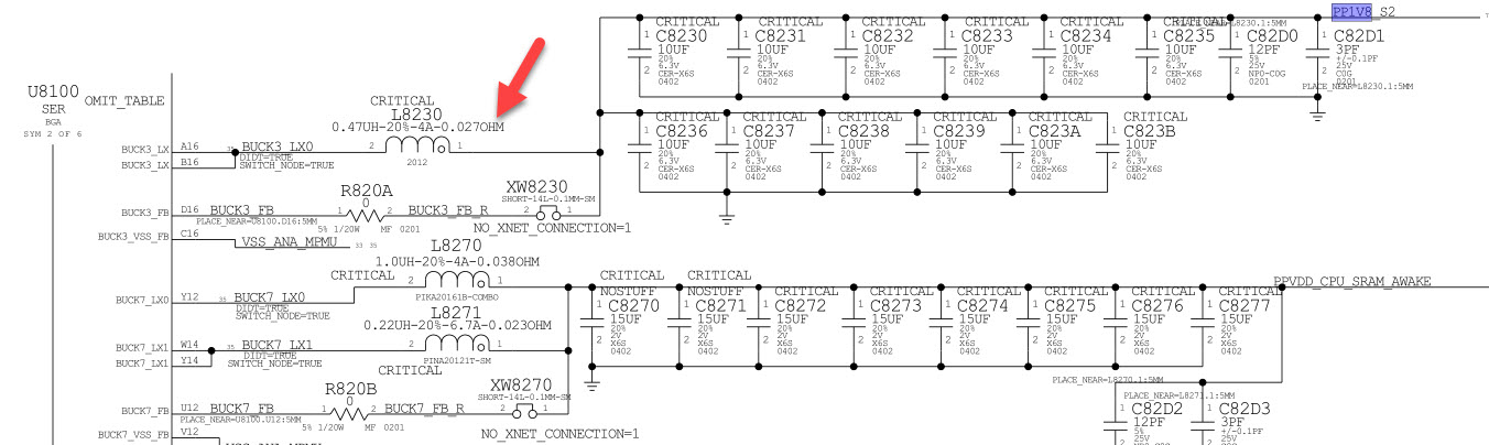

    1) Locate L8230. Meter in resistance mode. Remove all power. Check & post the resistance to ground for L8230, pin # 1.

      Re: 820-02016 No Power, 5v 0.00amps as
      FF200
      FF201
      Update:
      Bro Mon2
      Fuses Meter in resistance mode (2k is ok) : i have 130k (direct - reverse)
      Bobina L8230 : I Have 9.70k -23k ((direct -reverse)
      thanks
      • mon2
        • Dec 2019
        • 14204
        Hi. Looks ok.
        What is voltage at L8230 ?

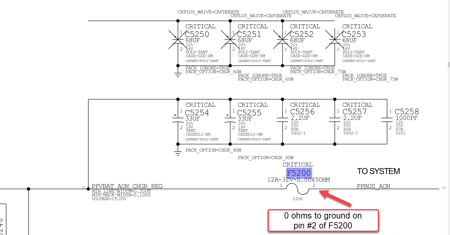

              it will be PPBUS_AON - mosfet @ Q5800 which uses this rail to step down to create PP3V8_AON.
              On this note, remove all power / no battery.
              Meter in resistance mode (2k scale is ok).
              Measure & post the resistance to ground of PPBUS_AON (fuse F5200, pin #2).
              • oemelectronic
                • Sep 2019
                • 33
                • peru
                Brother Mon2
                Pin 2 fuse 5200 to Gnd
                4.6k direct
                200k reverse
                • mon2
                  • Dec 2019
                  • 14204
                  Update.
                  You have a bad voltage @ PPBUS_AON but do not have a short ?
                  Do the following:
                  Remove all power.
                  Flux & remove fuse F5200 off the logic board. Keep it off the board for now.
                  Allow for the board to cool.
                  Without power, meter in resistance mode.
                  Check & post the resistance to ground for:
                  F5200, pin #1 pad on the logic board (provider)
                  F5200, pin # 2 pad on the logic board (consumer)
                  We need to know which side of the FUSE is the short circuit on the logic board.
                  Is it the provider (U5200 = ISL9240) or the consumer side ?
                  Post your measurements without the fuse.
                  After this, power up again and measure the voltage of PPBUS_AON. The issue may be a defective ISL9240 but need to check a few more points on this IC.
                  • oemelectronic
                    • Sep 2019
                    • 33
                    • peru
                    Dear
                    Same 4.8k loading and unloading pin2
                    same 5k loading and unloading pin1
                    NOT HAVE :
                    CHGR_RST_IN: 0 Volt.
                    I2C_SMC_PWR_1V8_SCL : 0 Volt
                    I2C_SMC_PWR_1V8_SDA : 0 volt
