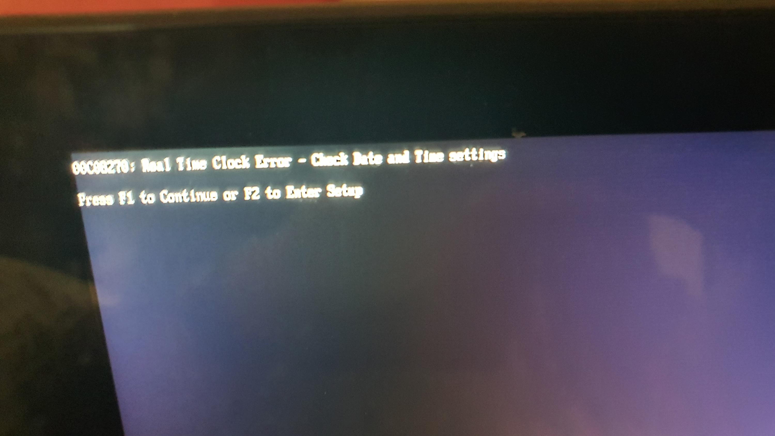

    Hi guys.
    I purchased this laptop from a guy but sadly he sold me with an eror when I boot up I get a meesage with time and date incorrect
    I suppose it has to do with bad BIOS battery.
    Now I did purchase new CR1220 battery and want to replace it because I don't have anyone to do the job for me.
    I think I have all the necessary tools for it.
    Does it look too complicated for a newbie like me?
    Thoughts?
    Problem is that I don't have whole stuff this protection around battery and these 2 metal pieces,nor I can order from e-bay.
    I just bought brand new CR1220 battery and that is it.
    How do I make all this with brand new battery (this "black protection" and metal pieces on the bat).

                      Real Time Clock Error at Boot
                      Hi guys.
                      I purchased used laptop from a local seller but when I turn it ON I get this error.
                      I can boot to Windows but having issues with incorrect time and date and can't connect to internet
                      How do I resolve this issue with time?
                      Would just replacing CMOS battery do the job?

                          It might help if we knew what the make and model is.Please also add the model number to your thread title in future.

                            Re: Real Time Clock Error at Boot
                            Actually there is a video on yt how to replace the battery.
                            I ordered one,just want to know if replacing will resolve the issue?

                                Medion Akoya P2212T.
                                If that is the case then replacing battery won't resolve the issue?
