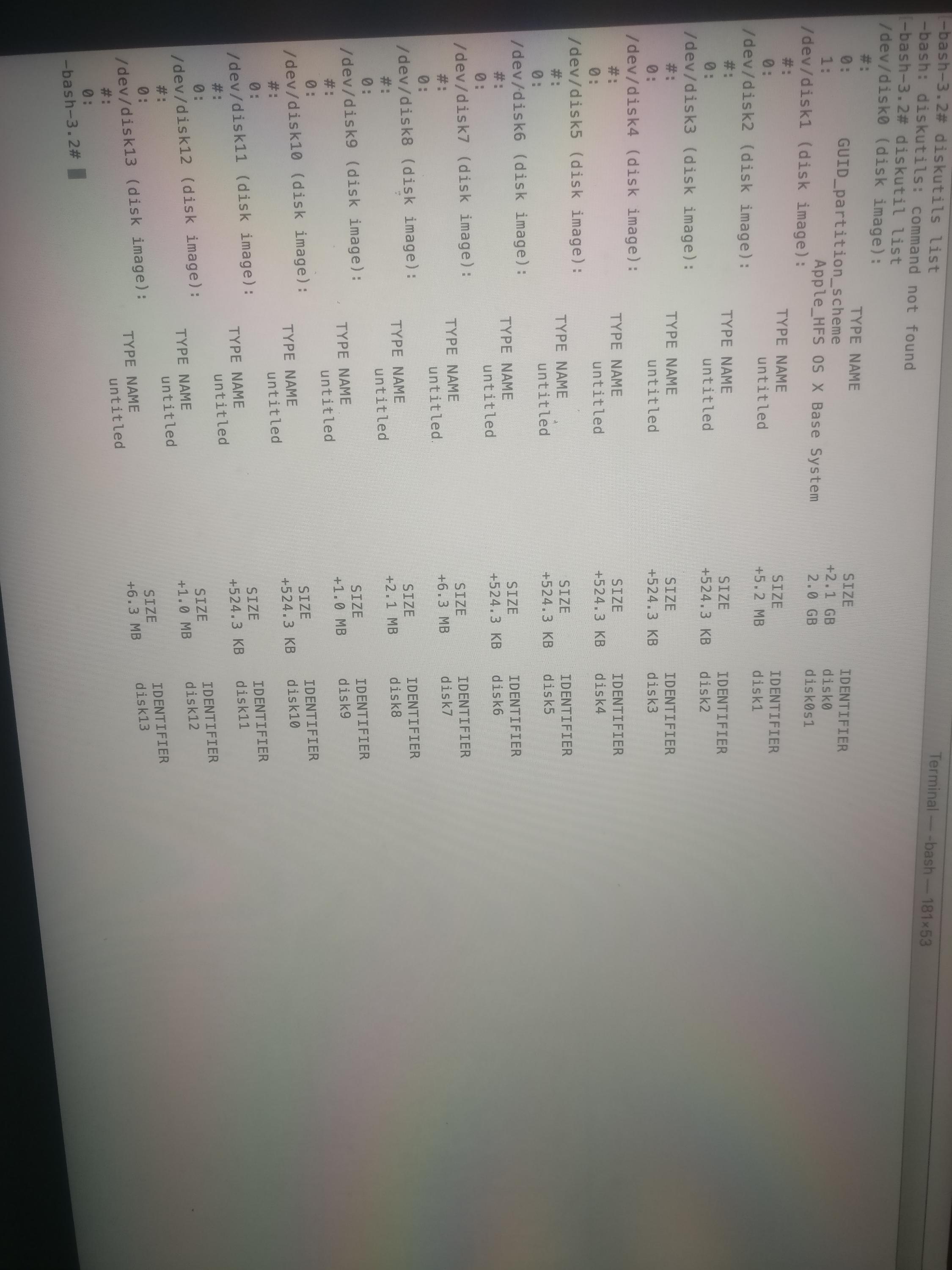

    My macbook pro froze, and now I get the folder with question mark symbol. In the recovery mode the SSD can't be found in the disk utils. I then used a Linux USB stick to try to mount the SSD and it wasn't present in `lsblk` . Which led me to the conclusion that the SSD itself is broken. I then gave it to apple support and they say that the SSD is dead and wanted to replace it for around 400€. I declined this "repair".

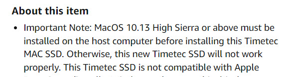

        Are you meeting the MacOS requirement for this box ?
        See attached.
        • backes
          • Jan 2022
          • 9
          • Switzerland
          Re: Macbook Pro 2015 A1502 SSD apparently died
          Yes, I had at least 10.13 installed. I checked this before ordering the ssd.

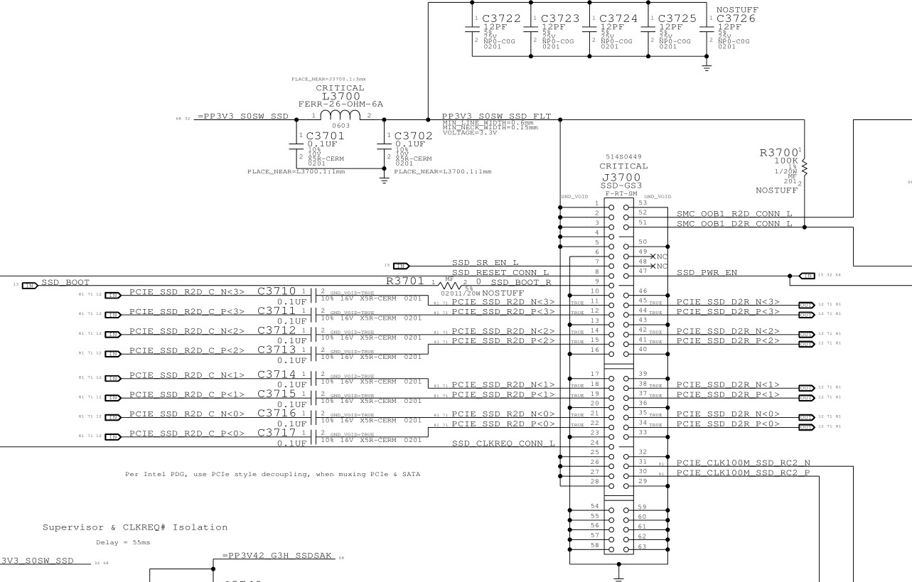

            Do you have a multimeter ? You can try to clean the edge gold contacts with a q-tip of the SSD with alcohol (pharmacy grade is good) - we use the stuff from Costco. Then seat it back and test again.
            Aside from this suggestion, perhaps some voltage rail is gone with the age of the unit. It is known to happen. The bulging battery does not help and that may have caused some warping of the PCB or cracked a mated component leading to this fault.
            If you feel comfortable, consider to disconnect the trackpad / keyboard connector off the logic board and power up again. Be sure to watch some youtube videos on this macbook to review the location of the connectors. Also, disconnect the battery as a test. Handle with care to prevent further damage.
            Being that the issue is with the SSD, as long as there was no liquid damage, focus on the connector solder joints and surrounding parts.
            Do you have a soldering tools ? Cannot recall but may need to short 2 pads on the A1502 logic board to mimic the on / off button.
            The SSD is a PCI Express design. Respectively, each of the tiny surface mount capacitors must be present for the SSD to be detected.

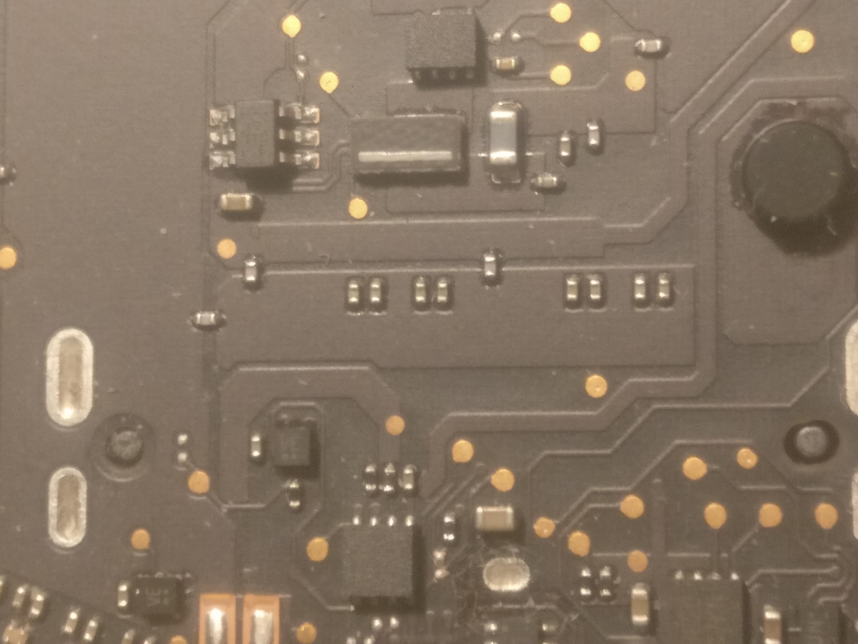

              I have a multimeter and a soldering iron. However I've never soldered so small SMD components. I already disconnected the battery and tired a powerup without the battery. It's the same issue. Why do I have to disconnect the trackpad/keyboard?
              I'll try to locate all these caps. Is it correct that some of them are located on the bottom side of the logic board?
              How can I verify that the capacitors are working without desoldering?
              /edit:
              I uploaded a picture of the caps. They are all there

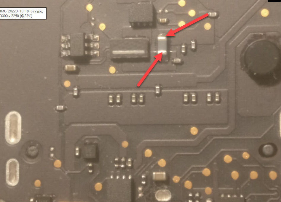

                Check the voltage on each side of L3700.
                Meter in 20V DC scale. Red meter probe to the end point of the inductor.
                Black meter probe to a metal shield ground. To so with care.
                This is the power rail to the SSD PCB. What is the voltage reading ?
                  I only plugged in power, I did not short anything to simulate the "power on" button. It reads 3.3V, I think that is correct
                  • mon2
                    • Dec 2019
                    • 14839
                    That is the expected and proper voltage to power the SSD.
