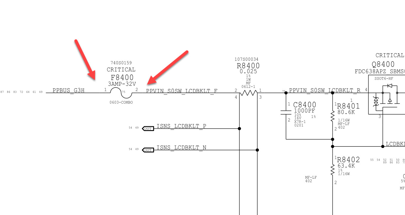

            See attached.
            Start with fuse F8400 which is the INPUT fuse to the backlight boost circuit.
            Meter in DC volts mode; 30+ volt scale should be fine.
            Red meter probe on F8400 & black meter probe to ground.
            Check & post the voltage reading on BOTH sides of this fuse.

              Re: Fuses in Macbook Pro 2019 A2159
              Firstly, many thanks for your time.
              I get 10.8V on both sides of this fuse.
              Remarks: laptop was off for nearly a month (I was away); so initially I was getting 0V on this and other fuses. Plugged in charger, I was able to see up to 40W draw on USB-C charge monitor. CPU heatsink got a bit warm. I can see the same 10.8V across other fuses on board and numerous capacitors. Laptop will not turn on though.

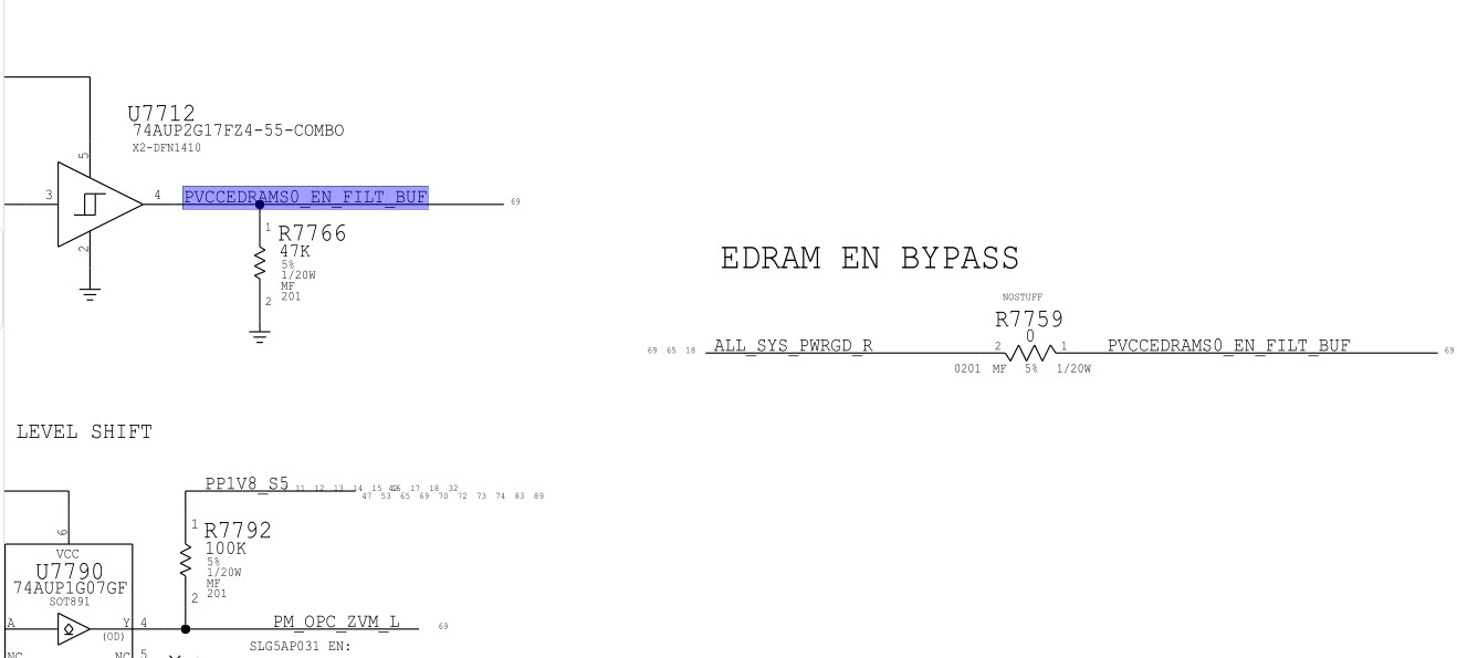

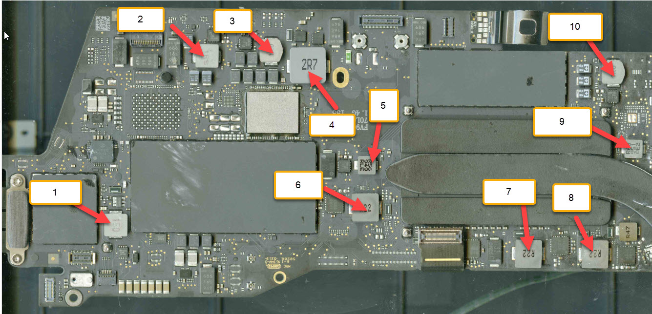

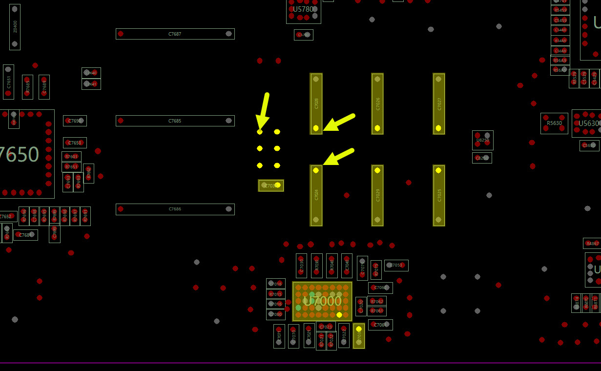

                    The 20V negotiations is good. This implies the USB power delivery controllers are functional and they are chatting with the external power adapter to select this power contract.
                    The PPBUS_G3H rail looks low for the Macbook Pro.
                    Reference:
                    https://www.logi.wiki/index.php?title=PPBus_G3H
                    1) Meter in resistance mode (2k is ok).
                    Remove all power.
                    Check the resistance to ground for F8400. What is the resistance ?

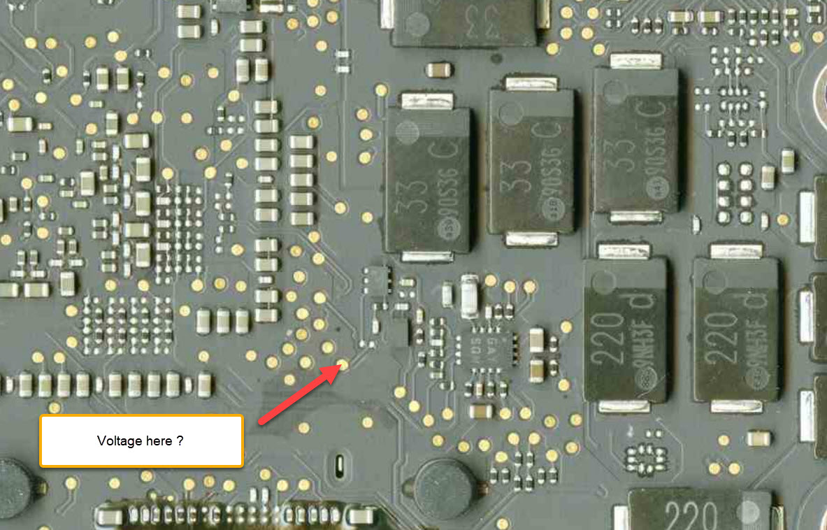

                    2) Meter in DC volts scale (30v+ is ok).
                    Check the PPDCIN_G3H_CHGR voltage. This should match what the USB Type C meter is reporting and should be ~20VDC.
                    See attached on a cluster of caps that can be used for this measurement.

                      Board removed, capacitors drained. I get around 12 MOhms (Mega) at F8400 in ref to GND. I plugged in USB-C daughterboard, charger with monitor, it negotiated 20V again and I measured 20.3V at the capacitor cluster.
                      n.b. I left it to fully charge overnight, and voltage at F8400 rose to 12.43V (remained at 12.4V after unplugging charger).
                      Will be happy to go through next steps, the board is out. Many thanks.

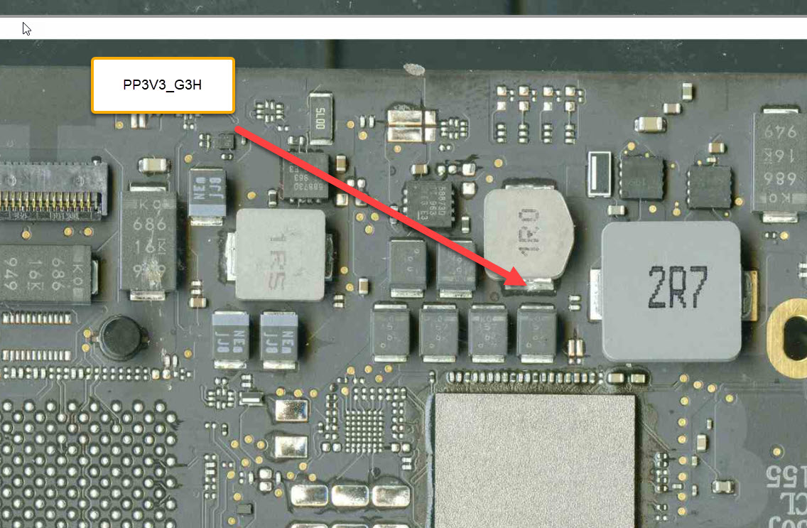

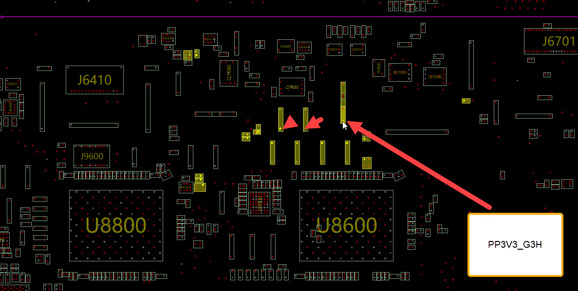

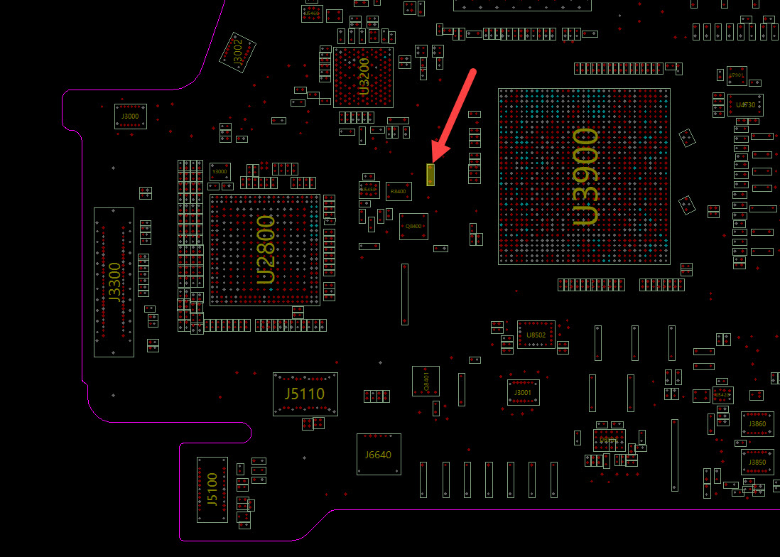

                        Hi.
                        See attached.
                        Measure and post the voltage for PP3V3_G3H.

                          In addition to the above measurements, check & post the voltage readings for each of the coils on the logic board (see attachment).
                          Each coil is linked to a local switching regulator. The coils are 2 pin devices, you can measure either side of the coil with the red meter probe (DC 20V scale should be fine).
                          Black meter probe to ground (shield is ok).
                          • mp844
                            • Dec 2021
                            • 21
                            • Poland
                            01 = 0V (MegaOhms in ref to GND)
                            02 = 5V
                            03 = 3.3V (PP3V3_G3H)
                            04 = 12.6V
                            05 = 0V (50 Ohm in ref to GND)
                            06 = 0.66V
                            07A= 0.66V (hidden under connector tape, to the left from inductor 7, R22)
                            07 = 0.72V
                            08 = 0.7V
                            08B= 0.8V (to the right from inductor 8, smaller one marked R47)
                            09 = 0.95V
                            10 = 1.2V
                            F8400 fuse = 12.6V

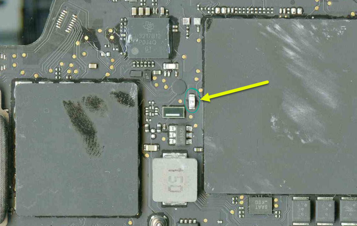

                            • mon2
                              • Dec 2019
                              • 14342
                              * this rail is for the LCD backlight which is not working so makes sense to be @ 0V
                              * L7702 on the logic board
                              * for the 1v0 rail required for the EDRAM
                              * the resistance @ 50 ohms is not a bad reading

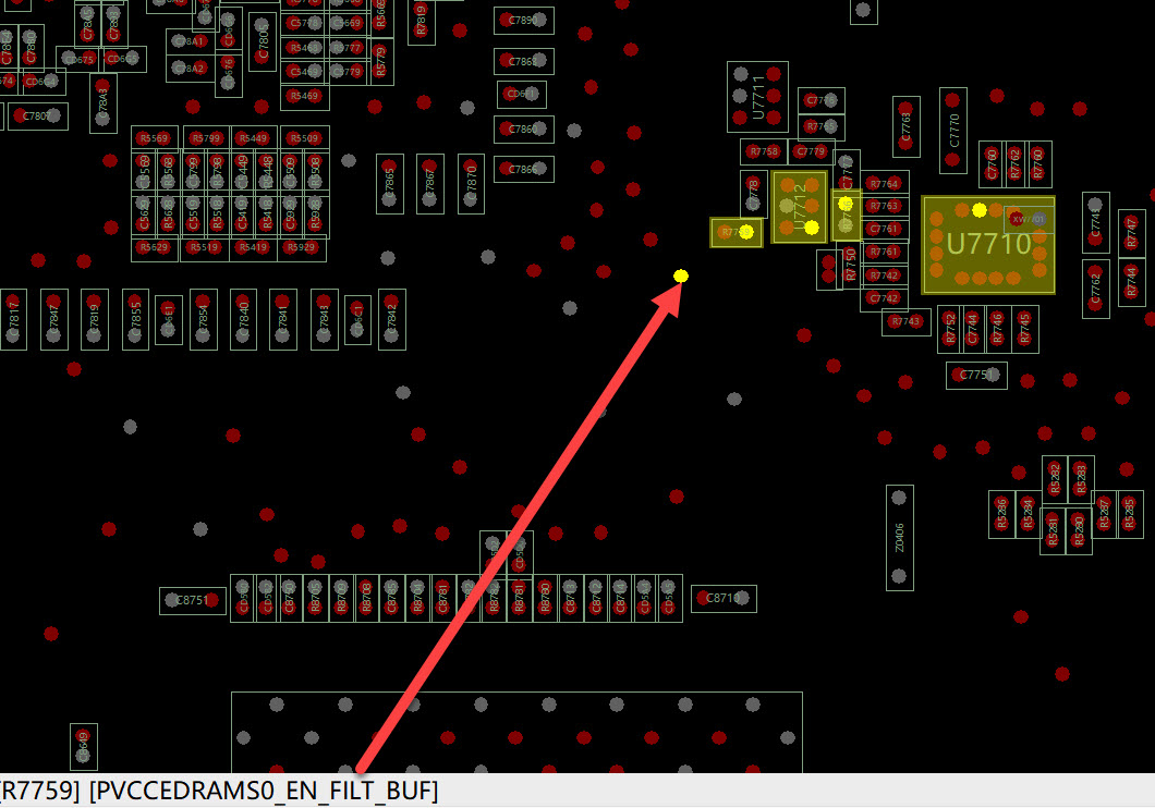

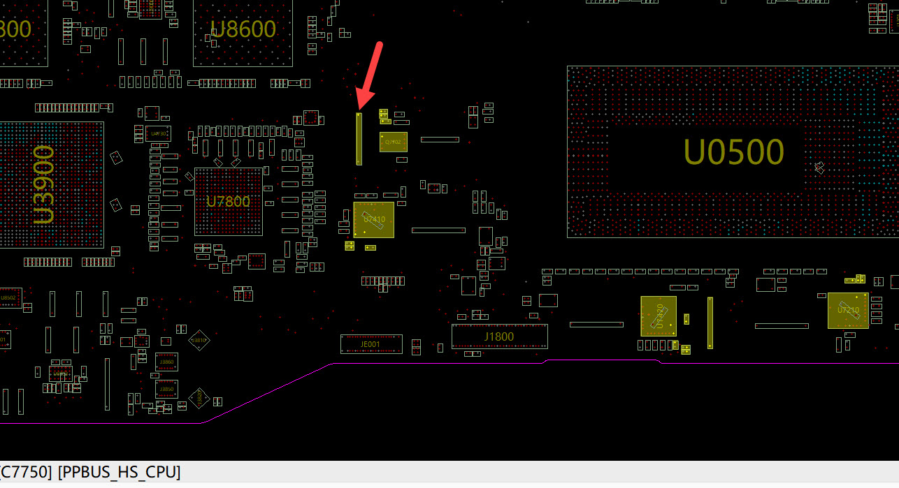

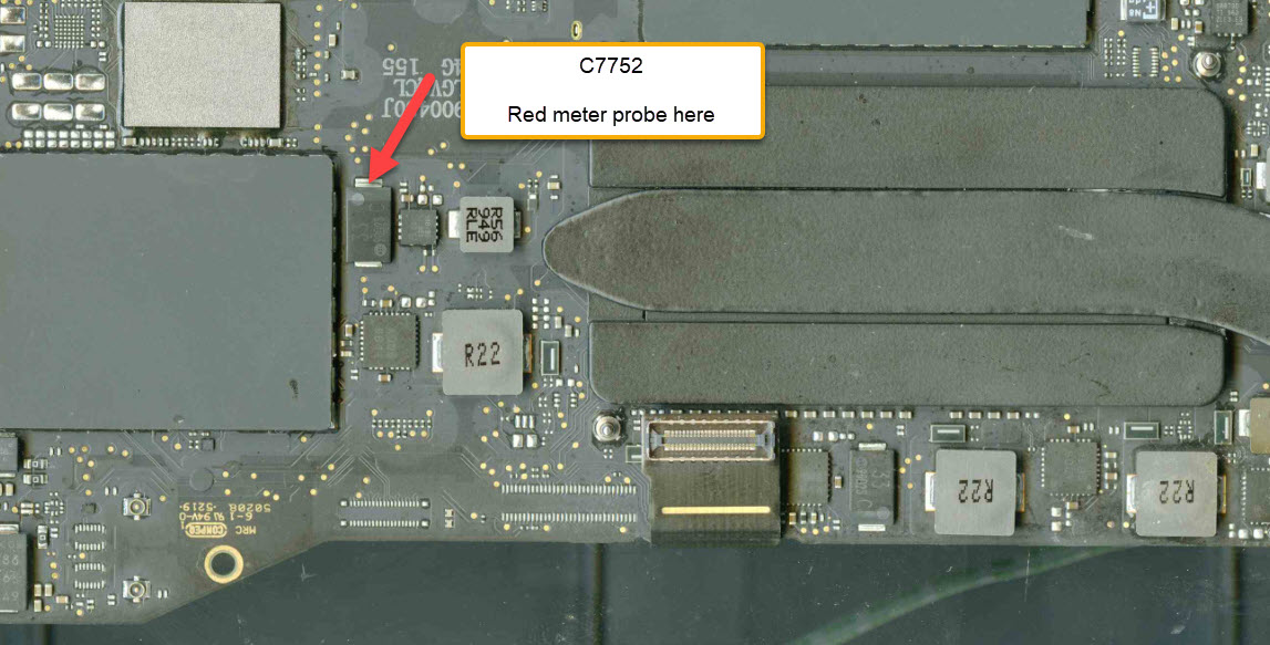

                              Check & post the voltages linked to Q7702 (dual mosfet), pin # 1. You can use one of the capacitors shown in the top right of the schematic.
                              Use C7752 with red meter probe (20v scale) & black meter probe to ground.
                              • mp844
                                • Dec 2021
                                • 21
                                • Poland
                                +12.6V between that cap and GND.

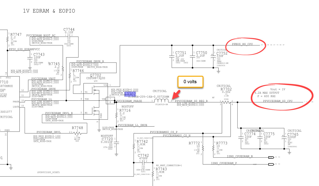

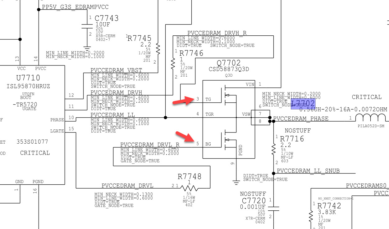

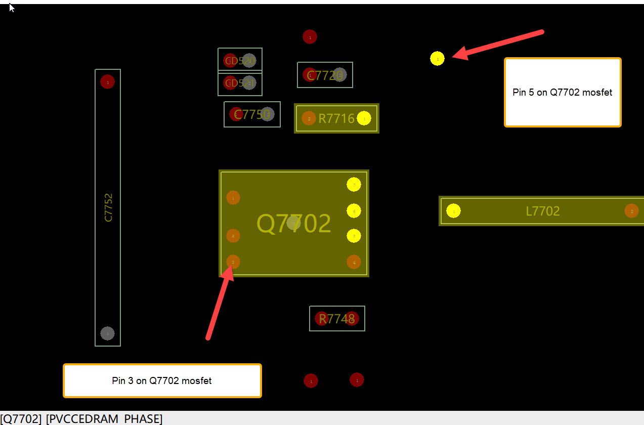

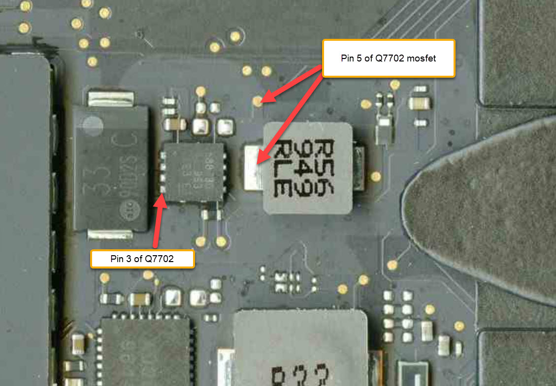

                                  This is a good voltage.
                                  See attached. Measure and post the voltages on the Q7702 mosfet.
                                  Be very careful on measuring pin # 3 on the mosfet with the meter lead.
                                  • mp844
                                    • Dec 2021
                                    • 21
                                    • Poland
                                    Used a needle and a few measurements to be sure;
                                    Pin 3 of Q7702 = constantly fluctuates between -500mV...+200mV with momentary spikes up to 1V
                                    Pin 5 at the inductor/pad = 0V

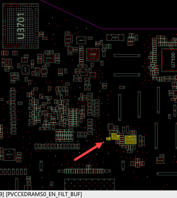

                                    • mon2
                                      • Dec 2019
                                      • 14342
                                      See attached. Measure & post the ENABLE voltage for this switching regulator.
                                      • mp844
                                        • Dec 2021
                                        • 21
                                        • Poland
                                        0V at the pad, about 46kOhms, both in ref to GND.
