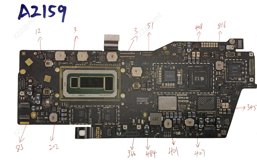

    Remove all power. Do not use the above USB-C dock.
    Meter in DIODE mode. Red meter probe, yes red, to ground.
    Black meter probe to point to test.
    Test each inductor on the board in DIODE mode -> compare the attached chart.
    Post any suspects. Again - no power / no battery to the board in diode mode testing.

      The USB-C dock and monitor are separate devices used for testing because I initially thought the display was defective due to a crack on the lower right corner.
      WD15 docking station: is capable of outputting 19.5V/3.34A
      Dell P2419HC: has built-in power delivery, capable of outputting 20V/3.25A
      Both devices work on all other Macs and laptops.

        I don't have much experience... what should I be looking for? I posted my results in my last post but this method of testing is new to me
