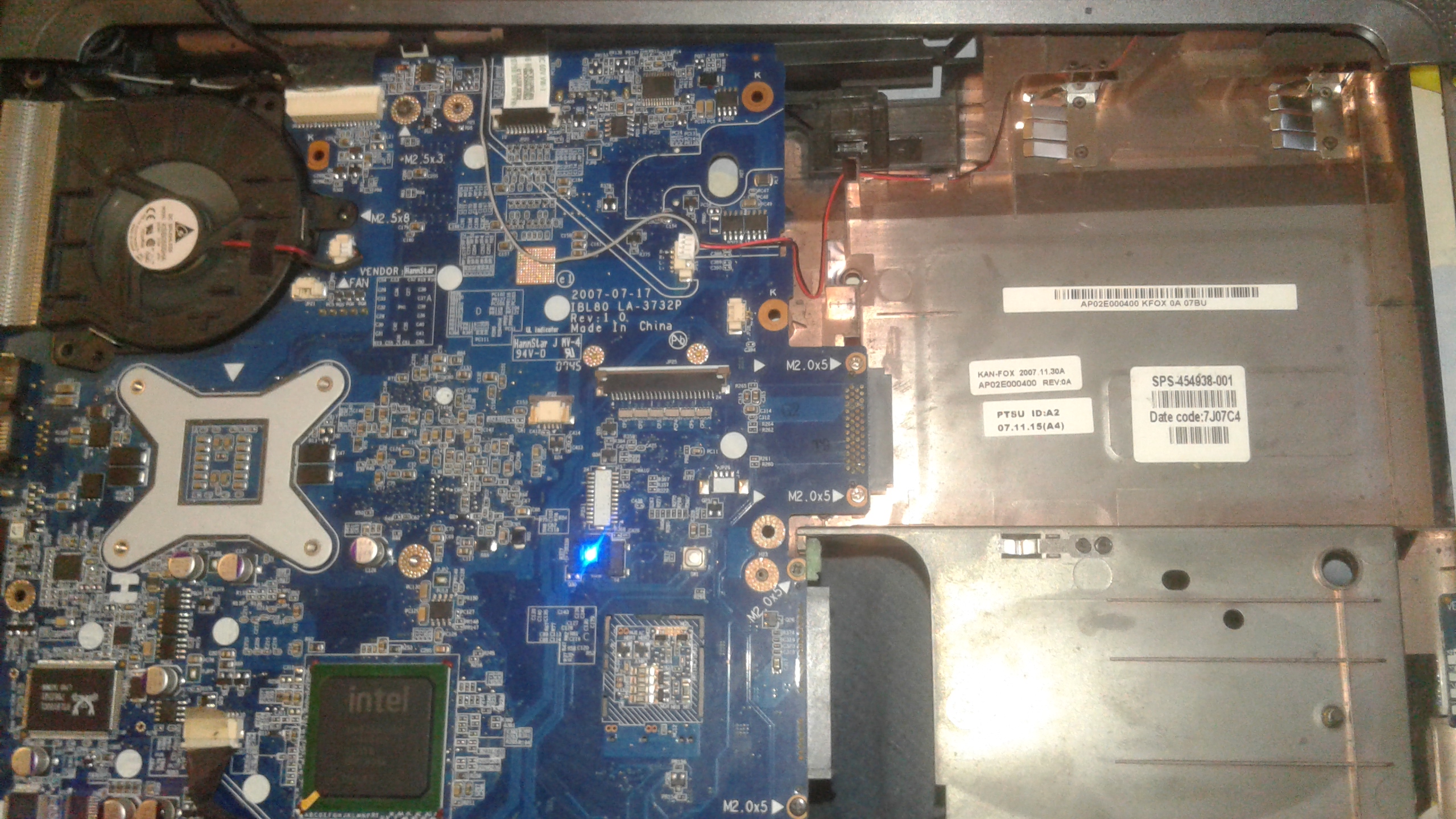

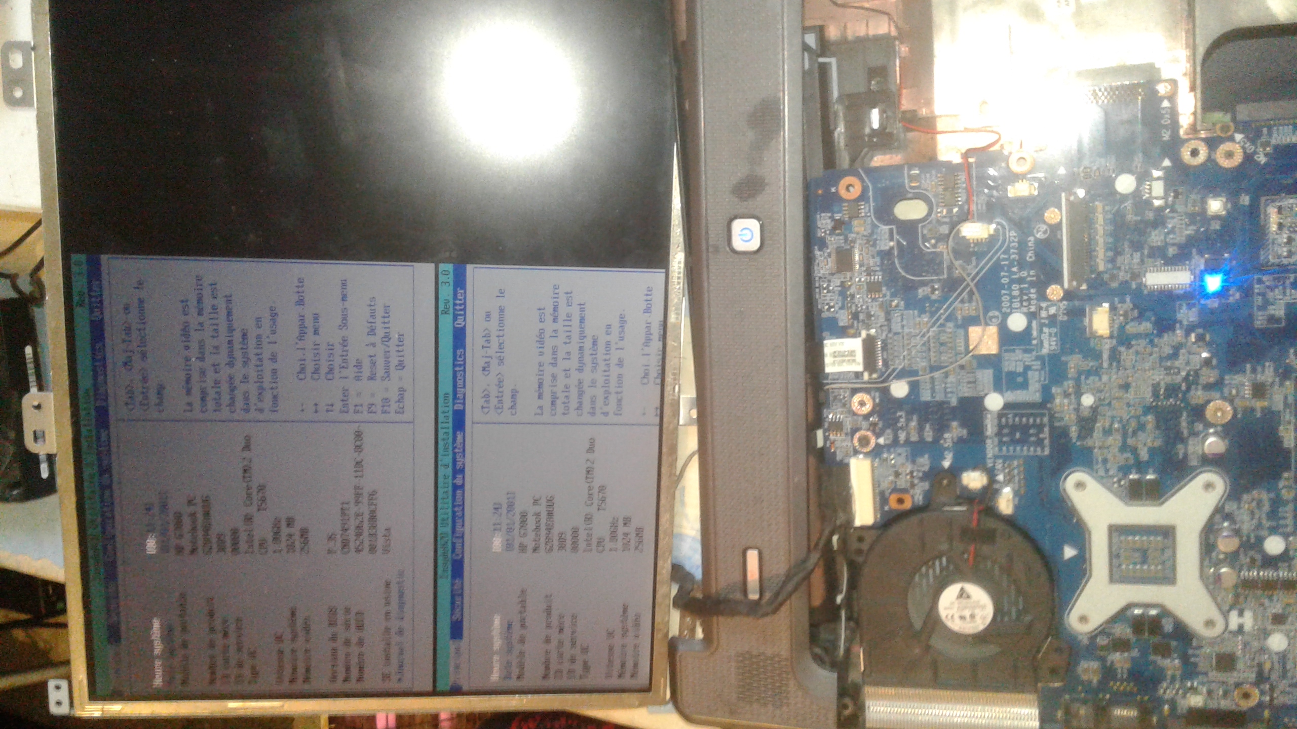

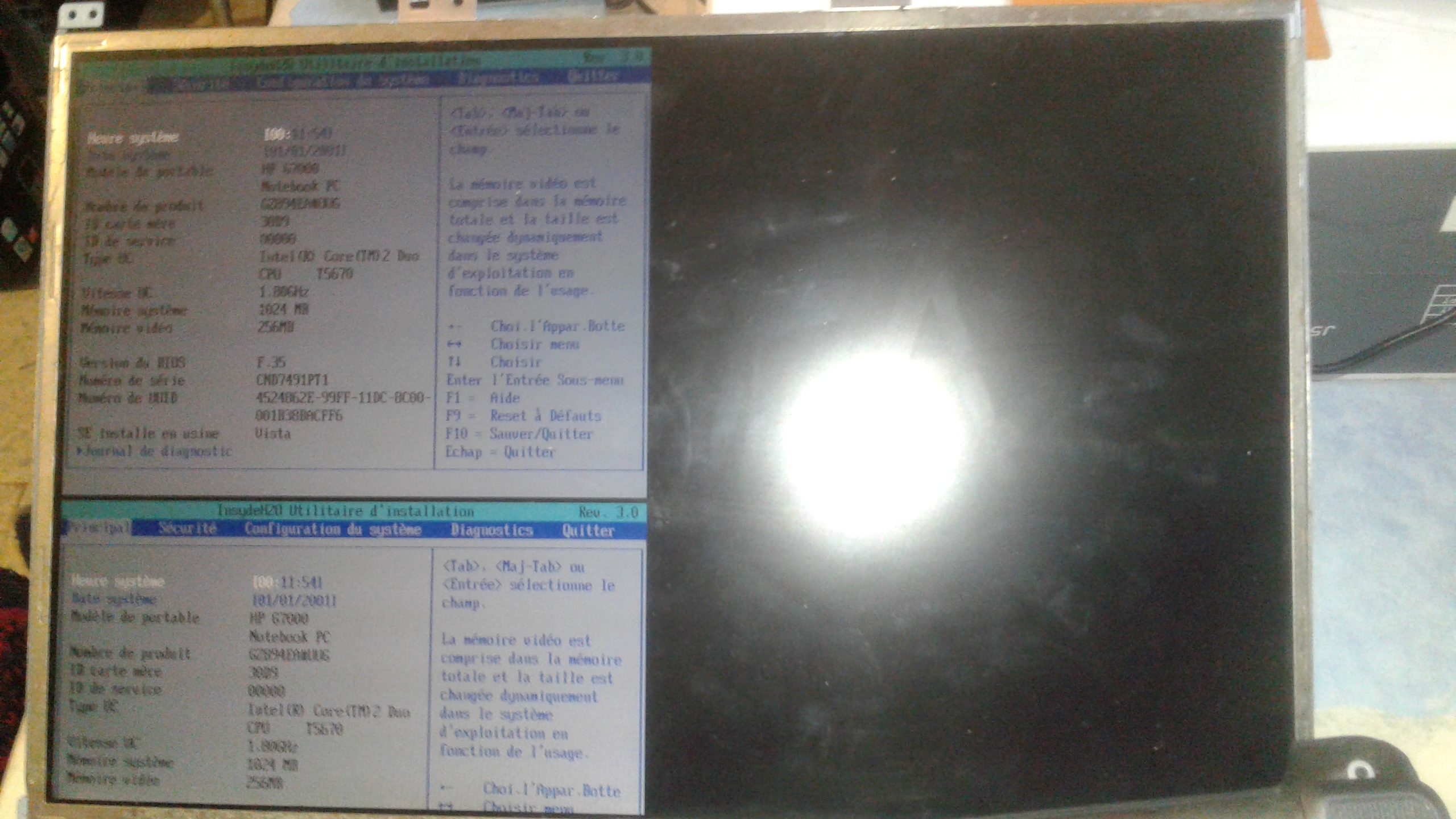

    I need to know what can cause the screen to be split into 2 for a hp g7000??
    the screen cable seems to be good and not damaged .
    I changed the screen with no result.
    The external vga port is functionning normaly.
    I also tried another memory card.

        The screen cable may seems good but it has broken wires inside. Replace the lvds cable and see your problem resolved.
        • ramzi2019
          • Apr 2019
          • 56
          • tunisia
          Re: HP G7000 laptop screen split into 2
          Thanks for your precious help.
          That was right, some wires of the lvds cable was broken and I successfully repaired it.
