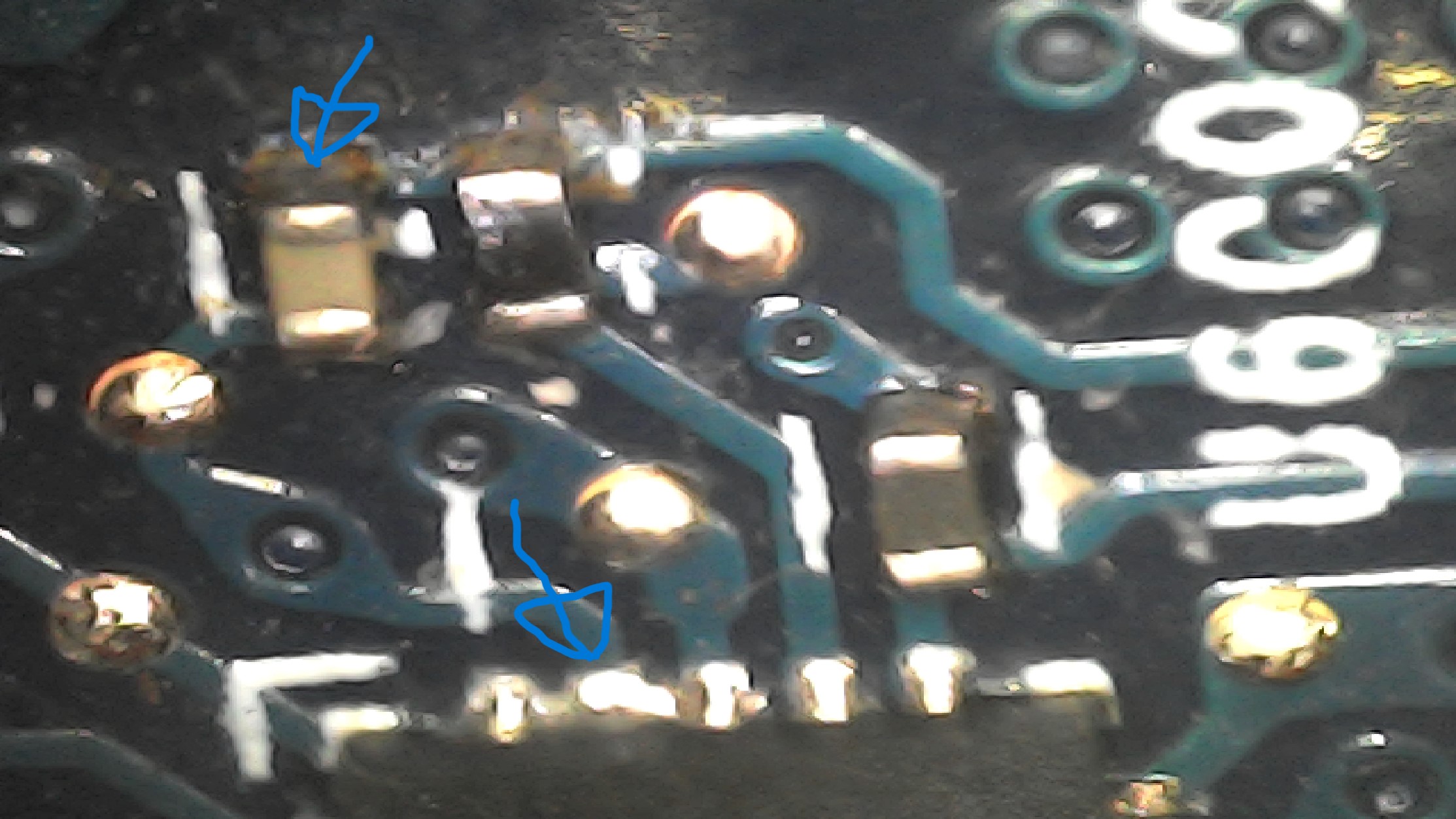

      Yes, you where right. I measured on wrong side but i measured where you told now and no 6 v. And its 141k ohms on that resistor. I send picture with where i m measuring. And when i measure on the resistor ends i get 1,212M ohms ond when i change the probes i get 0,369M ohms

        I think you are still on the wrong pin and component. The mustard colored part is a capacitor. The majority of the mfrs will use this color for smd caps and black for resistors. So for example, the part to the right of the cap is the resistor.
        Better if you post a pic that will show the entire device. The camera is not very clear.
        Is this with your phone or a microscope? Otherwise, try with a phone camera.

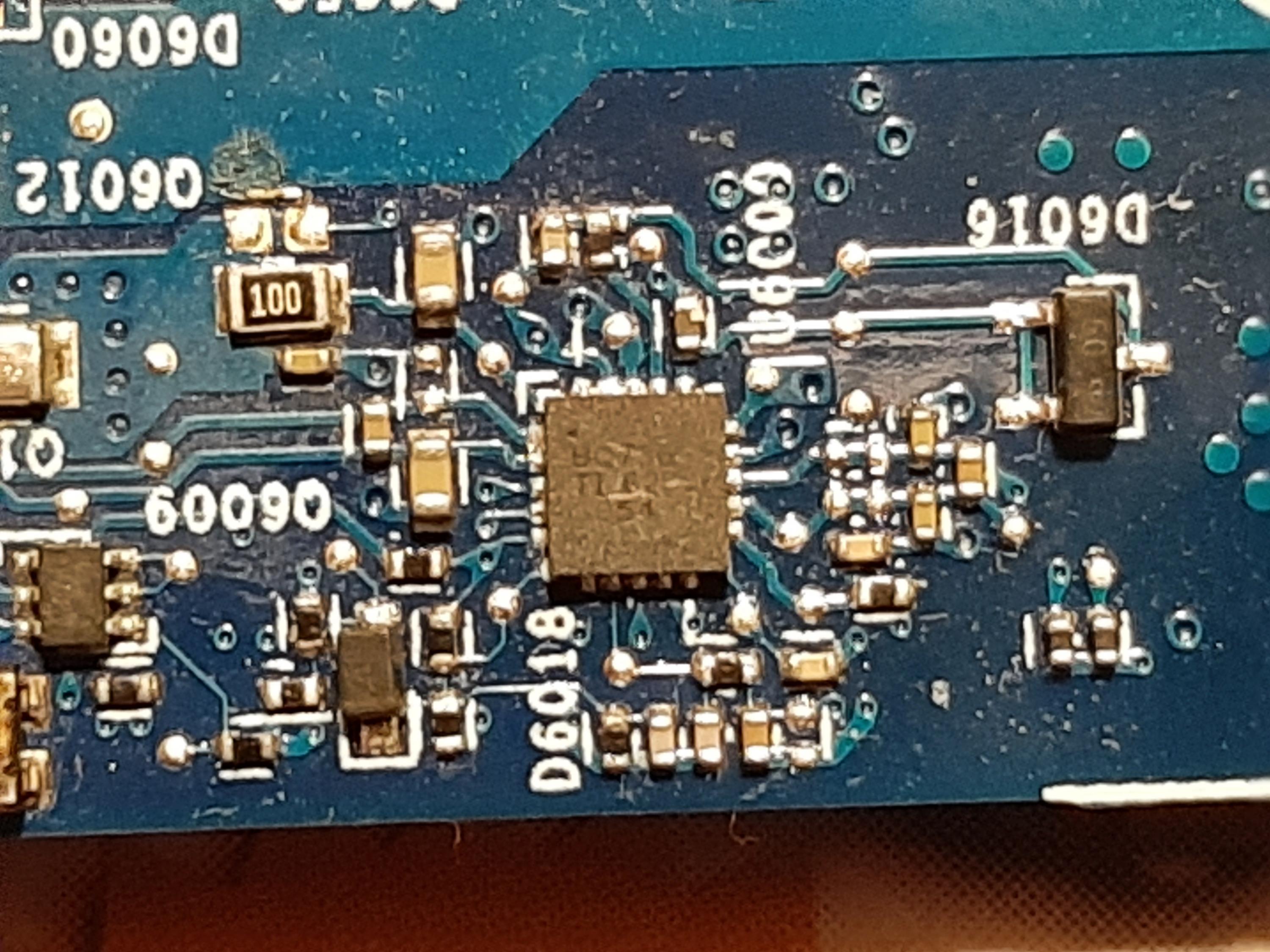

          Its an cheap microscope. I will post the entire chip with components around taken with camera.
            #45
            Re: HP EliteBook 840 G4 charging problem
            Ok. Remove all power. Meter in diode mode. Touch the meter probes. The meter should tone beep. Now you one meter probe to pin #20 on the charger IC. This is the most left solder pad on the top left side of the chip. Other meter probe to the large resistor marked '100' which is the 10 ohm series resistor. Do you hear a tone beep? Remember, no power to the logic board for these tests.

                  No, never jump anything till all details are known. If the mosfet was truly not required, the vendor would have done the same to save on manufacturing costs.
                  He is simply bypassing the DCin mosfets to force the power path onto the logic board. Rather, the mosfets should turn on naturally by way of a boosted gate voltage of ~25v. This voltage is only possible if the charger IC is being powered and is not damaged.
                  Still with no power, measure the resistance across this resistor marked '100'. It should be around 10 ohms.
                  Configure the meter into dc volts mode (20v or higher). Connect the power adapter. Carefully measure the voltage to ground on each side of this same resistor.

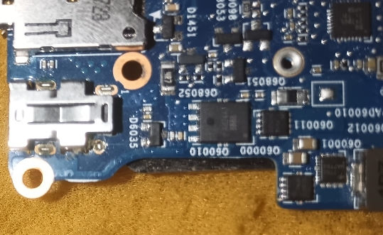

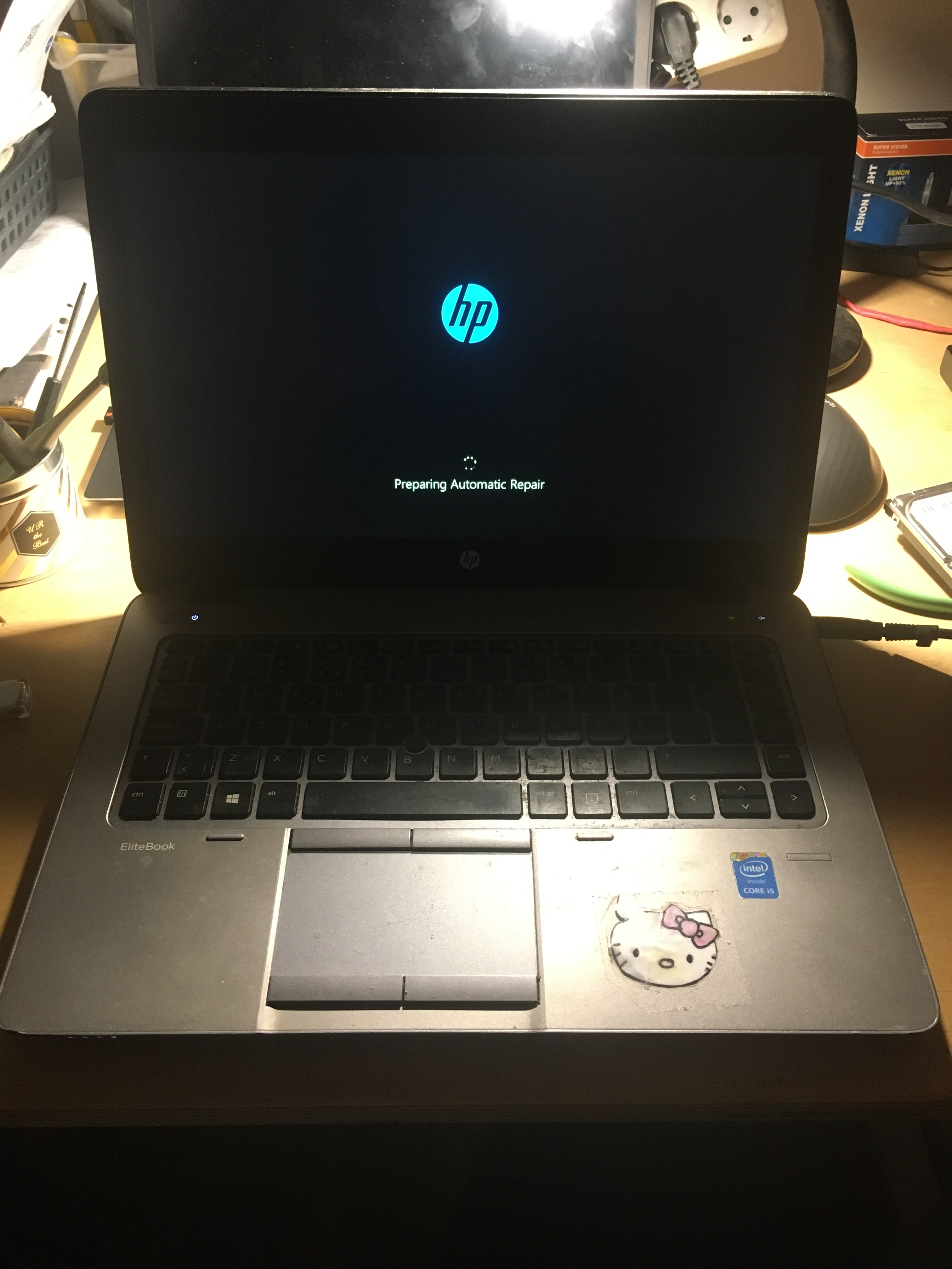

                      I was try to jumpwire it before i got your message. i have no patientce. i did it with solderingiron and now it starts. of course i took of the jumpwire or it newer fastened good. so i had to put much heat on board.. i will try to assamble it and see if screen starts and so.. ??? i dont get it. must have been old waterdamage what mad it corossion the Q6010 and what now got soldered again..
                        #51

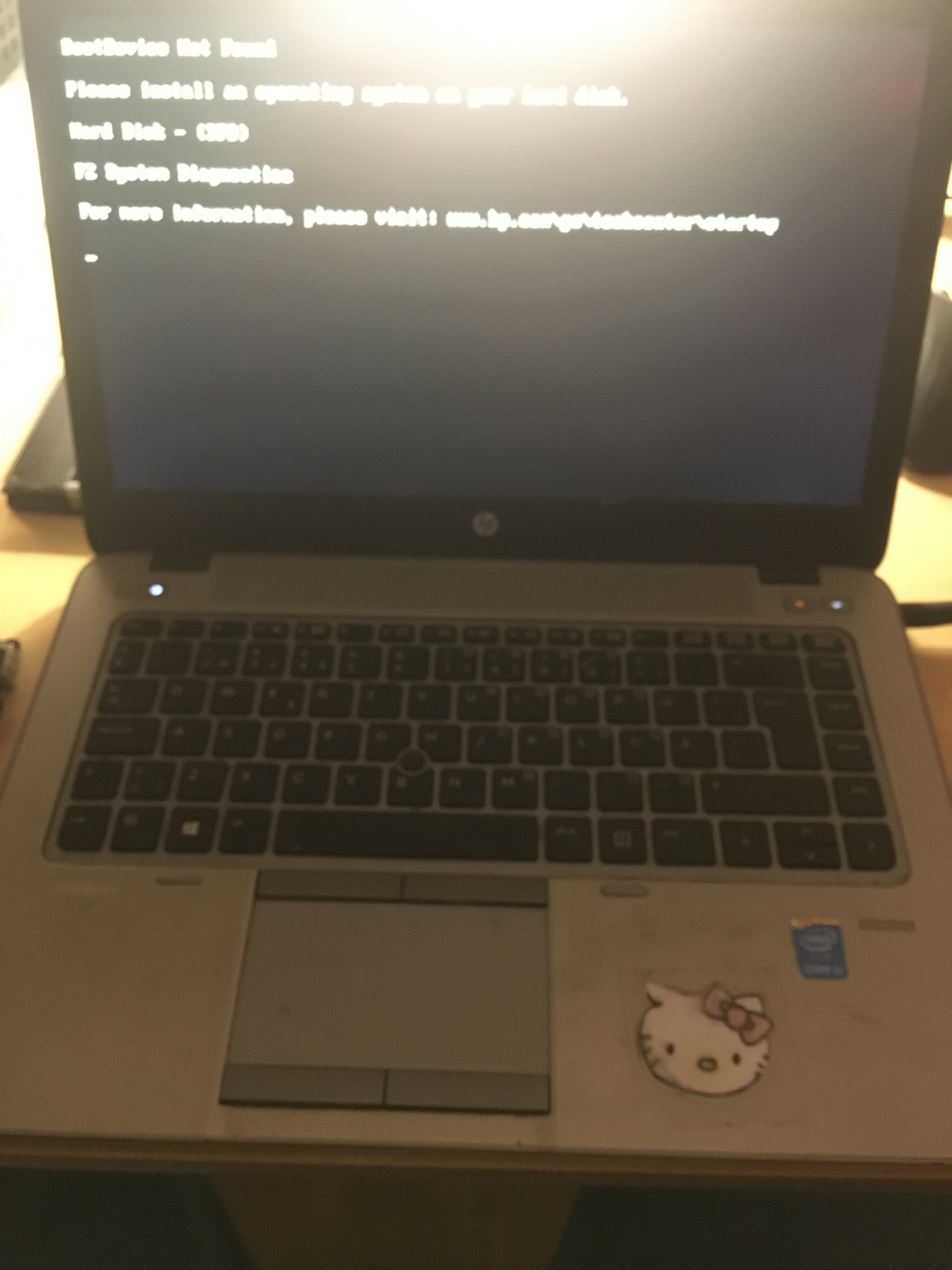

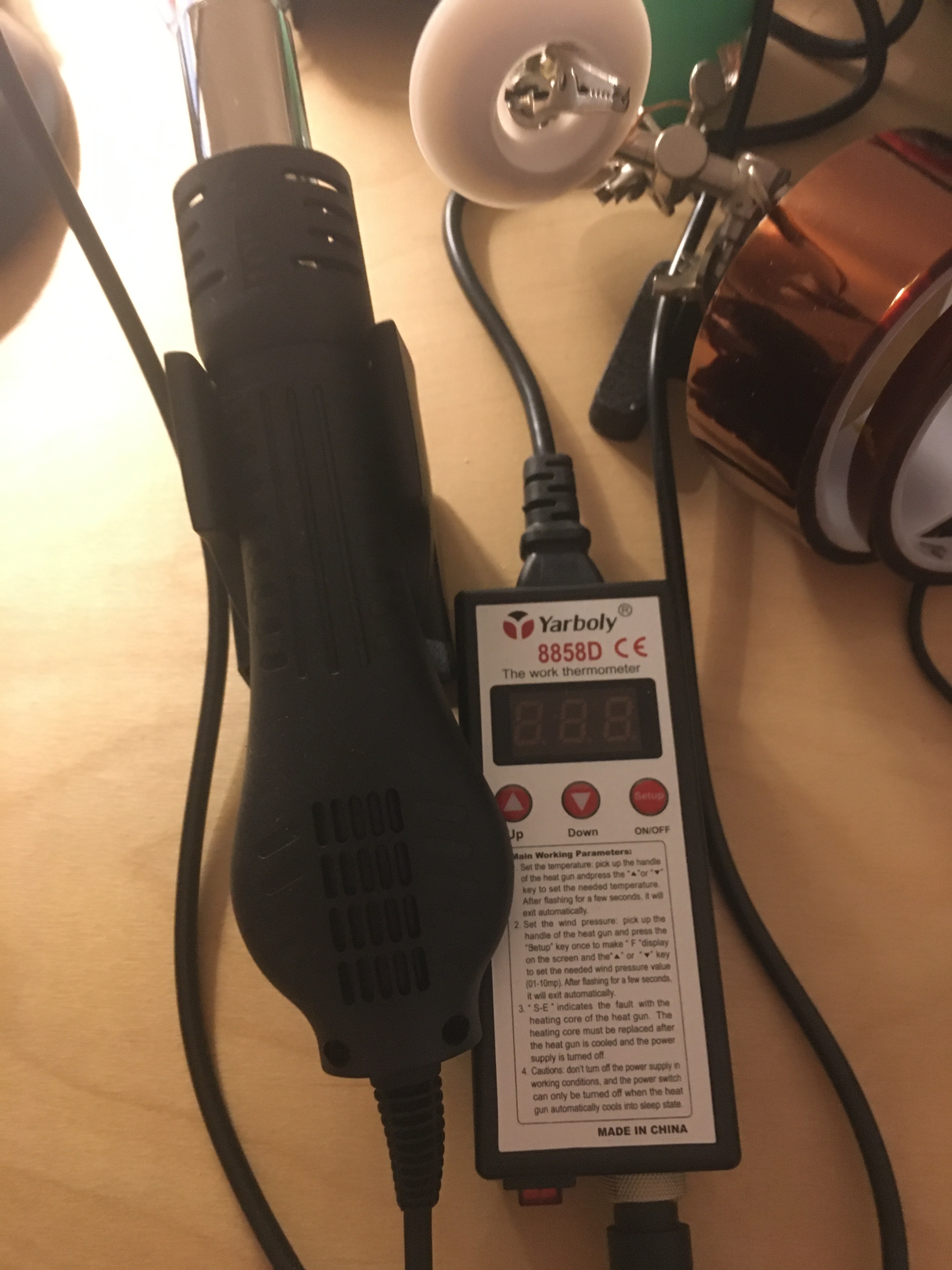

                        Hello. After a long time without tools! I finely got an hot-air-station and could sold the chip what i get an long time ago. So the laptop is working now. Without the small capasitor 😅. Just needs an hard drive Thanks help from Mon2.. Thanks

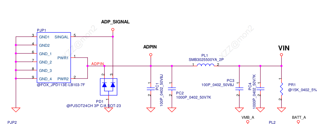

                            I attached the schematic which is the same for charging. LINK to schematic - https://www.badcaps.net/forum/troubl...0-g1-schematic

                              Share the voltage to ground of ACDET pin # 6 on the charger IC @ U6000. Carefully measure the voltage directly on this charger IC pin.
                              Have the laptop powered ON to measure this voltage.
                              Then laptop off and measure the voltage again.
                              Be sure that the power adapter is the original and with the recommended power rating for this model.

                                When I measured On = 3.66v
                                When I measured Off = 2.67v
                                I use only HP power adapter 90w and 120w (90w needs the NB).
                                I found the R6030 was faulty and now it is charging....
