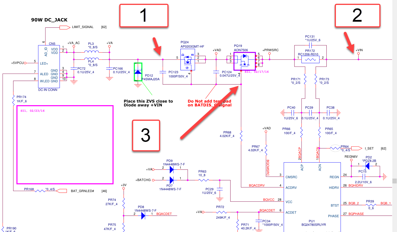

    Which PIN is showing a short to ground ? How was this tested ? Resistance mode on your meter? Which scale ? CPU rails often show this condition.

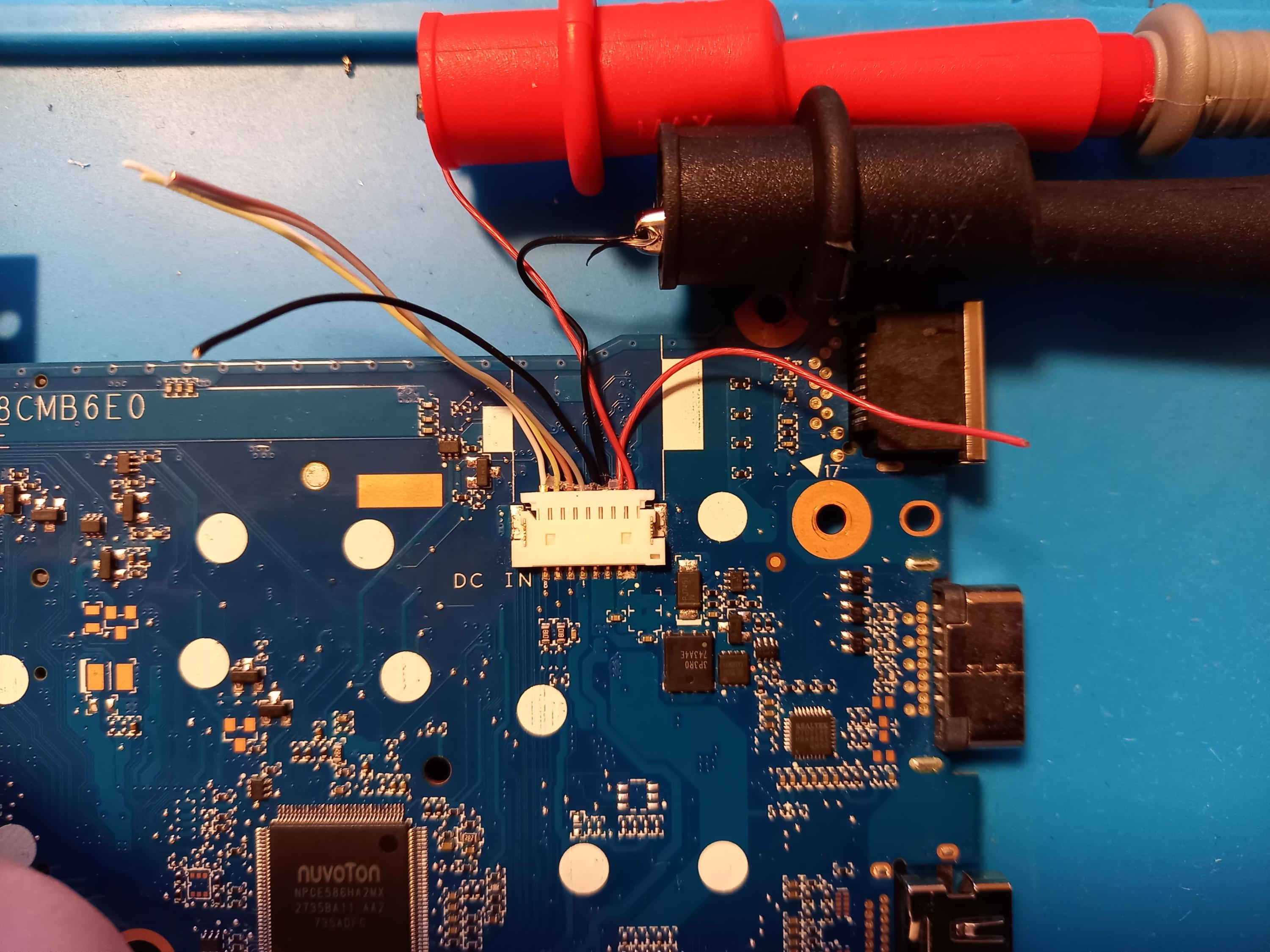

    Where is the lab power supply being attached ? Is it at the DCIN of the laptop ?
    See attached.
    Post the voltage readings (DC voltage scale; 20V or higher is ok) for the requested locations.
    Red meter lead on the test point; Black meter lead to ground (shield is OK).
    Next, remove all power. Meter in resistance mode.
    Check & post the resistance to ground for the +VIN rail. A very low resistance will indicate a shorted cap on the leg which is causing the power supply to shut off. It is very possible the whining you are hearing is the oscillation of the power supply turning ON (detecting the short condition) -> then turning OFF. Much like a buzzer circuit which is causing an audible buzzing / whining sound.

        Hi Mon,
        thanks for the feedback. Here the picture of the power supply being attached. I had a old DC IN Connector, i should not be a problem or?

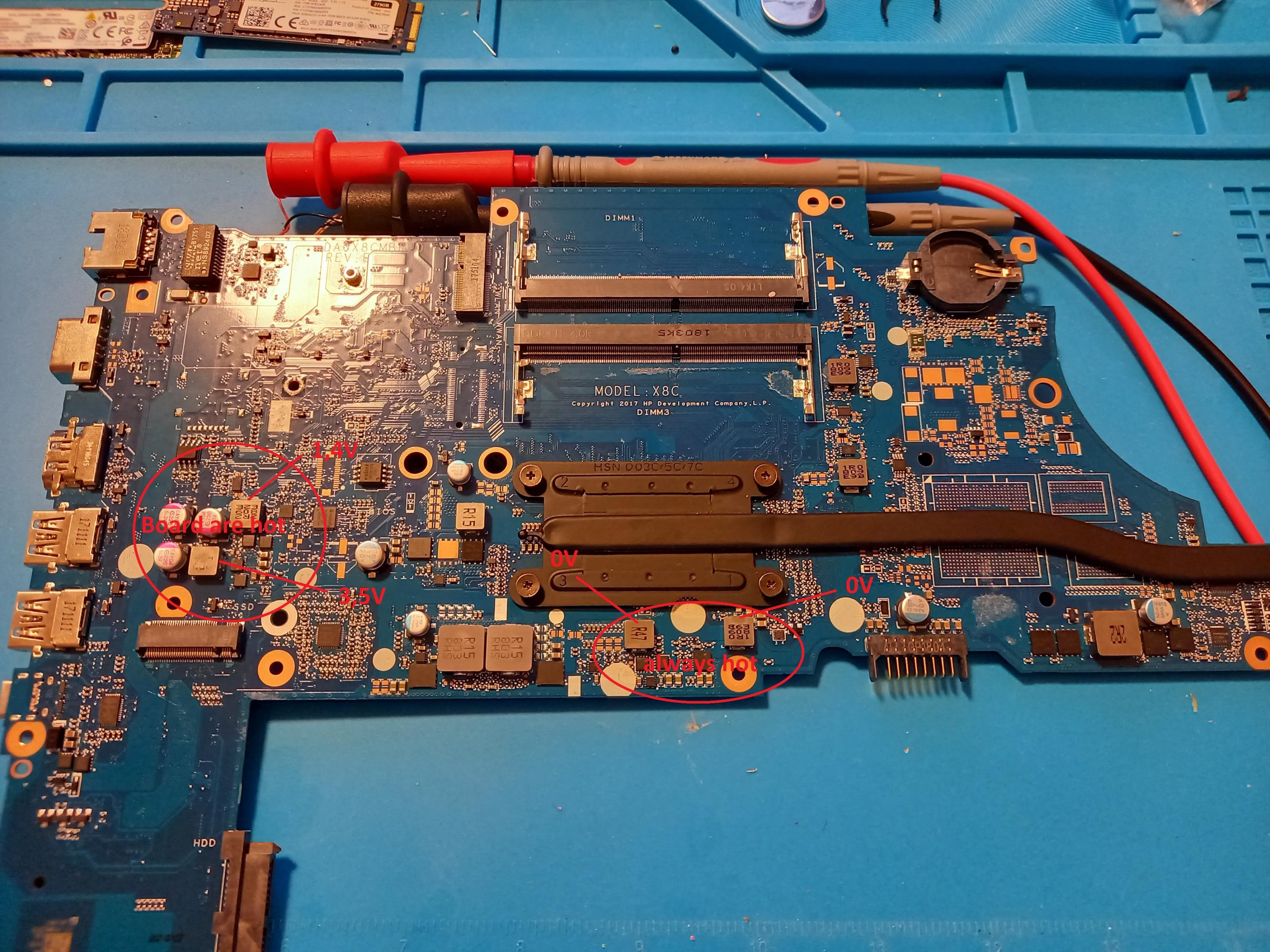

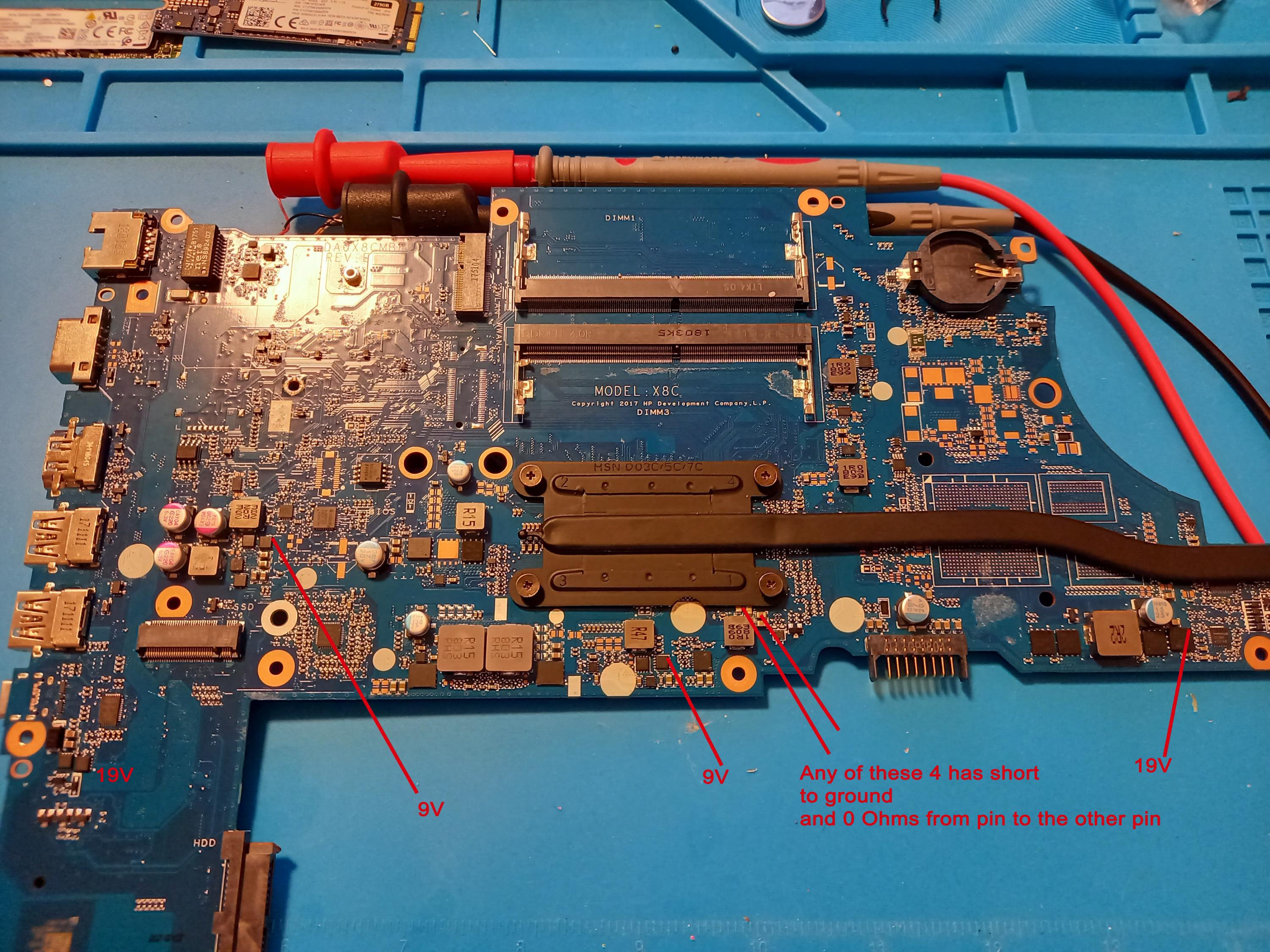

          Re: HP Probook 450 G5 DA0X8CMB6E0 Rev. E short circuit
          i have news, as anybody a idee. At the Beginning Power Supply Mosfet i have the 19V present. But not on every Mosfet 19V. I have Mosfet that have only 9V where i lost around the 10V?
          I attached a Picture. Has anybody a idee? The Mainboard always has 1A usage, no matter to the Voltage, always 1A ?
          The 4 Capacitors in the Picture, has short to Ground (0Ohm every side to ground). 0Ohm between the pads???
          Thanks.
