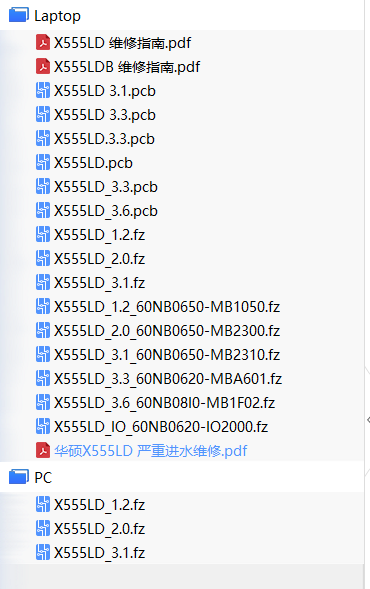

          • mon2
            • Dec 2019
            • 14521
            Re: no backlight asus x55ld
            What is the model of your logic board ?
            See attached.
            No schematics available but we may have boardview files.
            Do you have a multimeter & hot air soldering tools ?
              See attached.
              i all ready cheked the boradview and i have multimiter and hot air on the on ac bat-sys with battrey 7.94v and when plug charger i have 19v
                  what is the model of your logic board ?
                  thanks for your time probleme solved by changing the screen
