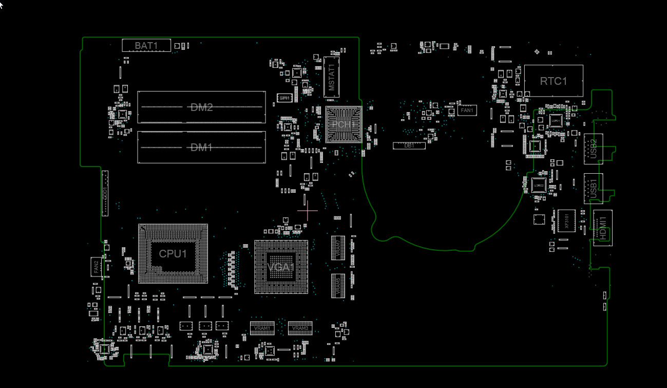

    4) Does your logic board look like the attached ?

      acer predator g9-791g. Sadly i dont have schematics. p5ncn/p7ncn main board rev: 2.0

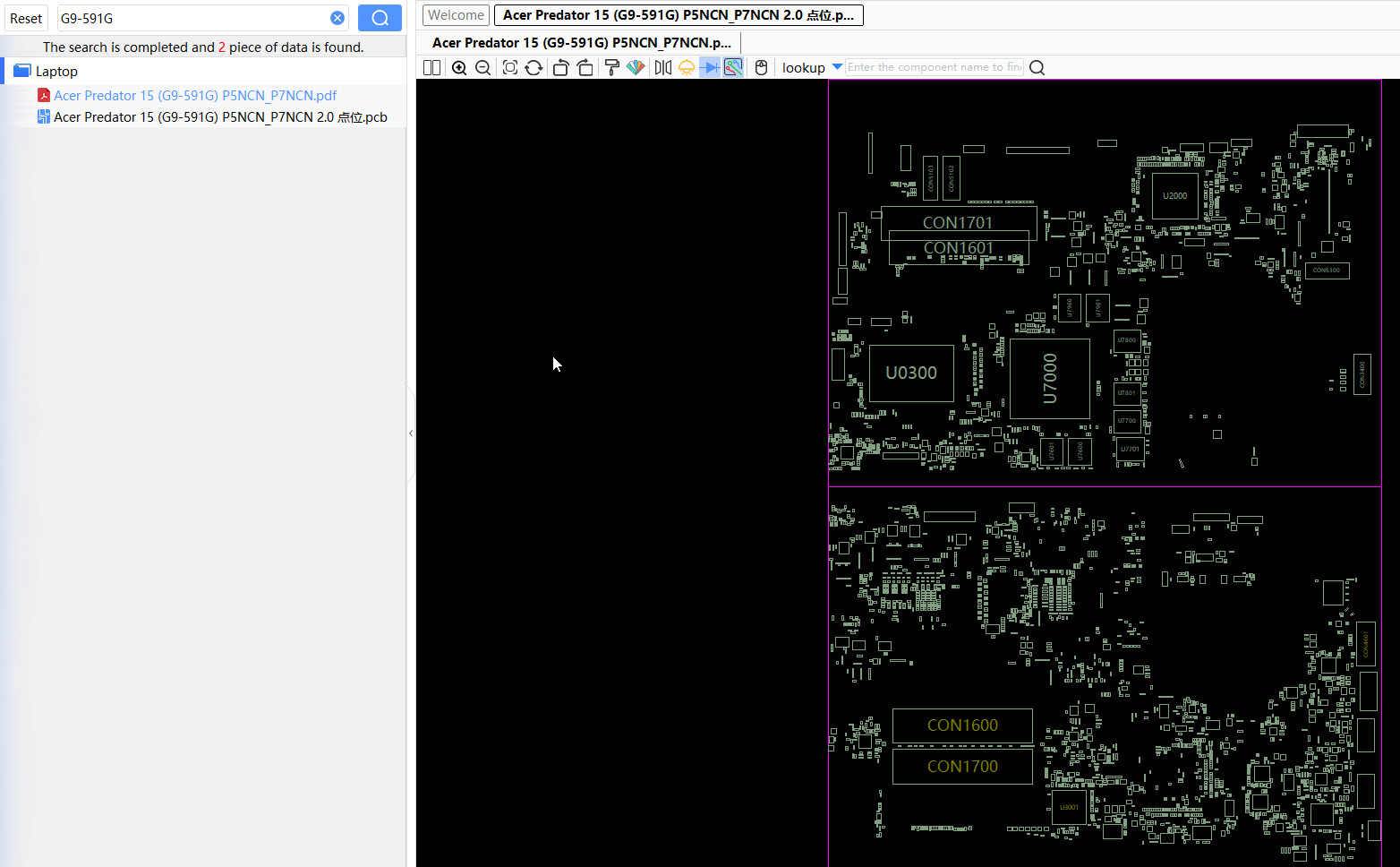

        Schematic,revision 1 but should be ok https://www.badcaps.net/forum/showthread.php?t=82221
        Edit: and a boardview https://www.badcaps.net/forum/showpo...75&postcount=6

          Ok. Found the version 1.0 schematic in the database and perhaps v2.0 of the boardview file.
          Does the attached look the same as yours ?
          It is tied to the encrypted viewer that does not allow for saving so cannot share.

              strange that 17 and 15 inch models share identical boards. as its pretty accurate to mine
