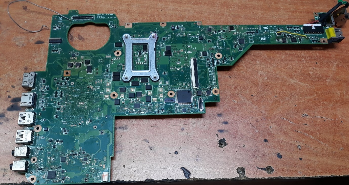

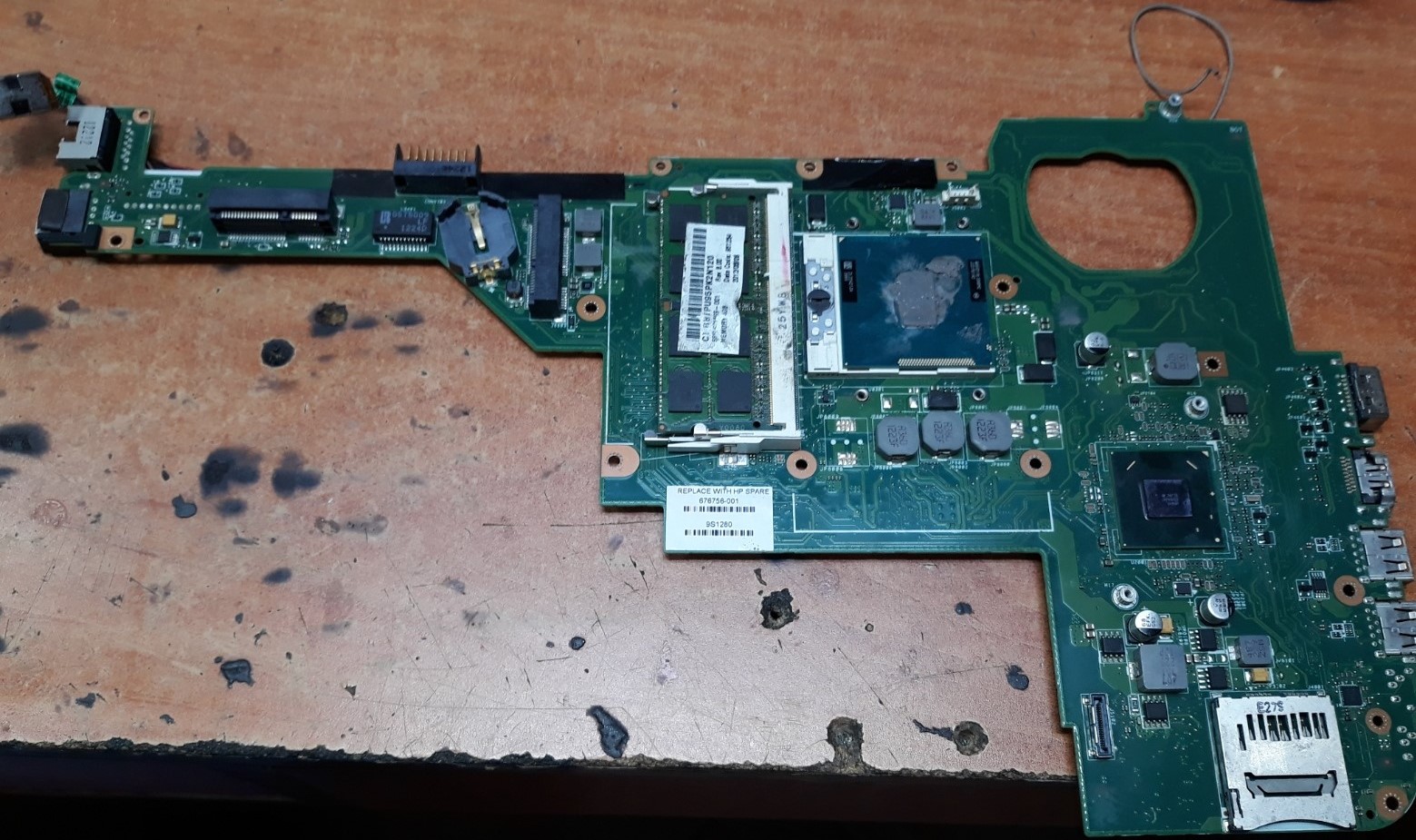

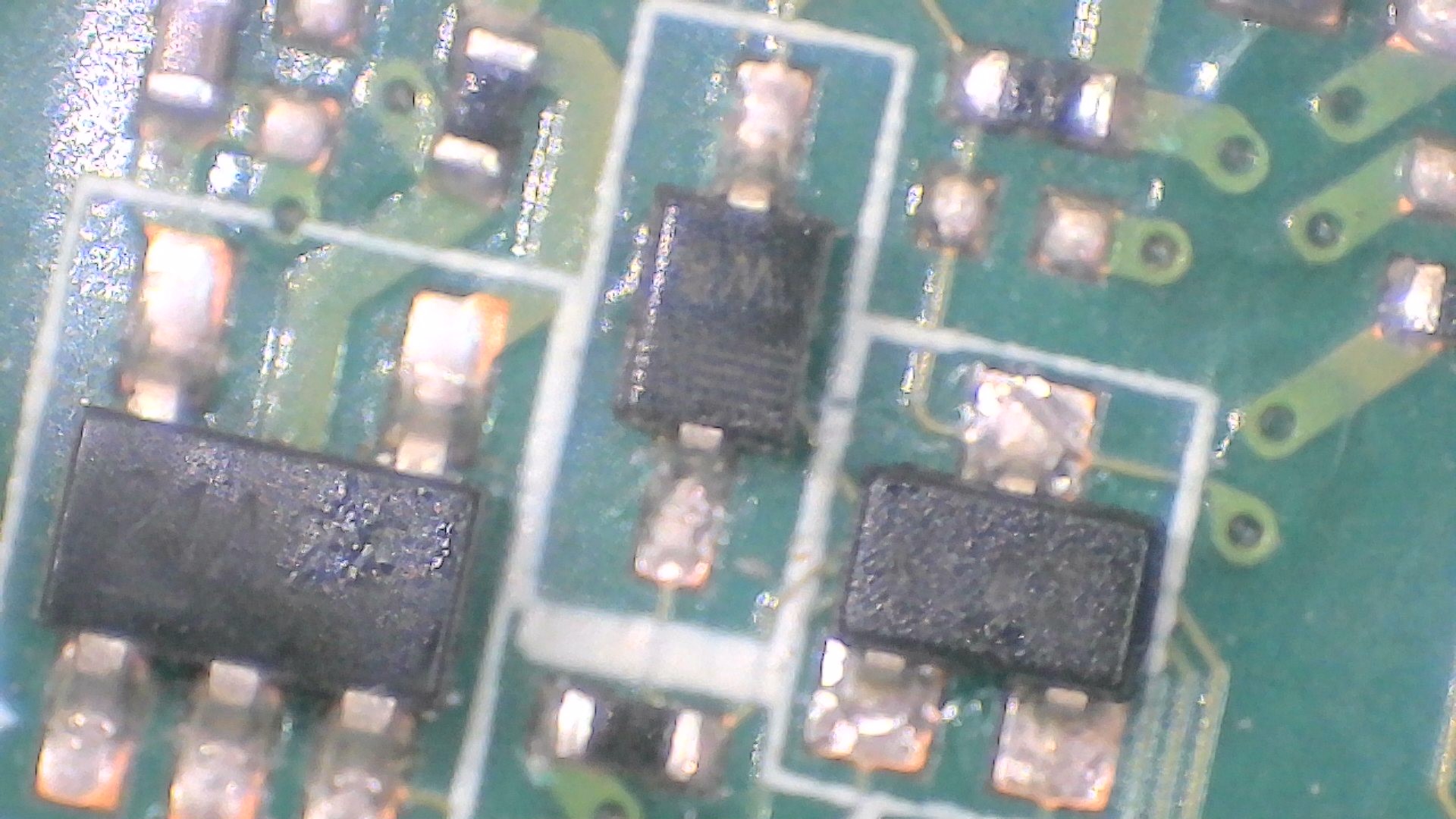

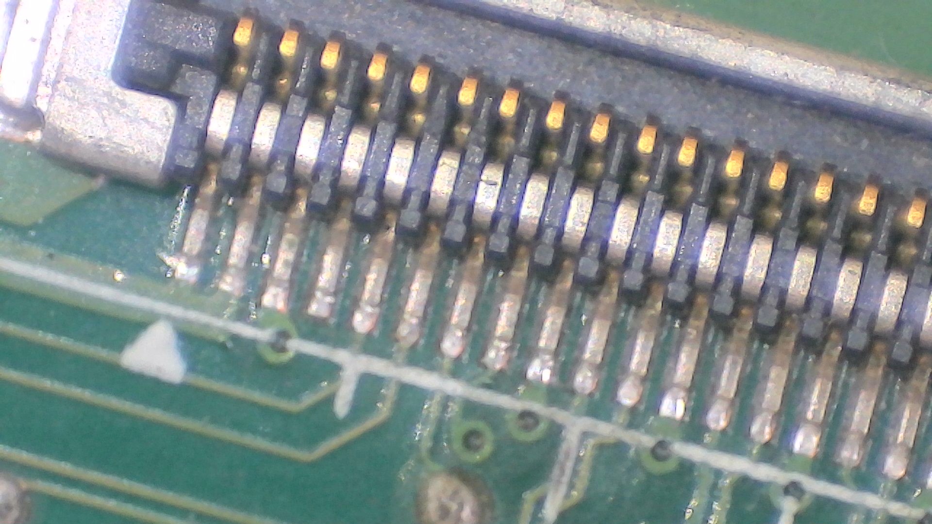

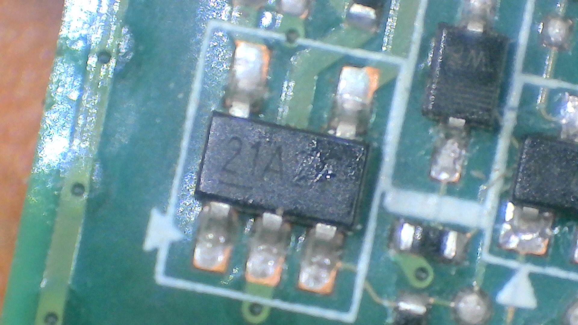

    Good evening! I am working with a hp wsnu main boad rev motherboard. 2.1. Previously it did not turn on, replacing a 30v n channel mosfet according to a data sheet now it turns on But now the problem is that I do not have a backlight, in the lvds 1,2 connector it only activates 3v, I do not have the schematic and I have been guessing the connections .. Any help solving my problem .. Thanks..

    Post all markings on the logic board.

      Re: Hp dv4-5000 wsnu No Backlight
      Well, I attach full photos. Thanks

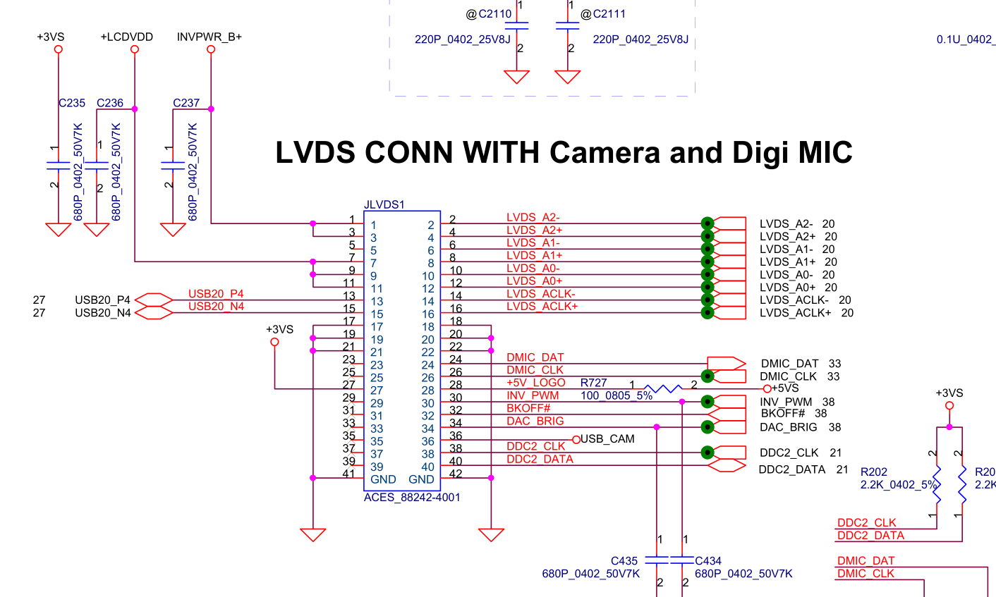

        According to this webpage:
        https://www.laptopschematic.com/hp-p...agramdiscrete/
        see the reference to logic board # LA-4102P for the HP DV4.
        Based on this detail, see attached. It may match your LVDS connector pinout.
        Check the ground pins and see if there are bridged like the attached for your logic board. Then check the power rails, etc.
        Post your updates.
