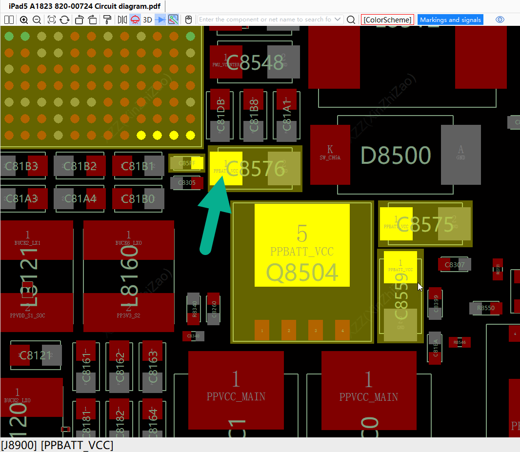

                                No issue here. With your meter in DC volts scale (10 volts or higher is ok); measure the voltage to ground of PPBATT_VCC. You can probably do this by probing (carefully) C8576 (pin #1).
                                See attached. Red probe here and black probe to a ground (shield is ok). Do this after you connect the external USB power adapter to this logic board. If all is well, you should have a charge voltage here to charge the battery.

                                  I get no voltage on Q8504-5 nor I get any voltage in Q8504-"123". If (big if) I intreper the schemas correct in 123 there is the PPVCC_MAIN ( tho can't figure out where this one is being fed ) which the Q8504 somehow regulates to charge the battery via Q8504-5 (PPBAT_VCC). Currently the logic board is out of the chassy (so no battery connected) and run by external USB power. Should I repeat the previous voltage test with the battery connected?
