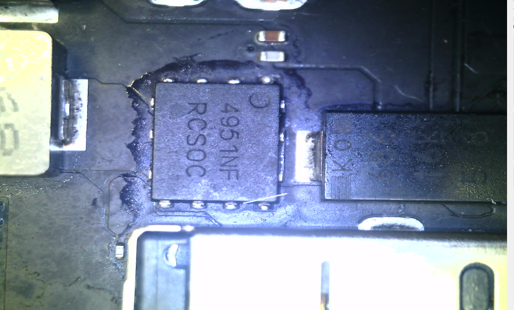

                  Hi, just an update.
                  Q7630 does seem to be defective. It is a dual N channel power mosfet. First channel has a voltage drop of .454v D-S and open S-D and high resistance . Second channel has voltage drop .053v D-S and .039v S-D and 60-70 ohm resistance both ways.
                  So I guess next steps would be to source a replacement for it and U7600 as I read somewhere a damaged mosfet can damage the IC. Q7630 is a NTMFD4951NF but that part number does not come up to buy. I read that any 2 channel mosfet with the same form factor would be ok (cannot find that post now atm) but ISL95870 seems just as hard to come by.
                  Other option I am following up on is to get a suitably priced donor board that has both components so I am keeping an eye on FB Market Place and ebay. Once I source something and hopefully manage to replace them I will post an update.

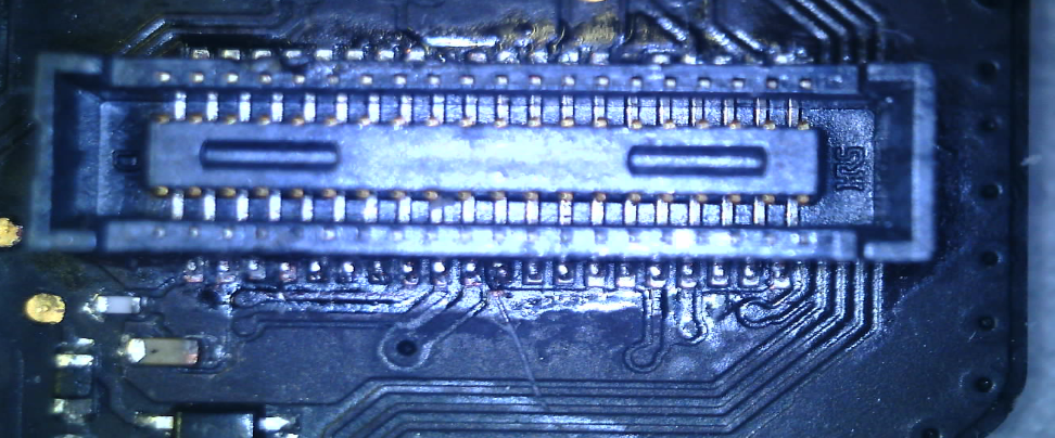

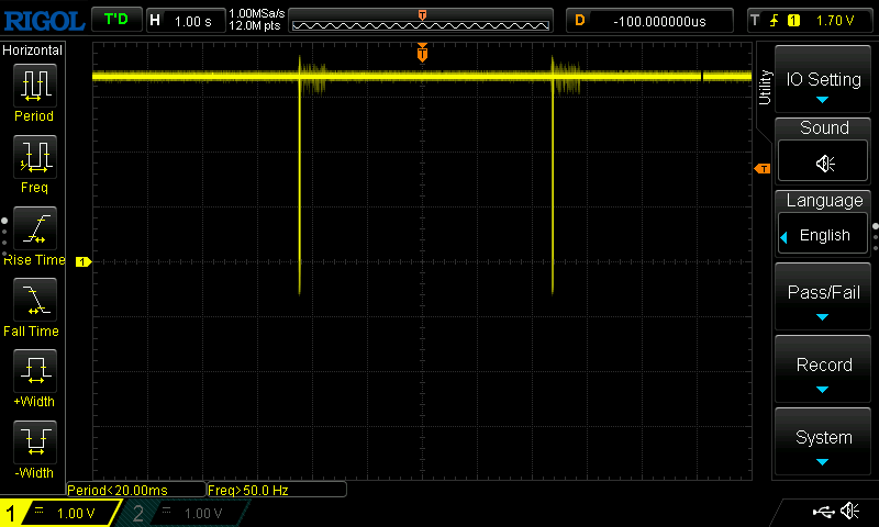

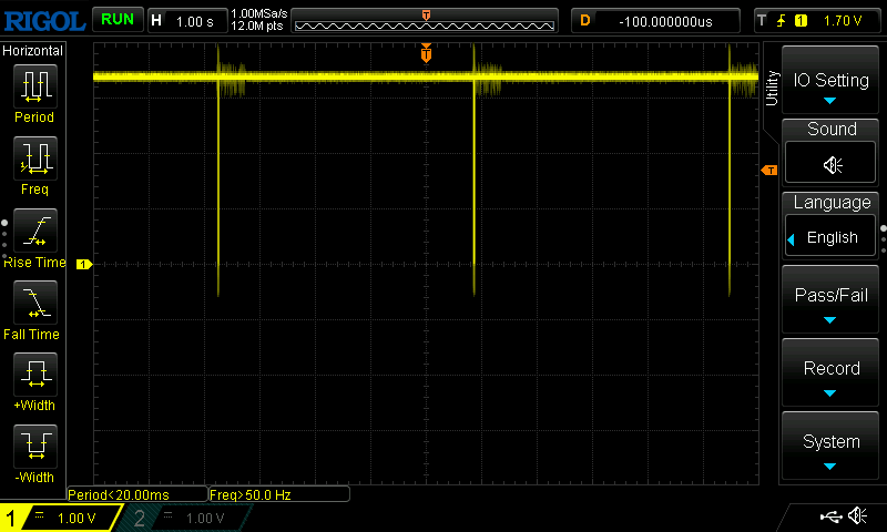

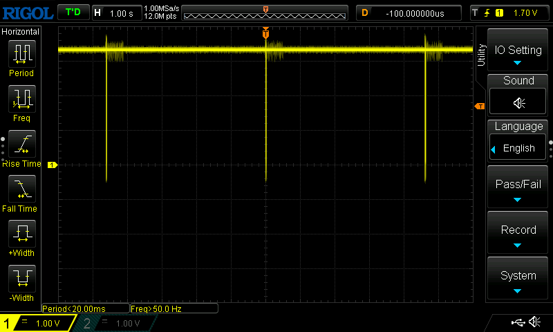

                                Back to this board again.
                                Not sure whether there are voltage oscillations on pins 1 & 2 of U6100 - there is a spike each time the board cycles - I have attached 3 screen prints for pins 1 - 3 which all look similar. My scope has SPI but is 2 channel so can only decode one at a time and cannot use CS. I set it up on pin 2 SPI_MLB_IO1_MISO on channel 1 and pin 6 SPI_MLB_CLK on channel 2 (first time doing this so hoping that is correct) with a timeout of 2.2us but there is no decoding - just a flat line on MISO[HEX] and some spiking on the 2 channels, I guess due to the clk signal cycling. Not sure if that is due to their being no comms on MISO or more likely my setup so I will do some more research on how to do it.
                                Is it odd that on U6100 that SPI_MLB_IO1_MISO is not power cycling but SPI_MLB_IO0_MOSI is.
                                I had a close look at the traces around U6100 and there is no corrosion and there is continuity to the components around it.
                                I have been checking the PG signals and most are either cycling or constant - but CPU_PWRGD is 0v - with nothing at all even on the scope from power on. I am not able to find any info that says exactly what this means - ie, is it indicating that vcore is not stable which we already know.
                                Any feedback is appreciated. Thanks
