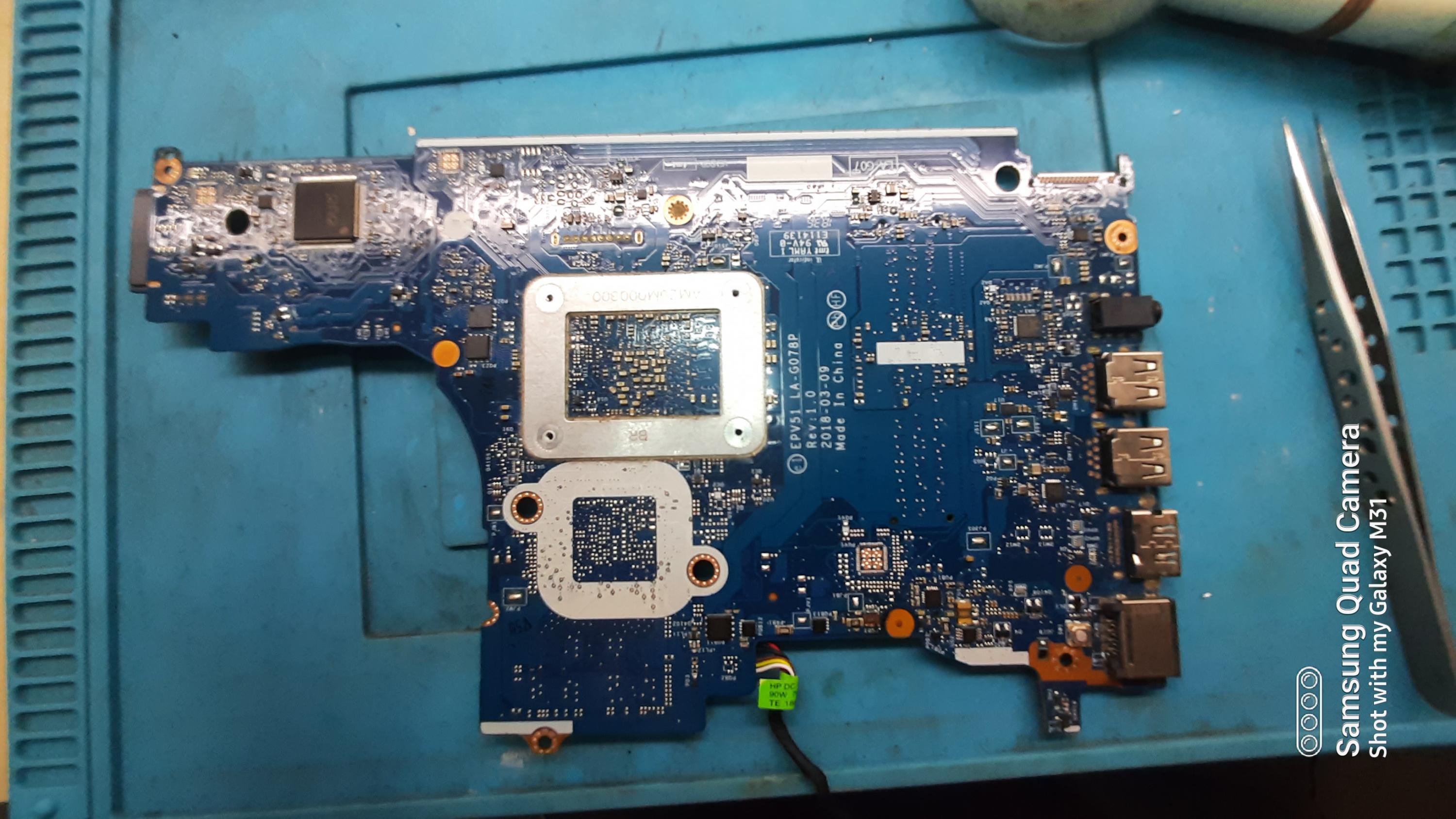

    i' cant find this EPV51 LA-G078P motherboard schematic and Mosfet Burned its like dual channel mosfet. please tell what is that part number if you know.

    Re: EPV51 LA-G078P Mosfet Burned Some one Know this Part Number
    there is not many dualmosfets. reconstruct traces and try any dual nchannel with fair current. i bet it will work

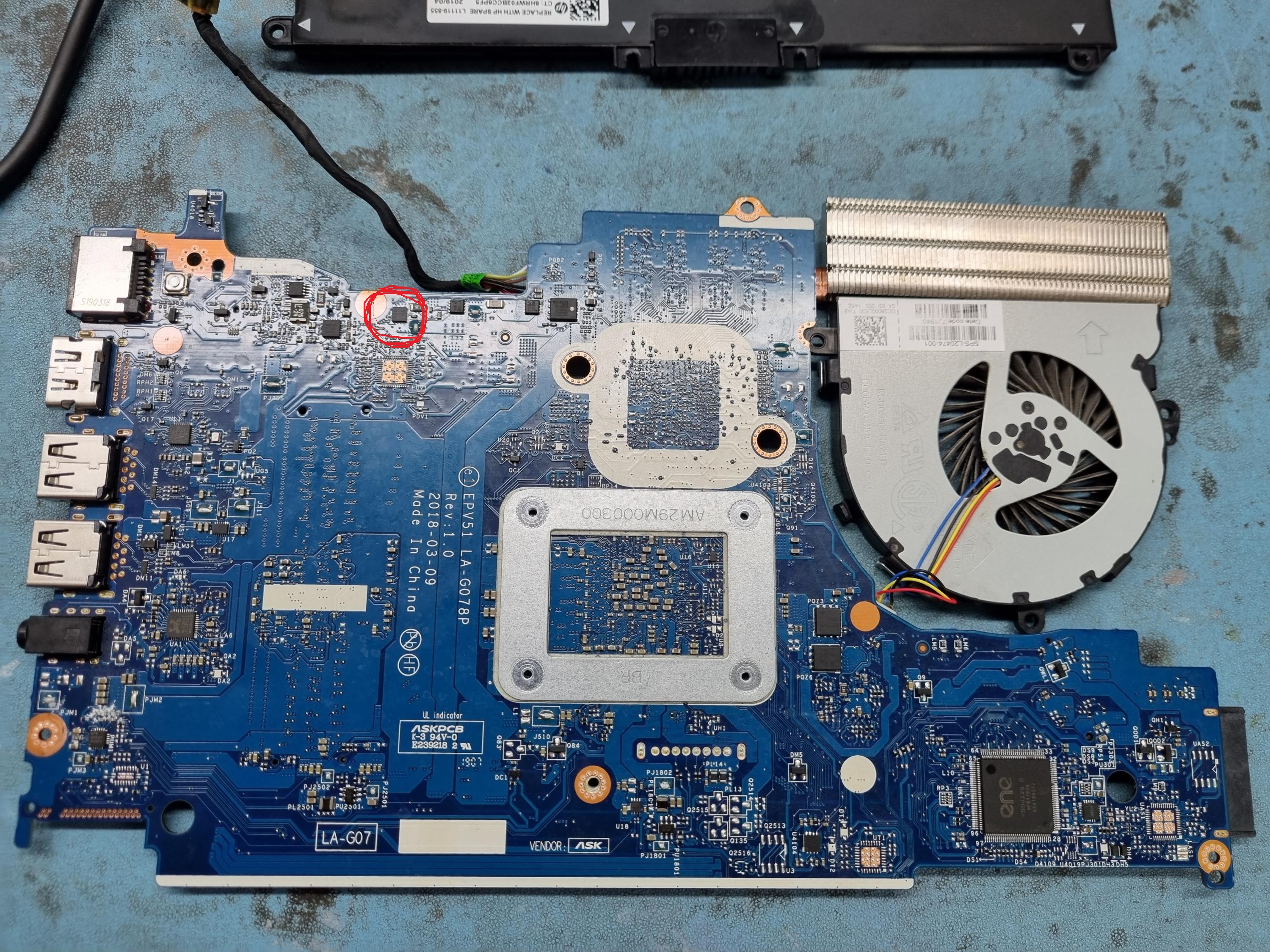

      @dicky96 is currently working on the same board,ask him what the marking is
        https://www.badcaps.net/forum/showthread.php?t=100574
        what is the part number of PQB1
          • 20966
          Ask him in his thread,not this one... .EDIT: nevermind,asked him for you .
              Pqb1=aonh36334

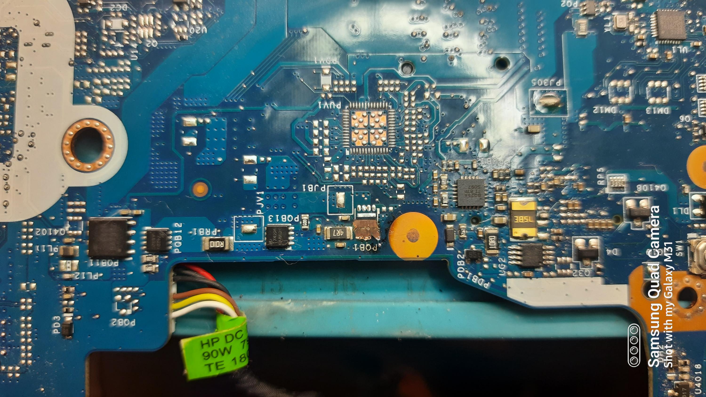

                Hello guys,
                I have a burnt PQB12 caused by a short in the charging port. Could you tell me what is the part number please?
                And if possible before and after mosfet voltages?
                I know this is other person’s thread, but since it was answered already, I thought of here would be better to get some help too.
                • Sraros
                  • Jan 2017
                  • 223
                  • Greece
                  Zooming in your PQB13 i can read 74220 and so PQB12 is identical.
                  Mine in PQB13 is 7506 so I ll go with this. Thanks eitherway for posting your pictures
