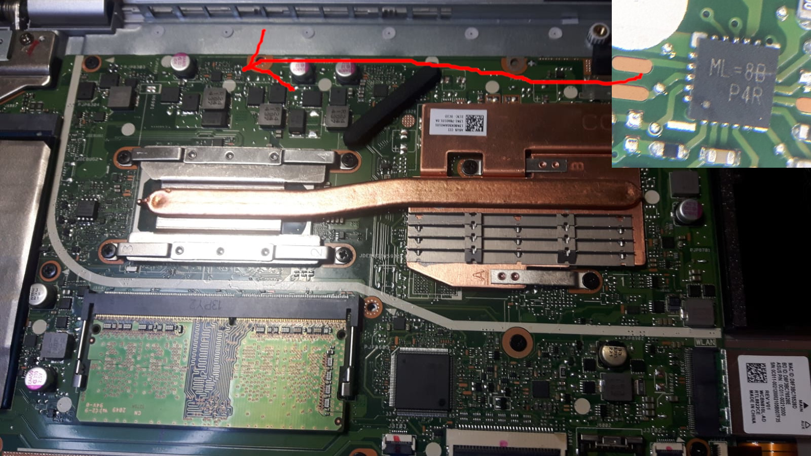

    Hi, Asus F712J, board X512JA Rev2.0, no power, I replace BQ24780S and few mosfet and first resistor 10mOhm in power line from power jack. Laptop power on with screen windows ok, system win10 ok, but I can't turn off, battery charging the orange LED is constantly on and there are 3V and 5V voltage and PCH power supply I need schematic, board view and bios dump or good solution.
    Sorry my bad english.
    Regards.

    Re: Asus F712J
    https://www.badcaps.net/forum/attach...1&d=1636052187
    can anyone help identify this chip ?
    after tur on - S0 - 1,80V
    after turn off - S? - 1,10V
    power source pch ?
    after turn off I suppose the board doesn't reach S5 state, battery powered without charger, maintains 3 and 5V and 1.8V voltage, led charging orange if battery charging, white after charge. still white after off without charger.

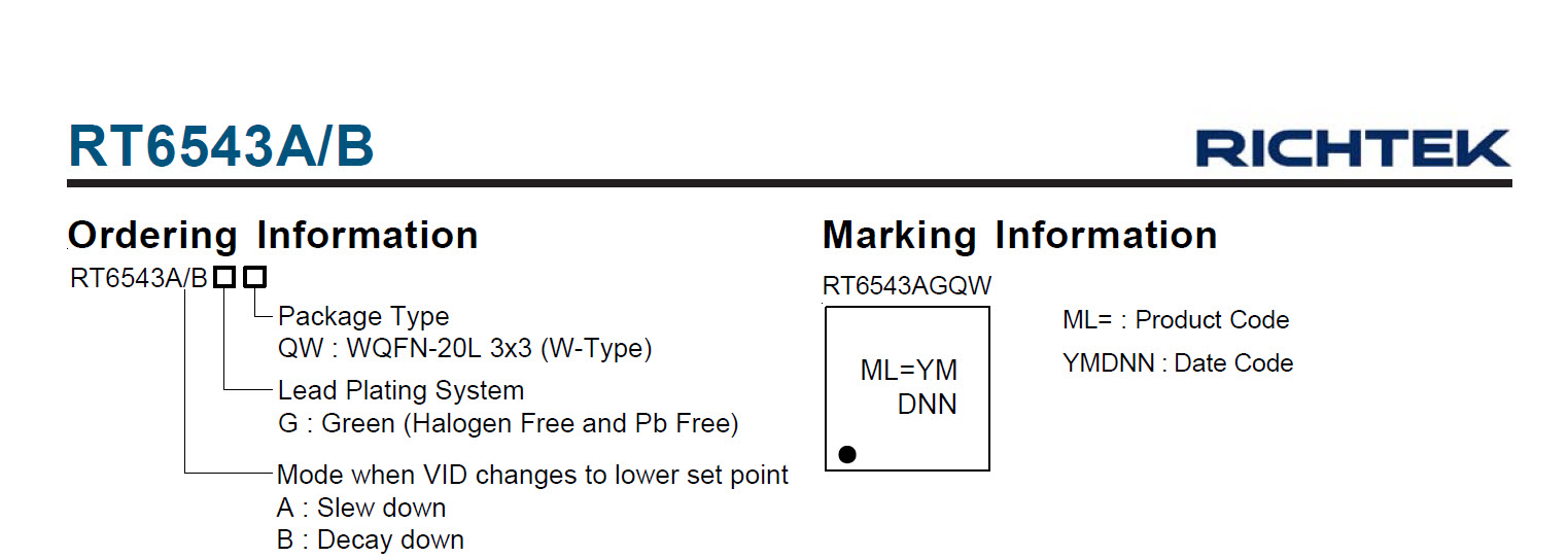

    • mon2
      • Dec 2019
      • 14368
      Re: Asus F712J
      Attached.

        Re: Asus F712J
        thank you
        (vid1 == 0 && vid0 == 1)
        { vout = 1,10V; }
        I still don't have a schematic, ic look good , Vout is 1,10V .
        The output voltage is 1.10V because this is how the "vid" inputs are controlled.
        Maybe I will try to reprogram kbc, anyone has a file for kbc for this laptop or extract from bios ?

              Re: Asus F712J
              Pin 5 BQ24780S ACOK still H logic level. My BQ is broken, I replace another BQ from broken board well all ok. System turn on and off, is ok. Now I testing.
              I am old and blind.
              Thanks all.
