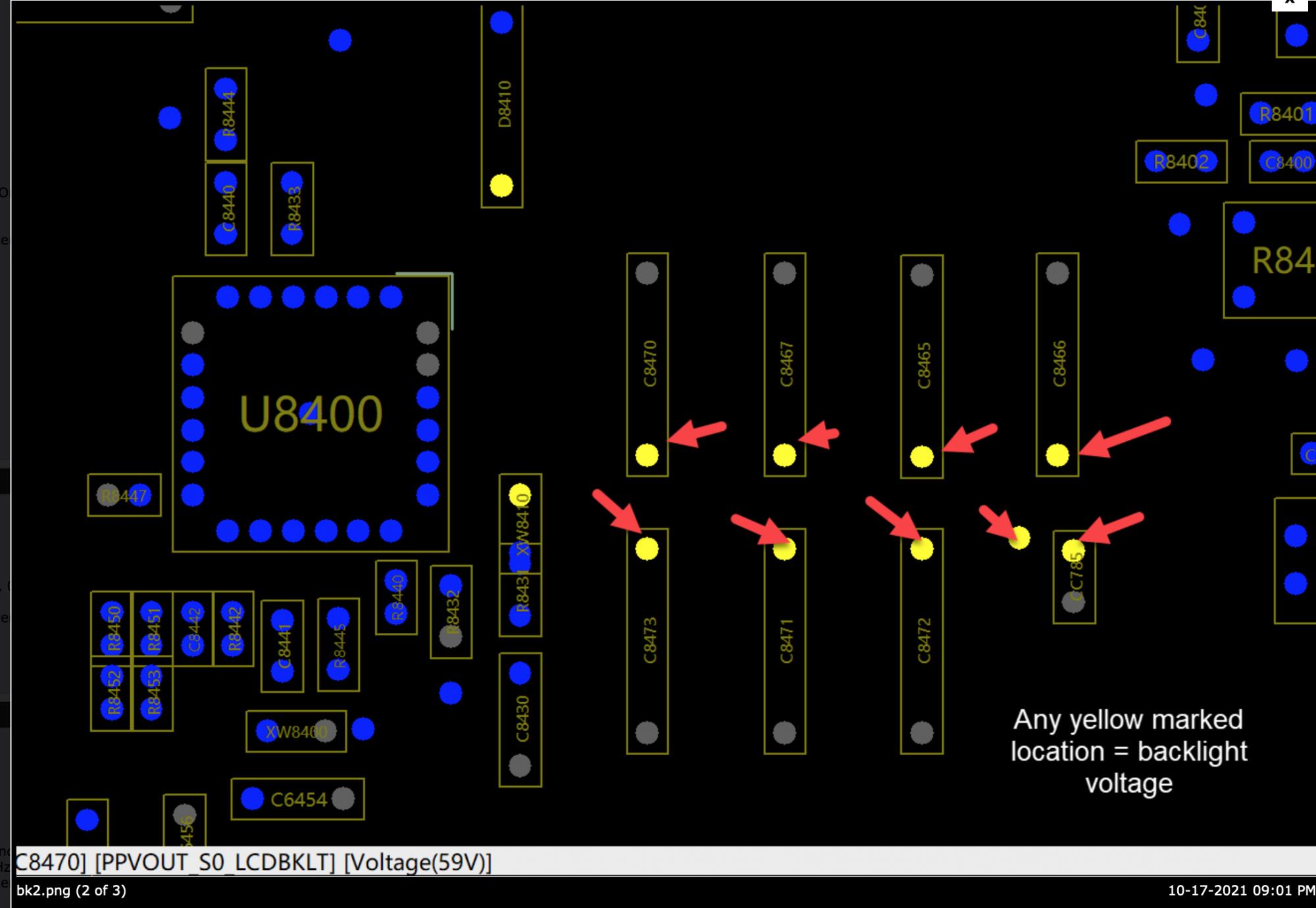

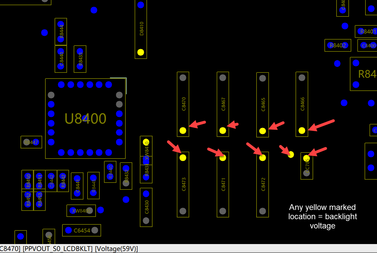

        Re: A1707 2017 LCD Dark after Liquid
        See attached.
        Any yellow marked location = backlight voltage.
        Just be very careful with the meter probes.
        Meter in DC voltage setting (200 volts is good as the LCD backlight should be 25V or maybe higher if working correctly).
        Red meter to any of the yellow highlighted points - they are all connected together on the circuit board so any point will do.
        Black lead of the meter to any ground point = metal shield is ok.
        Also, when the laptop is on, shine a flashlight along the front face of the display - can you see any of the usual boot logo graphics / login screen, etc. ?

            @when the laptop is on, shine a flashlight along the front face of the display.
            Hi, at the front is nothing to see! Thats why i replaced the U9850.
            I just took measurements! I have 0 volts at the points! I have 11.7V on the fuse nearby.
              I Have 0 Volts at the C84.... +CC78 Points.

                Can you check & post the cap location where you are measuring this voltage? Unable to locate C84.

                  i measured all the points you said Like on the picture. I have 0 volts D8410 also 0 volts

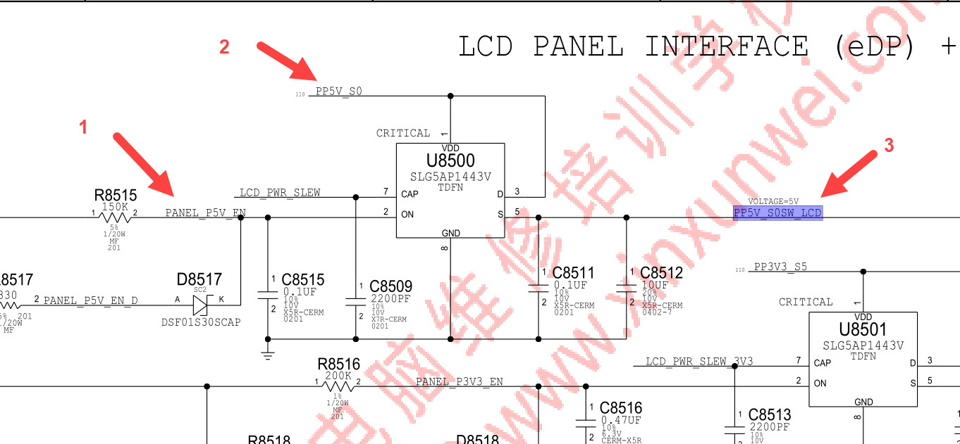

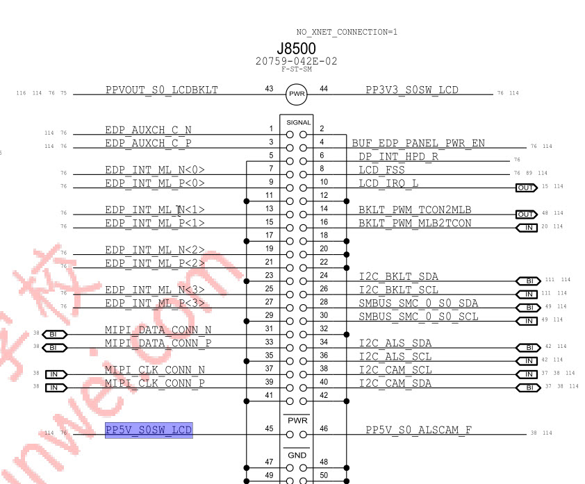

                    Check the PP5V_S0SW_LCD on J8500.
                    Post the voltages for 1, 2 and 3 of the attached.
                      Hi, i have at the U8500 Pin 1 and Pin 5 5Volts! And at R8515 3,7Volts!
                        Confirm the same voltages and the other backlight voltage is reaching J8500.

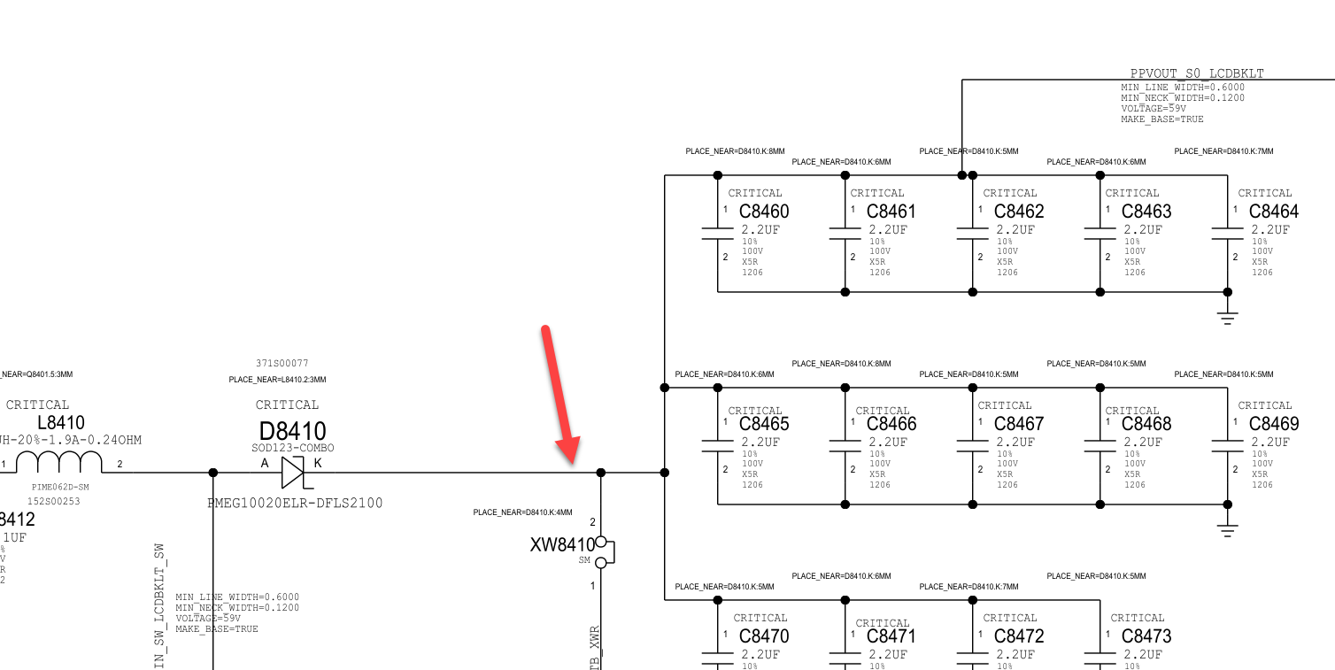

                                    Very good on the U9850 replacement - we can rule this out. You are confident the replacement went well for the soldering ? 'Made it dance' with flux & hot air tool ?
                                    Perhaps reflow it if the ENABLE is logic '1' = means the MUX is enabled.
                                    Curious on the backlight voltage reading (PPVOUT_S0_LCDBKLT).
                                    If PPVOUT_S0_LCDBKLT is not 25+ volts then this rail is not working.
                                    Proceed to remove all power, meter in resistance mode (2k scale is ok).
                                    Check the resistance to ground of PPVOUT_S0_LCDBKLT (red meter probe) & black meter probe to ground. Checking for a low resistance which can cause this rail to be pulled down OR even shut off due to an excessive load (current draw).
                                    Post all readings.
                                        i have no backlight on the display nothing
