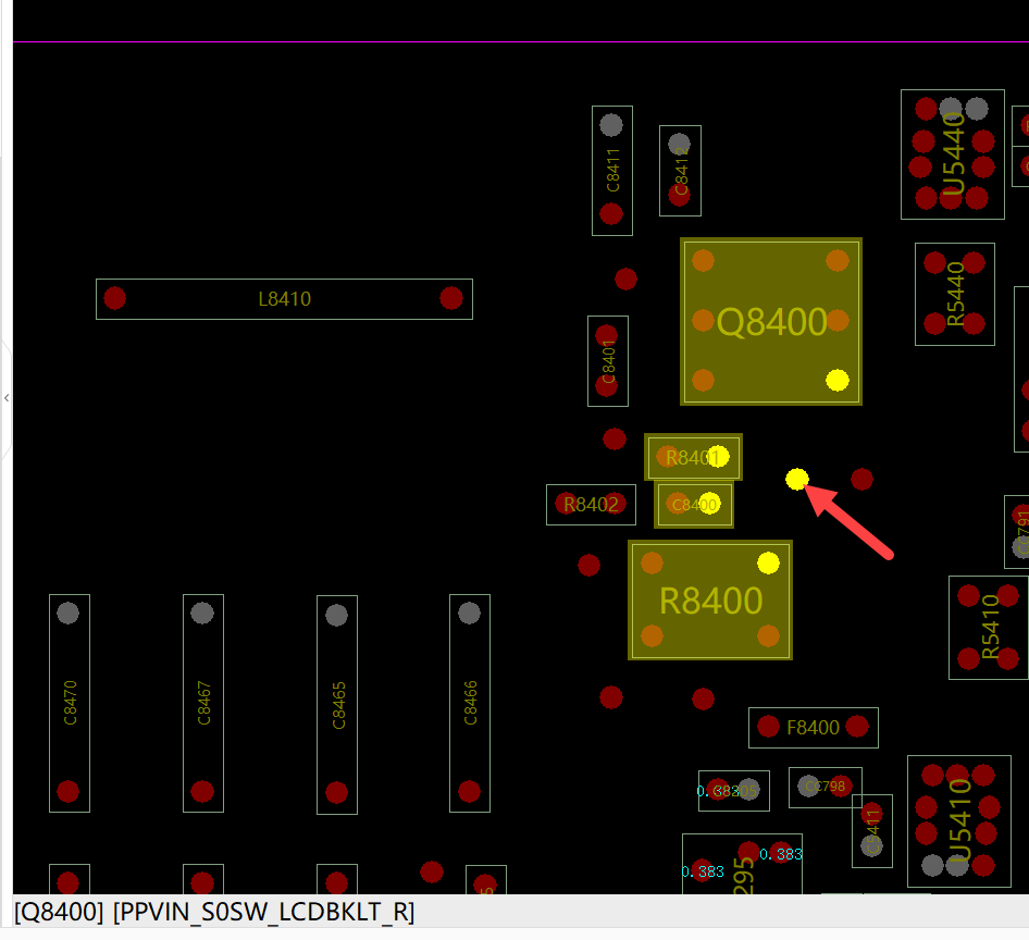

A1707 2017 LCD Dark after Liquid

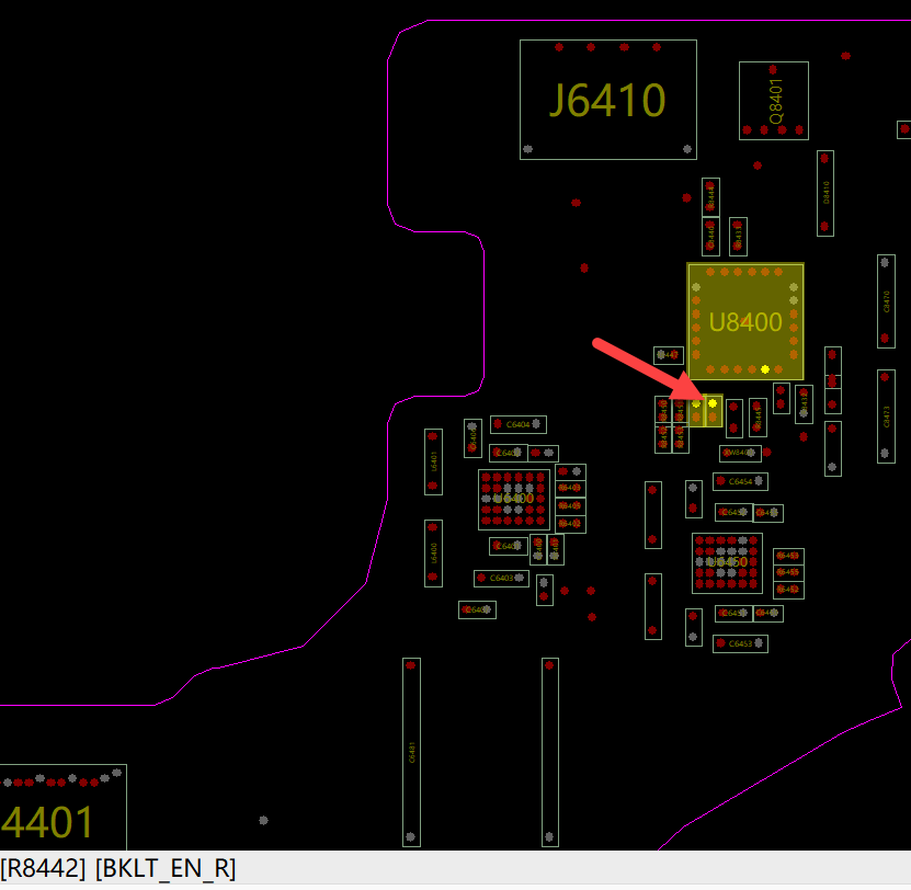

      R8442 0.0020V
      C8470..... al points same 0.0020

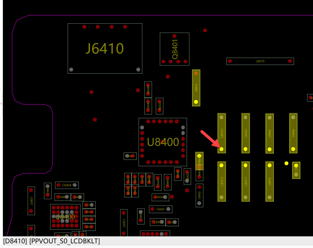

          Re: A1707 2017 LCD Dark after Liquid
          Display needs to be connected.
          Remove all power.
          Check the resistance to ground of PPVOUT_S0_LCDBKLT (red meter probe) & black meter probe to ground. Checking for a low resistance which can cause this rail to be pulled down OR even shut off due to an excessive load (current draw).
          • Strolch
            • Nov 2017
            • 237
            • Deutschland
            Does the display have to be connected for all measurements? Then I have to start all over again
            • mon2
              • Dec 2019
              • 14010
              Yes.
              Connect the display but do not power up.
              Meter in resistance mode. Check the resistance to ground on PPVOUT_S0_LCDBKLT.
              Is it very low in resistance? If yes, then this needs to be fixed.
              If resistance reading is high then proceed to power on and check if the voltage of PPVOUT_S0_LCDBKLT is high enough to light up the LEDs in the display.
              Voltage of PPVOUT_S0_LCDBKLT ?
              If low voltage on PPVOUT_S0_LCDBKLT then check if the backlight IC is being ENABLED.
              Voltage of the backlight enable pin?
              The points to test are in earlier posts above.

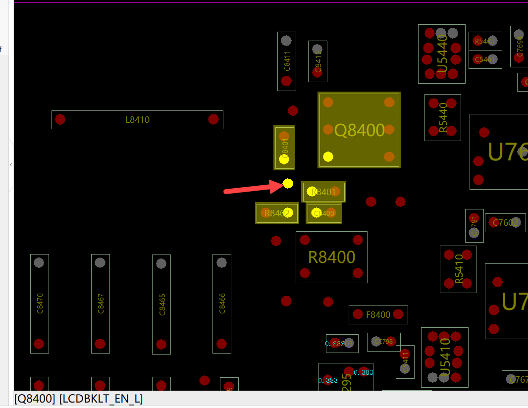

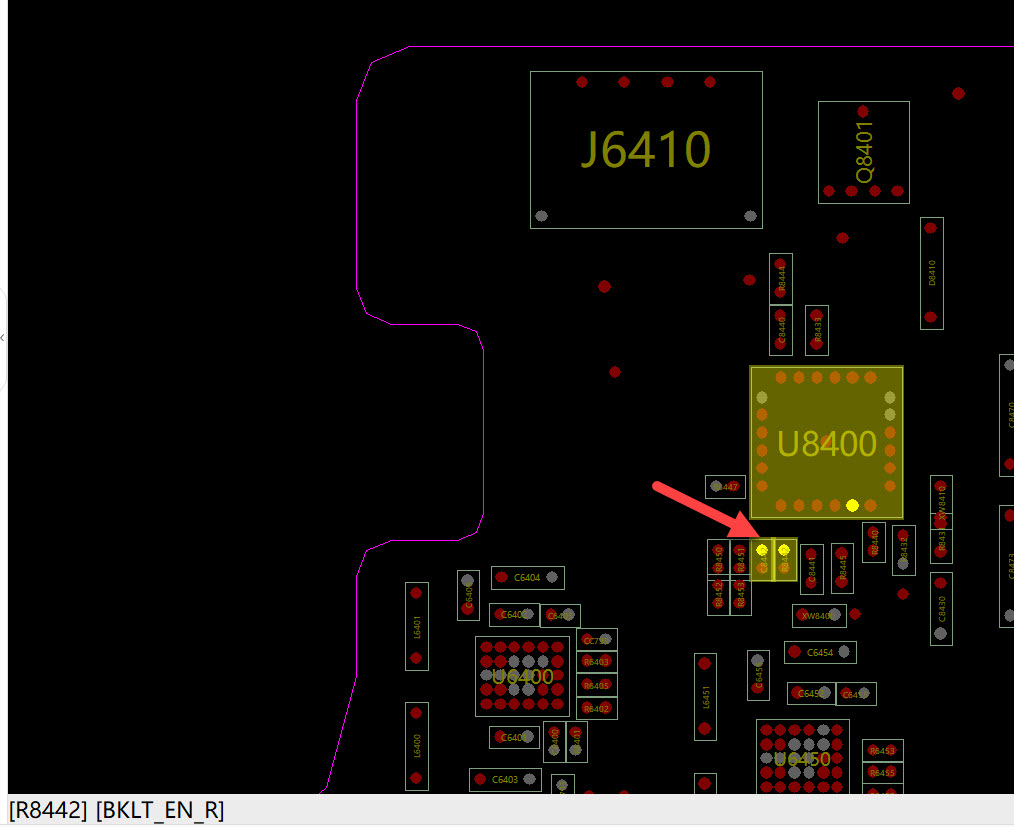

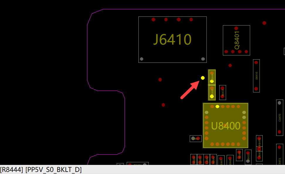

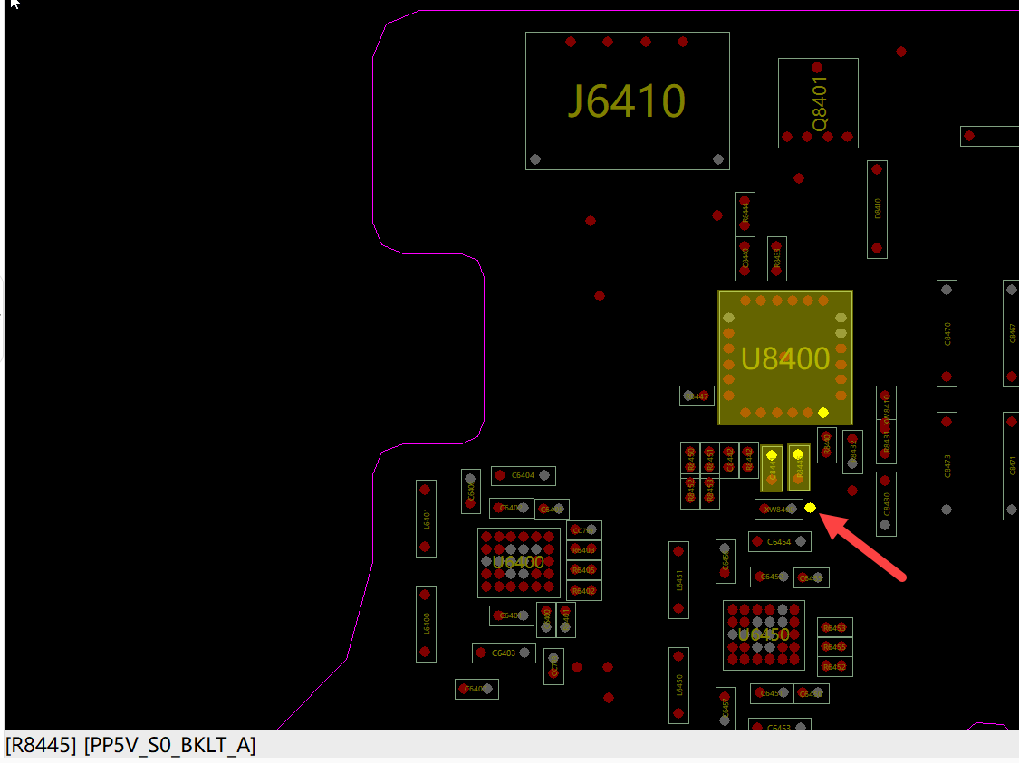

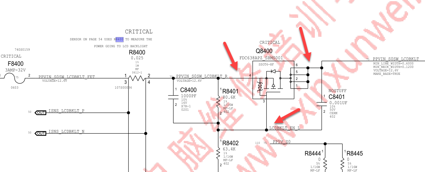

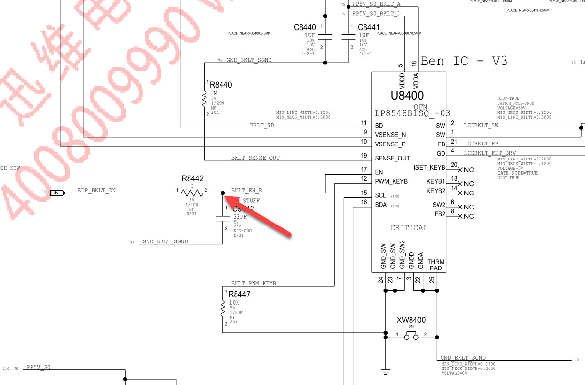

                        Post the voltages for:
                        1) R8444 & R8445, pin # 2. This will confirm that U8400 is being powered.
                        These are the VDD Digital & VDD Analog, respectively, power rails.
                        2) R8442, pin #2 = Enable pin voltage for U8400.

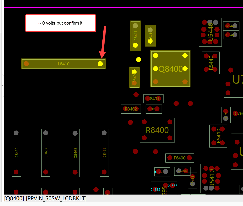

                        3) Q8400 mosfet - see attached. Need the voltages on:
                        pin 4
                        pin 3
                        pin 1-2-5-6
                        (measure any of these pins)
                        The voltage @ pin 4 should be the same as the voltage on fuse F8400, pin 1 (unless fuse 8400 is blown due to an excessive current draw).
