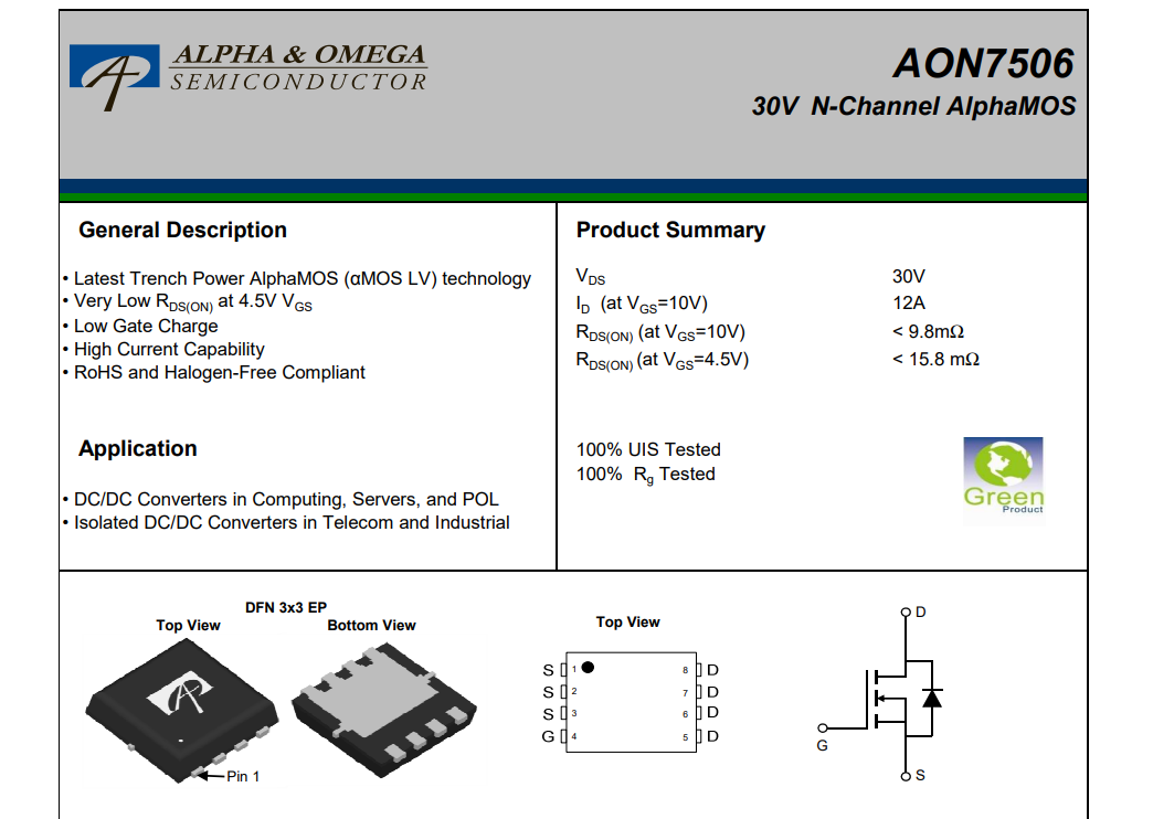

    0v on PQB1 and PQB2 and 0 on PRB1. I think it is a short to ground, but cannot test further on live voltage as the motherboard has started to spark around the capacitors near the mosfets above.
    I need to replace the mosfets, caps and resistors near tehm too as I fear they are damaged from the sparking, but where else should I test to find the short? Does anyone understand the power architecture and can they explain it to me?

    1) remove all power to the logic board.
    2) meter in resistance mode.
    3) measure & post the resistance for the following:
    a) PQB1: drain (pin 5-6-7-8) & source (1-2-3)
    b) PQB1: drain (5-6-7-8) & gate (4)
    c) PQB1: source (1-2-3) & gate (4)
    d) PQB2: source (1-2-3) & drain (5-6-7-8)
    e) PQB2: source (1-2-3) & gate (4)
    f) PQB2: gate(4) & drain (5-6-7-8)

      Resistance values are inconsistent. Tried with two different multimeters. The source gate resistance for both mosfets starts at around 14k and afterwards keeps climbing up, while the source drain and gate drain starts at 88k and keeps climbing up for both as well. They take very long to settle and settle at different values, but all the values are at the 10k-210k

        So the mosfets do not appear to be shorted.

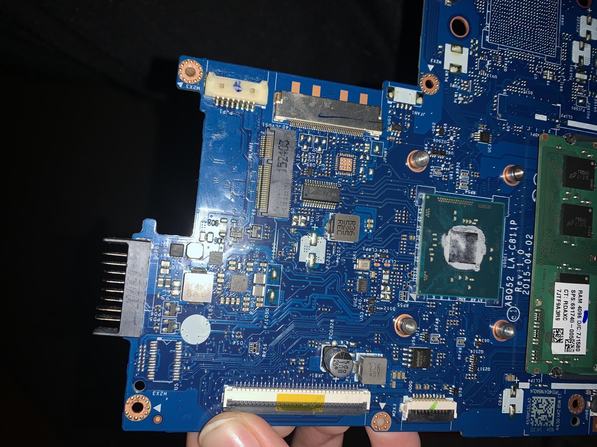

            Covered in flux from a previous repair, I think? Cannot contact client now to be sure, but where else would the flux come from?
            I think PRB5 is the one I highlighted in yellow as it has 10 ohm resistance and continuity with PUB1, but where is PBD1?

              There is a current sense resistor just after the 2 dc-in mosfets(maybe rated R010). What is the resistance to GND on this resistor?? It seems you have short in +19V rail.
