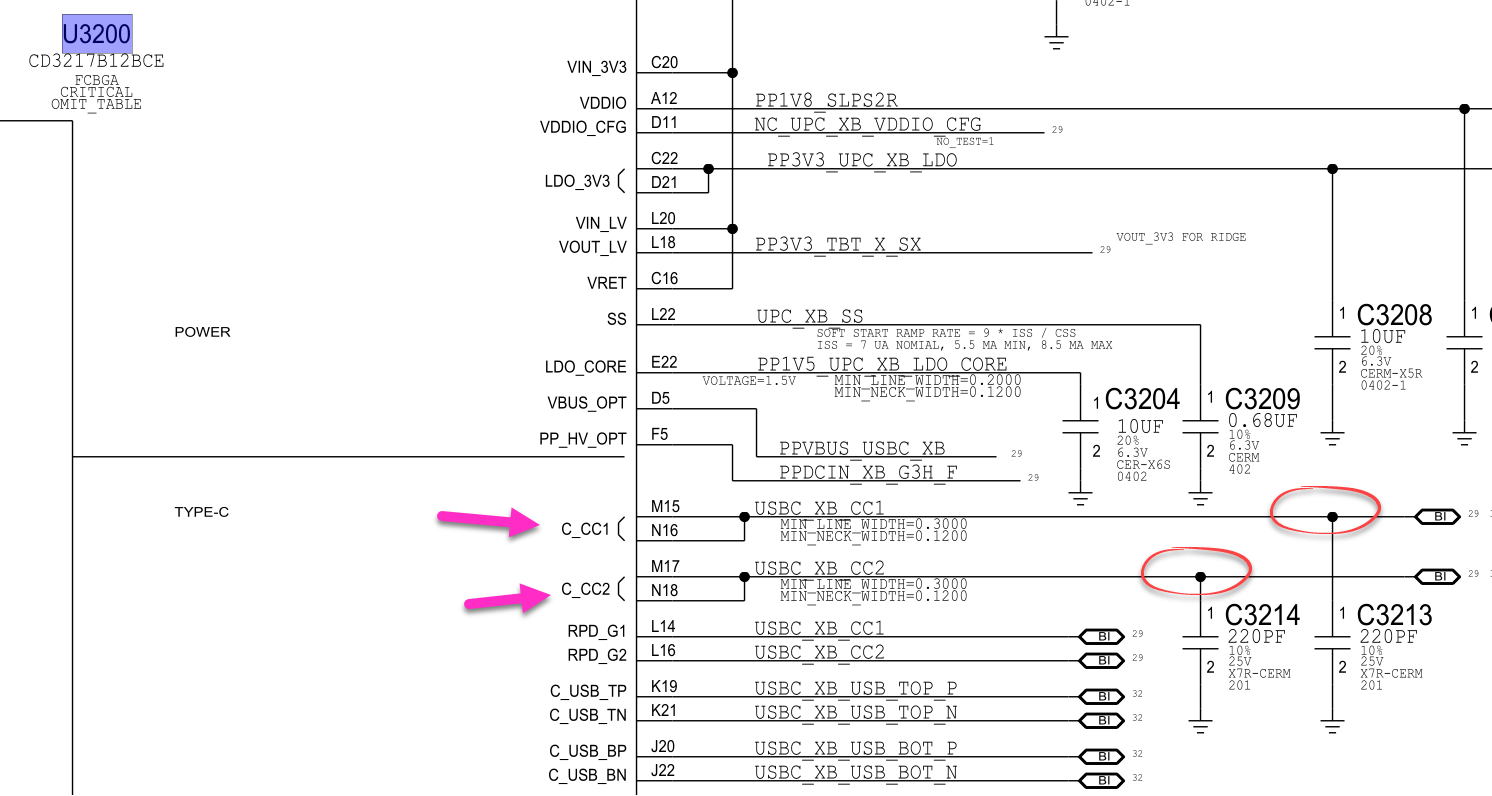

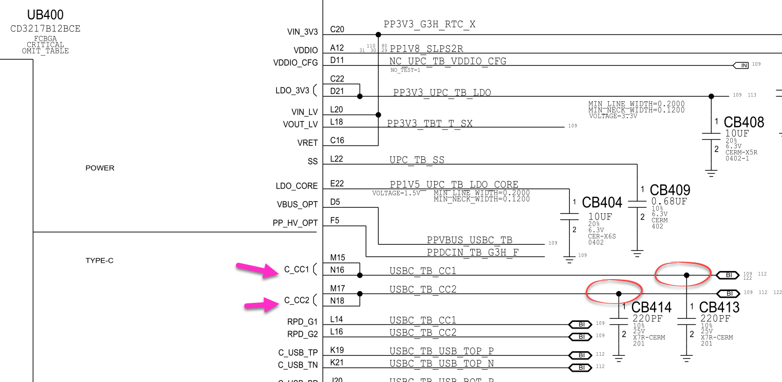

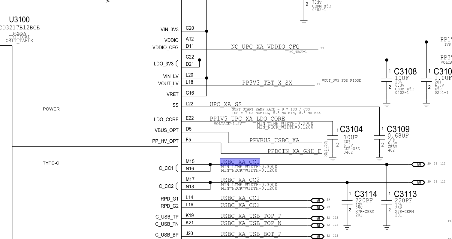

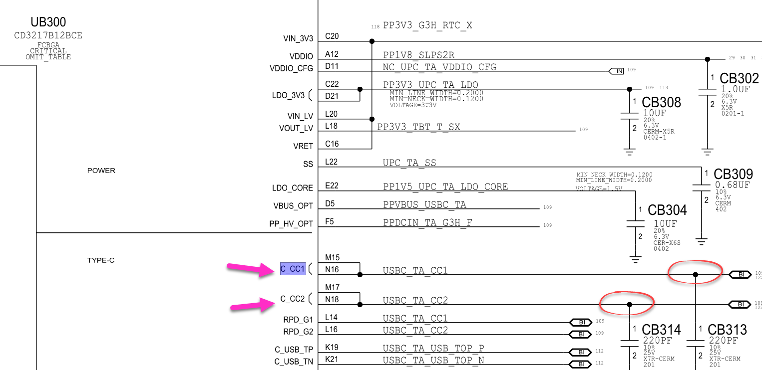

      When rested, start with the DIODE readings for the following:
      USBC_XA_CC1
      USBC_XA_CC2
      These are called the CCx lines and each connector will have a pair -> which links to the local ACE controller.
      The CCx lines are used to exchange the Power Delivery contracts. It is a known fact that these lines get damaged due to the hot removal of the external adapter. The kooky Type C connector can short the CCx line against the high voltage line used for the power delivery pin itself if the cable is pulled at a slight angle.
      For a while, the CCx lines were not 20V tolerant. Now the latest power delivery controllers can handle even 28V surges without damage. I recall almost burning my hand from a similar case but that was a few years ago and was with PD 1.0 specs. Now they are 'more advanced' so let us hope for the best.
      For the DIODE mode testing, RED meter to ground & BLACK meter lead to the CC1 pin. You could measure this @ C3113 and then again @ C3114.
      Post the DIODE reading values.
      The repeat for the next USB port, etc. and post the results.
      See attached on where to measure.
      What we are looking for are any possible bad DIODE readings which will indicate the ACE controller is likely damaged due to the high voltage surge from the external adapter. No power to the logic board for these tests - only the meter in DIODE mode.

          USBC_XA_CC1 .539 cb413
          USBC_XA_CC2 .539 cb414
          USBC_XA_CC1 .535 cb313
          USBC_XA_CC2 .535 cb314
          USBC_XA_CC1 .540 c3113
          USBC_XA_CC2 .540 c3114
          USBC_XA_CC1 .545 c3213
          USBC_XA_CC2 .545 c3214
          all done no shorts here !
