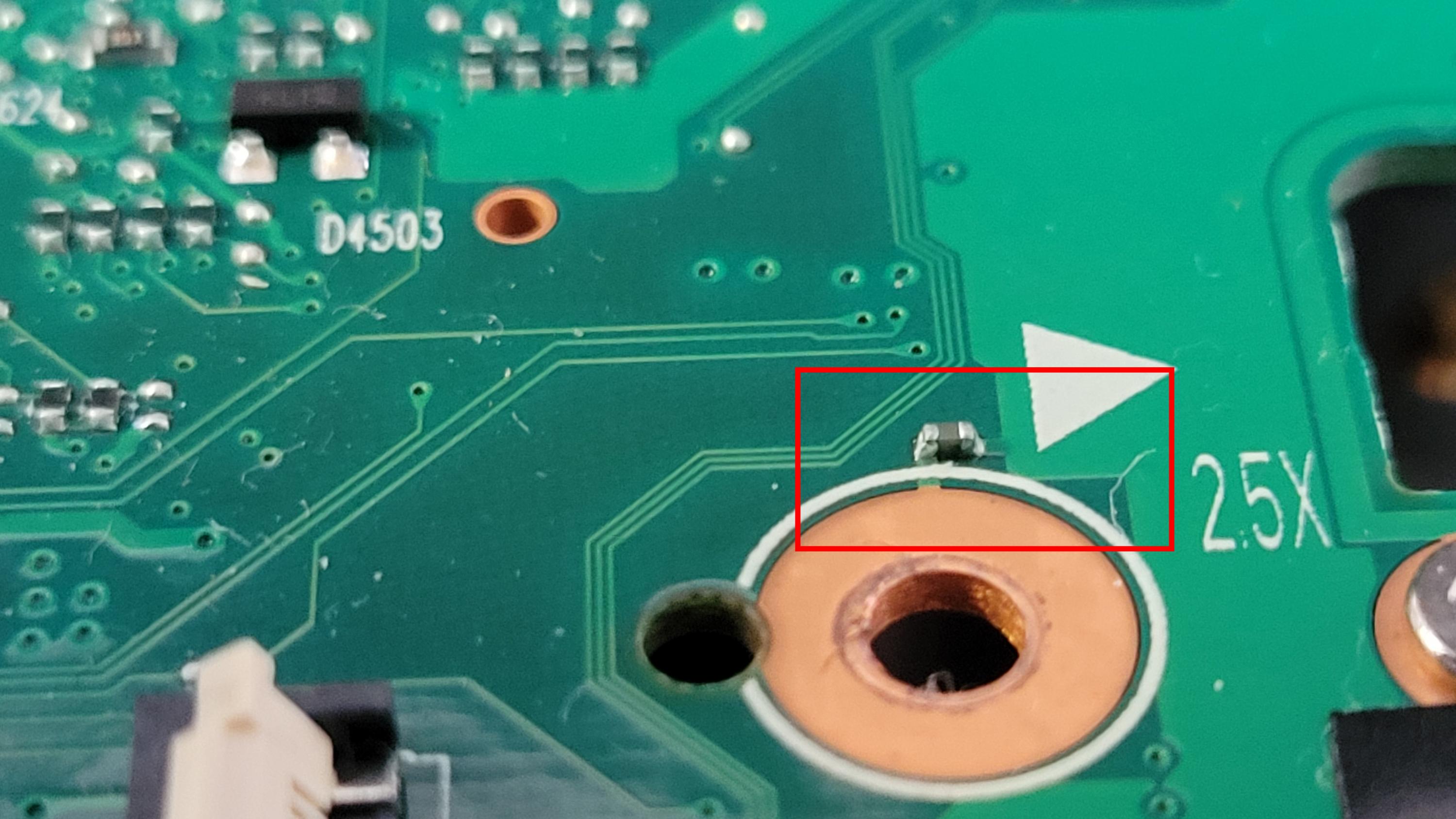

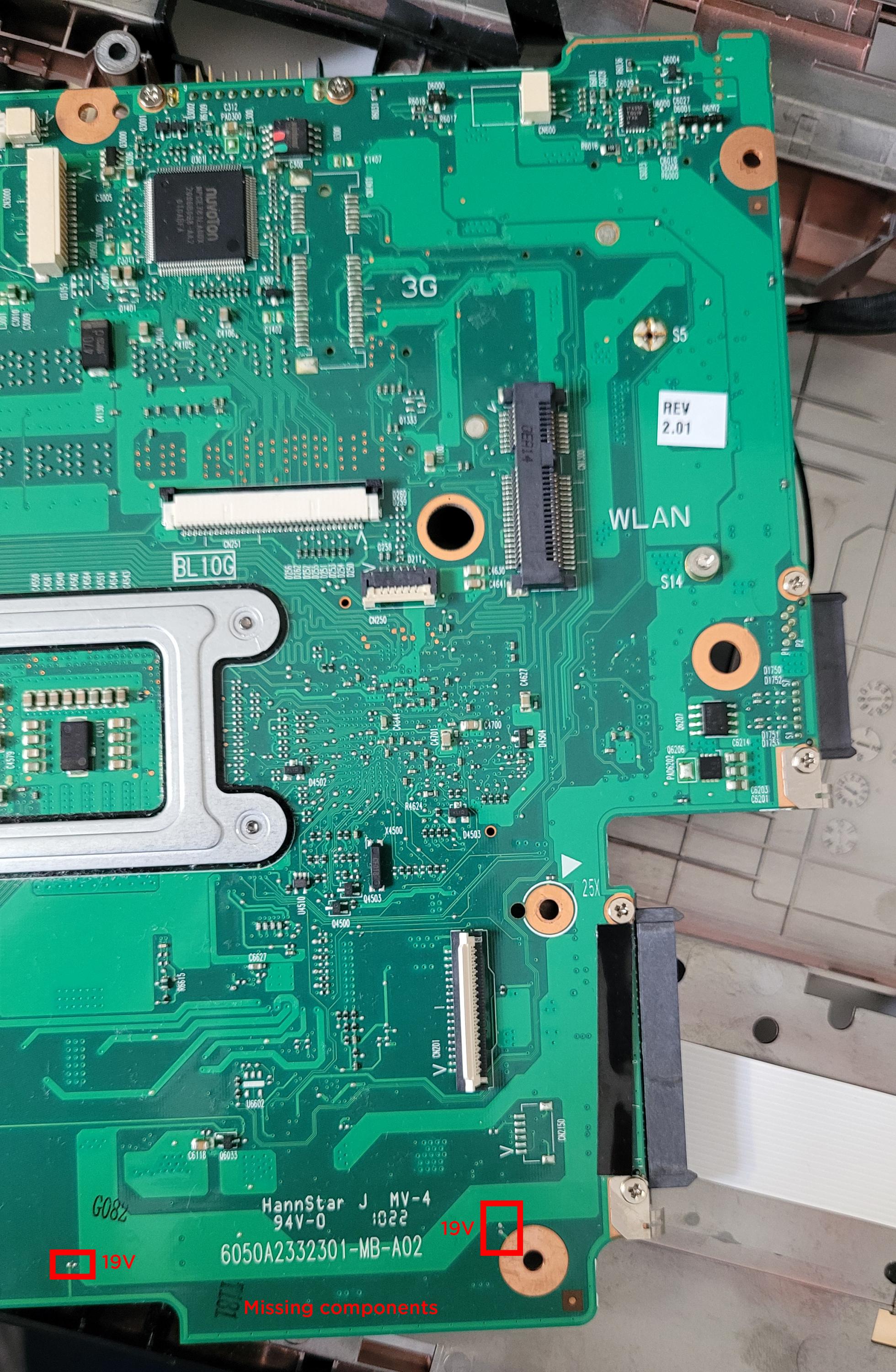

I have a Toshiba L650 that won't boot. I have the power led and charging leds ok. But if I press the power button, nothing happens. I have tested the power button: voltage drops from 3V to 0V when pressed. Button is fine.
Upon motherboard inspection, I have found out that one component was missing (now two components, bc I have destroyed another one trying to fix, sigh...).
Please see the picture attached.
The components missing seem to be similar to many other components along that trace: they go from the trace (tested 19V) to the ground copper circles. I attach a closeup of one of said components that are going from 19V to ground.
Please see the picture attached of the component that I'm looking for.
I attach the motherboard schematics for further help.
Can you please tell me what these components are?
