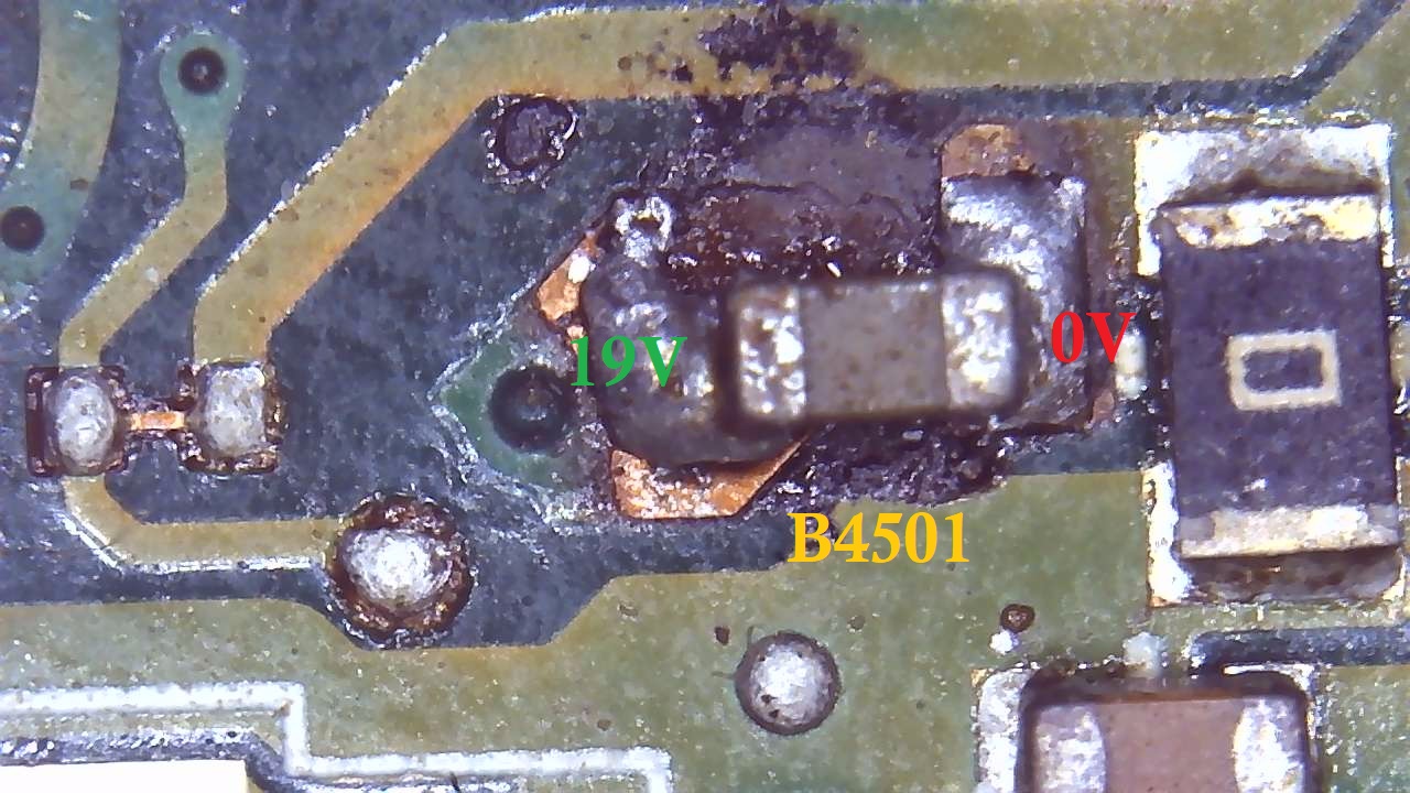

laptop: ASUS F550Z
motherboard: X550ZE rev. 2.0
laptop turns on but there is no backlight on display but I can see image if I use a torch on the display.
Unfortunately, schematic seems not to be available and I only have boardview.
I have checked LVDS connector and there is no 19v on pins 39 and 40 AC INV. 19v is present at pin 2 of B4501 but it's 0v on pin 1, which is connected only to 2 components (R4563 and C4509) as you can see.
Now my problem is to understand if it's a issue related to the motherboard, LCD cable or display (but I know that, in case of no backlight, display usually can be excluded from the faulty reasons).
One thing you should know is that when I received laptop, B4501 was not present (maybe someone removed it to diagnose the problem) and it seems that something burned there because I found black track just there. I cleaned area and I put a new component from a scratch board (even if I don't know specs of that component that seems to be inductor).
Please help me to understand.
