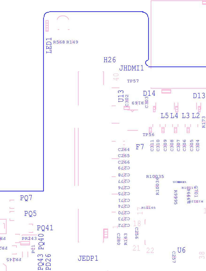

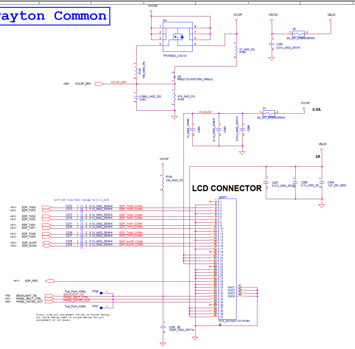

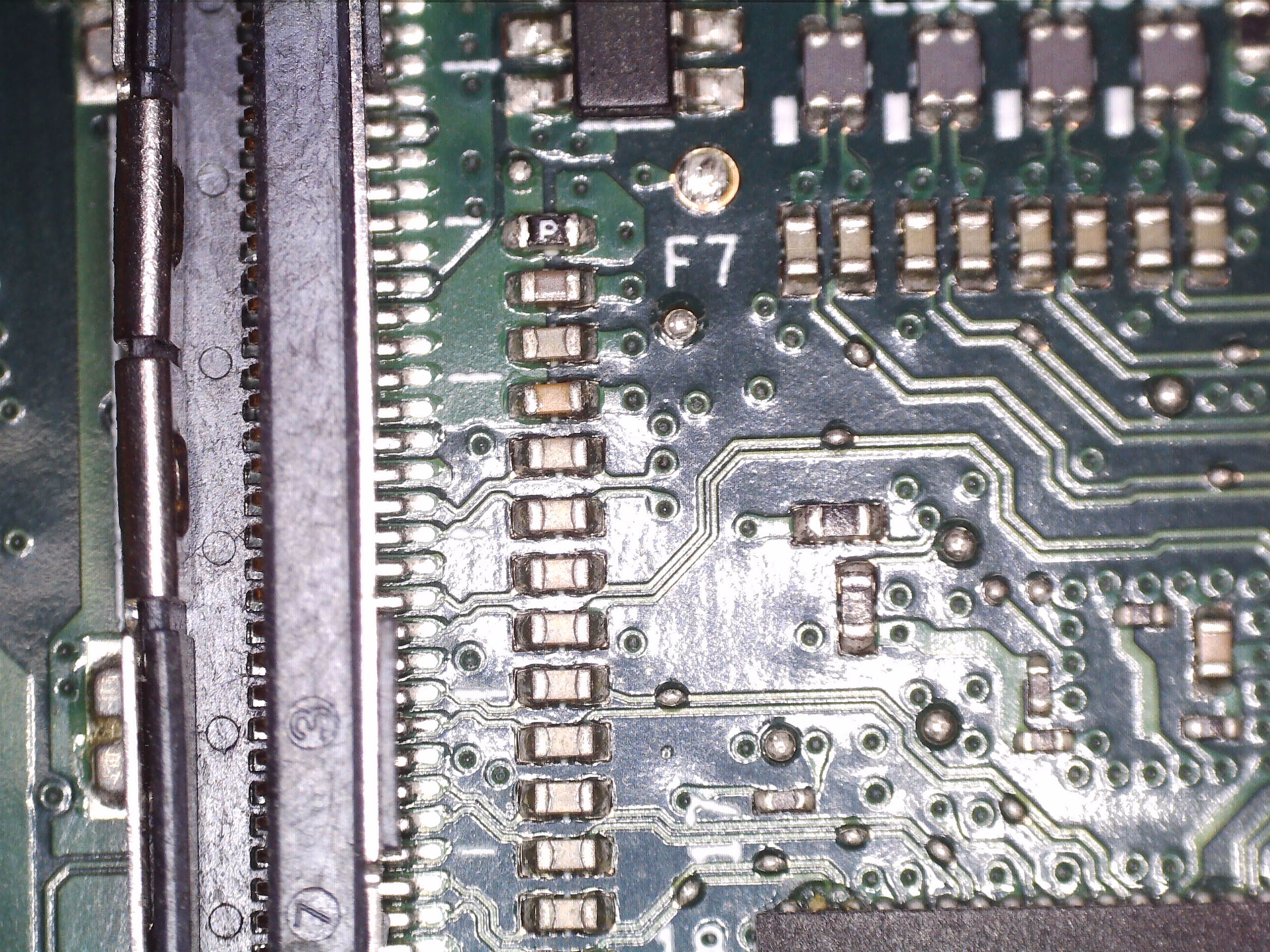

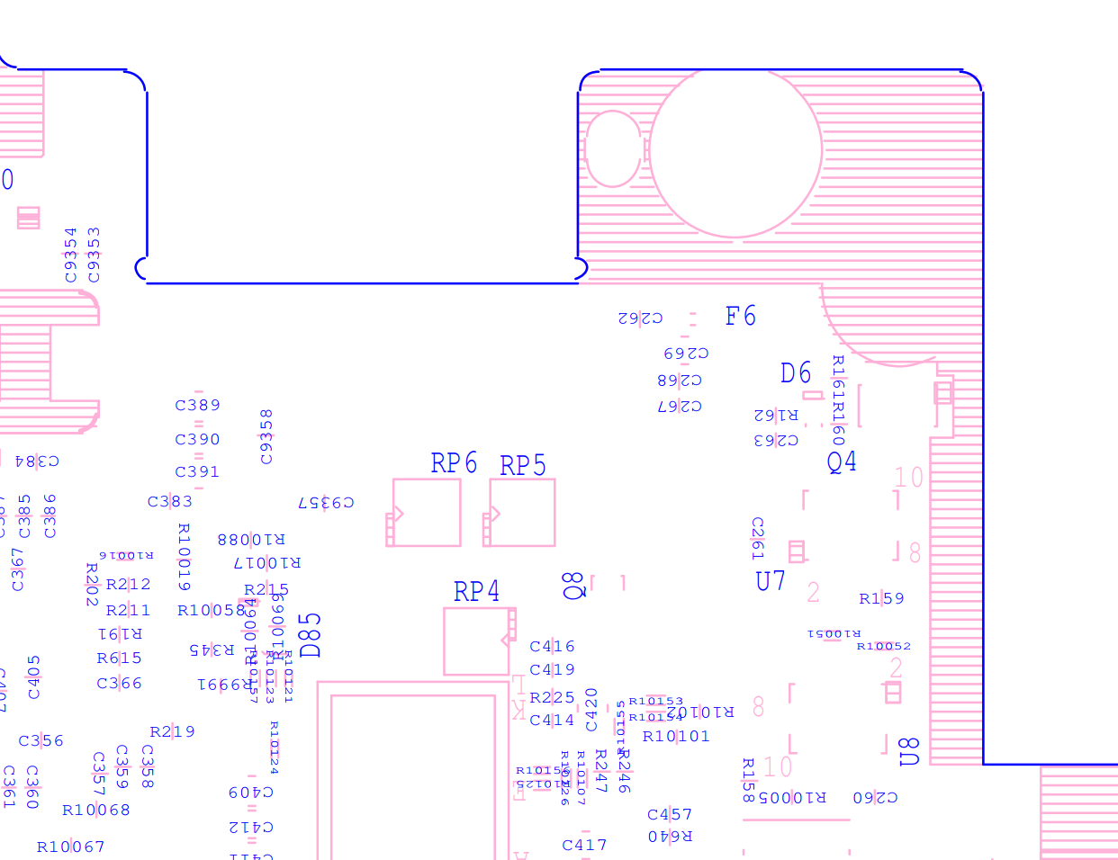

        F6 & F7 it looks like (thanks to SMDFlea for supplying the Schematics! https://www.badcaps.net/forum/showpo...43&postcount=2)
        And yes, F6 is on the backside. I've tested F7, and it had continuity...

          The schematics suggest it's F6 & F7 on the motherboard for the lcd/backlight fuses. I know F7 is ok, it had continuity when i had her open last time. It was right next to the connector.

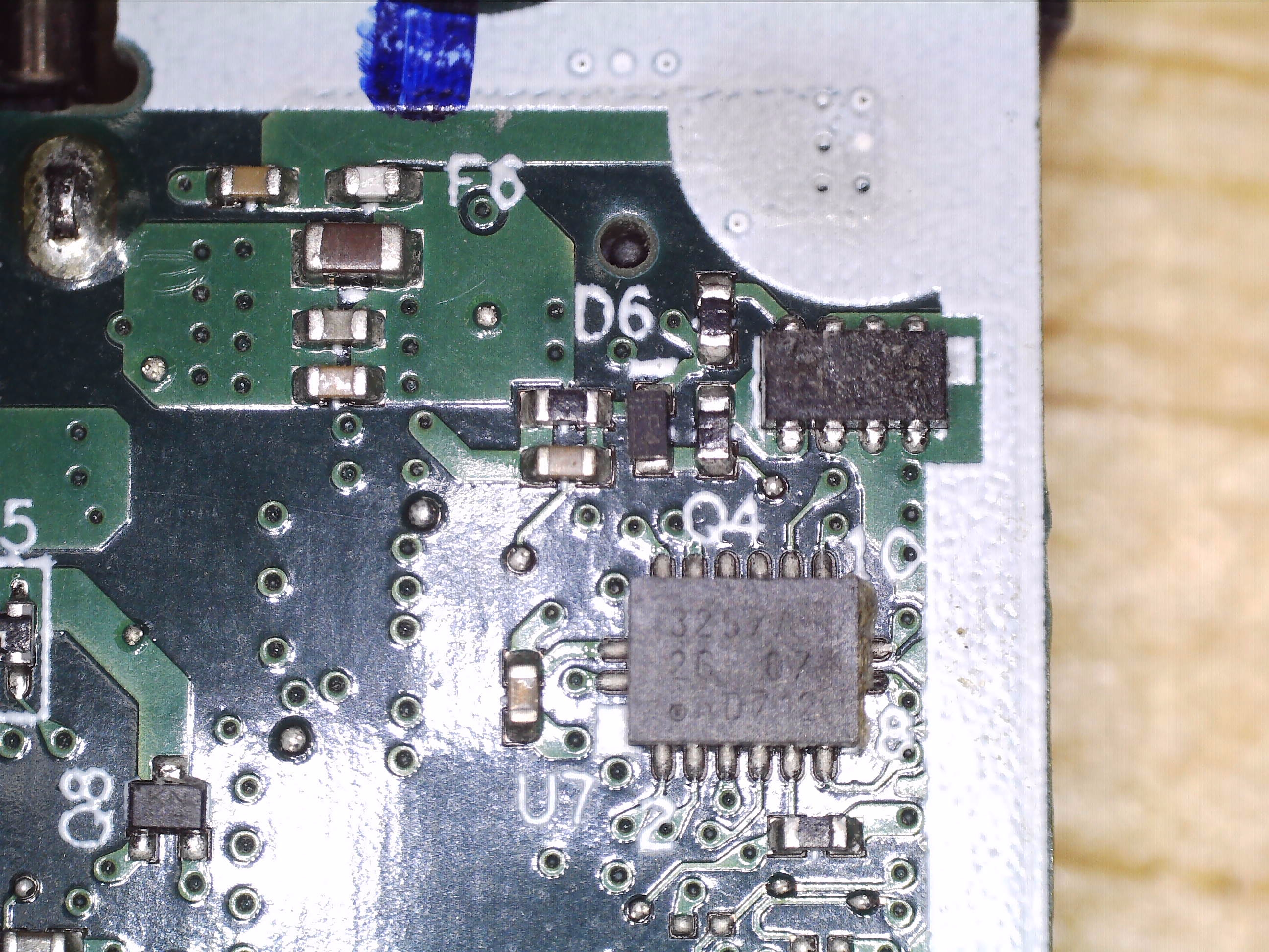

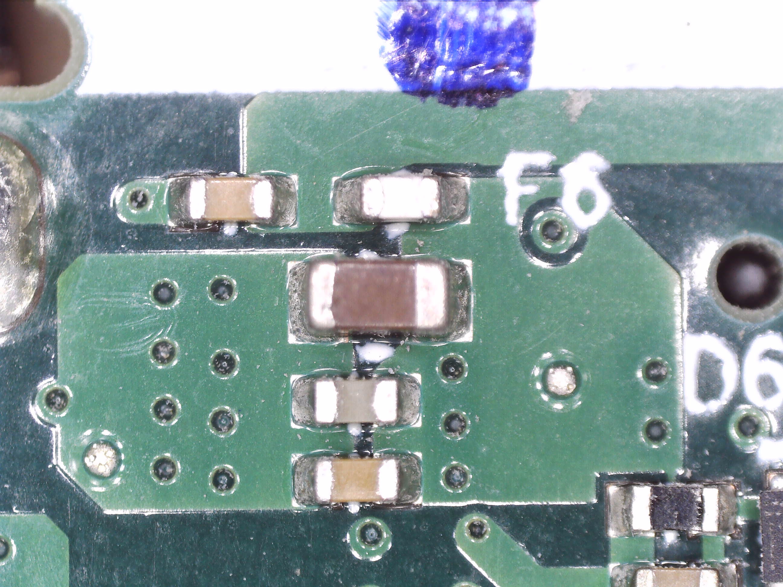

            i've cracked her open tonight and F6 seems to be blown... If the white SMD to the immediate left is the fuse...
            It doesn't have any markings, like F7 does (P)...
            Am i correct in assuming this is the fuse?
            I've attached a few microscope pics.

              Re: Backlight dead on ThinkPad P51 20HH?
              Yes F6 is a fuse. You can get similar fuse at the back of screen(if you have any damaged/broken).
                That's a very handy little trick to learn!
                I found 3 fuses on my old, dead panel.
                But OMG aren't they so amazingly tiny!
                I'm working with a USB microscope, with more lag than you can shake a stick at. So it was horrendous trying to get it in place. I got the old F6 fuse off using the big blob of solder trick, as i only have a simple soldering iron, with a smallish tip. But putting the new one into place took me ages. It ain't pretty, but it's electrically correct. Must get an optical microscope, and sharpen my tweezers...
                The fuse then had continuity and no shorts to ground, so all good...
                After i'd gotten her back together with some new paste and pads, and then the hilariously horrifically long initial seemingly 'dead' screen/laptop ram check (64GB!) (gets me every time... patience......) i finally saw the lovely red Lenovo logo.
