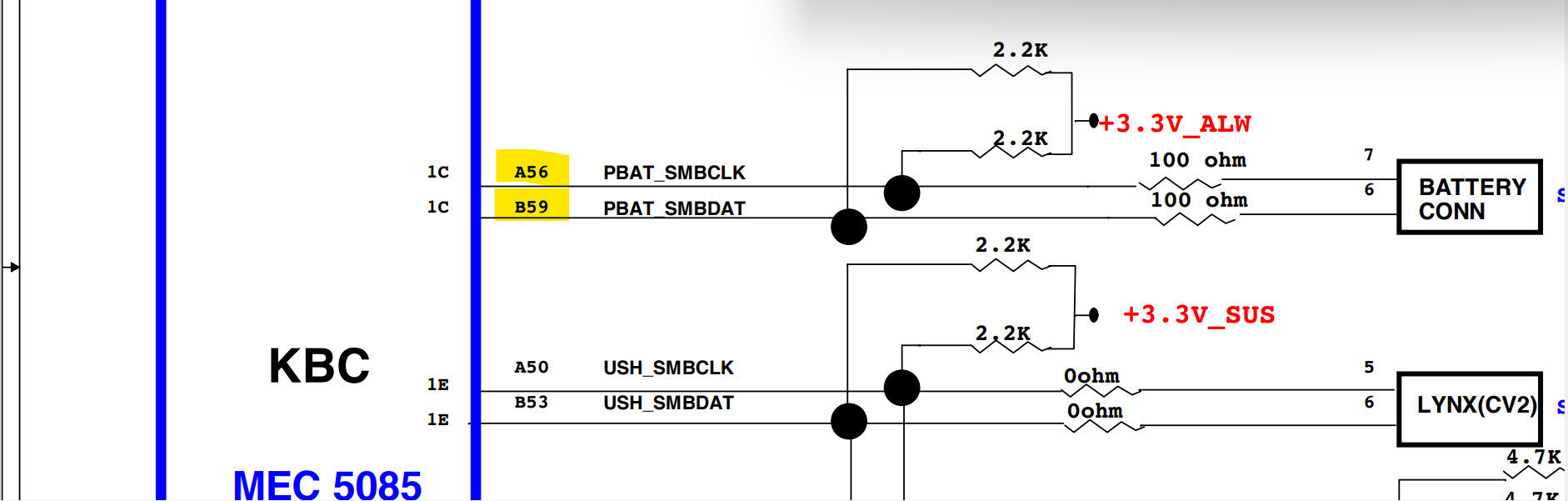

    Hello friends!
    I have a Dell Precision 7510 with 2 problems.
    1) The battery doesn't charge and gives (in BIOS) a "Communication error" message. I want to know if the problem is in the battery itself or in MB.
    2) The left side mini board (the one with Type C, HDMI, MiniDP & 1x USB 3.0) prevents the laptop from power on more than one time.
    Without the board the laptop power on and off normally and works great, with it attached powers only once and if switched off doesn't power on again.
    Schematics attached
    Thank you in advance!!!

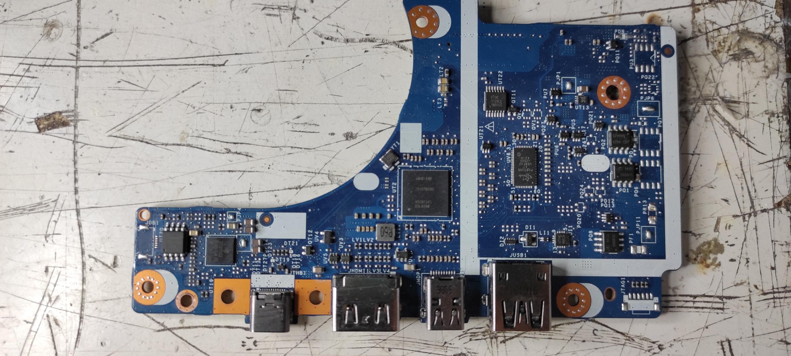

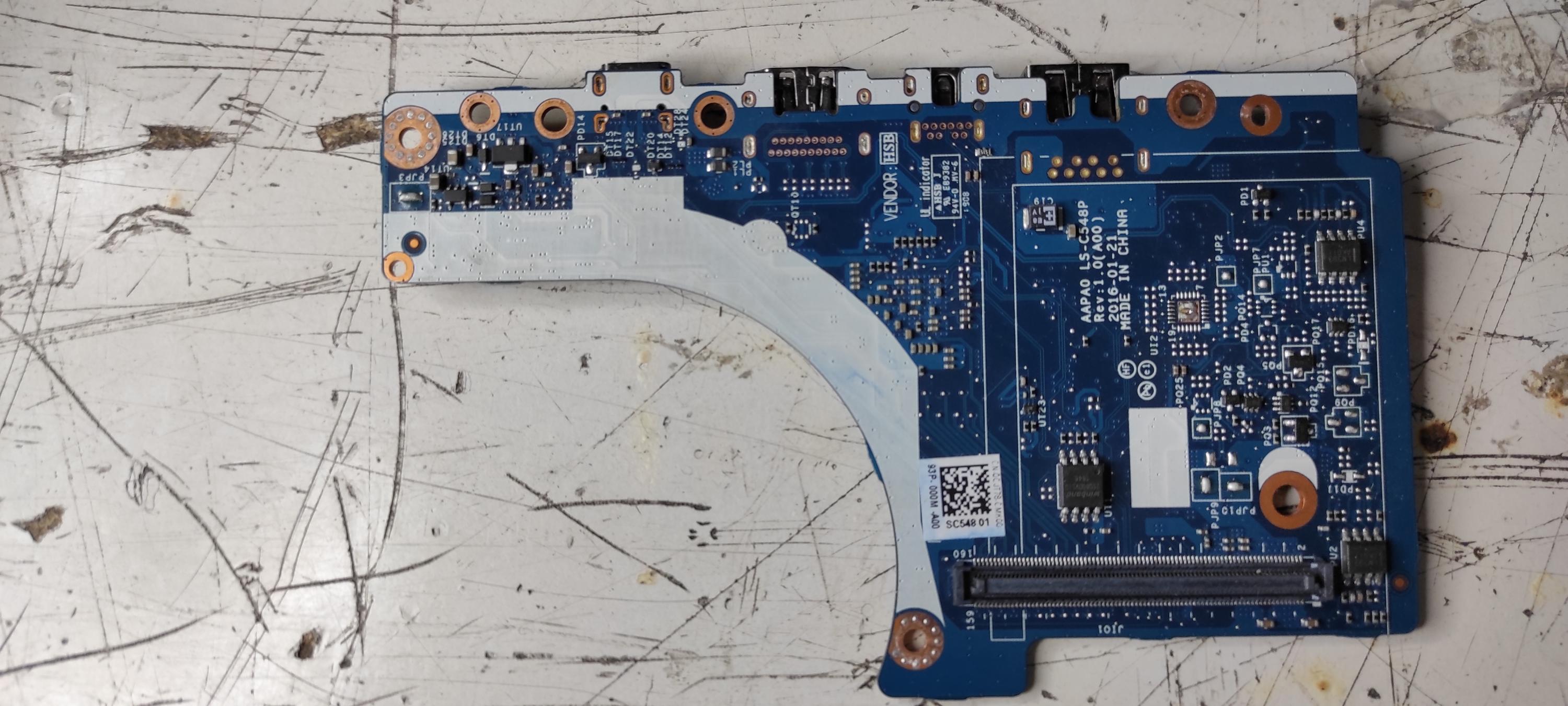

        Re: Dell Precision 7510 charge battery and left side board problem.
        Hello, sorry i forgot the pictures. Atrached now.
        @SMDFlea the battery is genuine and the side board looks fine BUT the laptop (including some drops on battery and side board) suffered water damage, i cleaned everything and works fine except these 2 issues.
        Can we check if the communication between MB and battery is fine?
            Good thing, you'll be able to cross check.
            There appears to be SPI memory ICs. Dump the contents from the client's board, issue may be with them.
            Another one could be the bigger BGA IC that looks like USB 3.0 controller, sometimes they go bang and short data lines.

              There`s 2 SPI memory ICs ,UT1 and UT20

                    Check PBAT_SMBCLK & PBAT_SMBDAT lines:
                    1. Resistance to dround
                    2. Voltage
                    Check PBAT_PRES#: resistance to ground with and without battery connected.
                    Check PR3: resistance between: 4-5; 3-6; 2-7
                        2. Voltage
                        PBAT_SMBCLK & PBAT_SMBDAT lines: Measured them on RP5, 7 and 8 pins.
                        1. Resistance to dround: No resistance to GND
                        2. Voltage: 3.3v both pins
                        Check PBAT_PRES#: resistance to ground with and without battery connected: Can't find a component to measure it. Any ideas?
                        Check PR3: resistance between: 4-5; 3-6; 2-7: 4-5 100Ohm 3-6 100 Ohm 2-7 100Ohm

                          SMBUS clock and data have to be checked with diode mode to ground.
                            So far so good.
                            Pin7 at PR3 - measure resistance to ground without battery connected, then measure the voltage with and without the battery.
