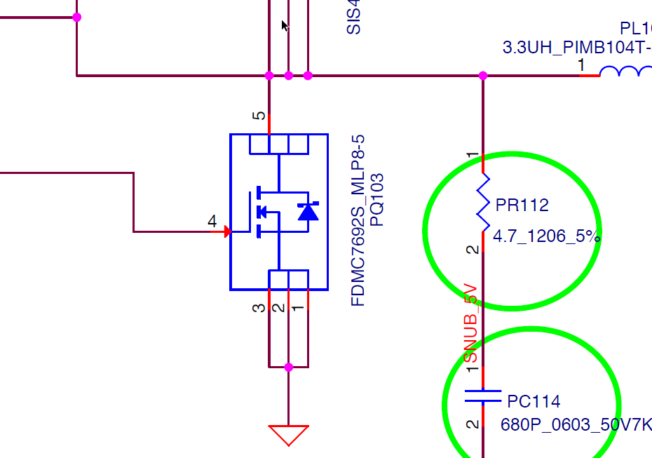

        #43
        Re: Dell Precision 7510 charge battery and left side board problem.
        Hi. Can you confirm that PQ103 is as per attached schematic ?
        You have removed this part and are measuring 20 ohms between the pads for
        GATE & SOURCE ?
        GATE & DRAIN ?
        SOURCE & DRAIN ?
        If yes, lift up one leg on coil PL102 and measure again.
        Post where exactly you are measuring the 20 ohms.

          #44
          GATE & SOURCE ?
          GATE & DRAIN ?
          SOURCE & DRAIN ?
          Hello!
          I removed PQ103 because DRAIN was shorted with GATE, then i notice that it's traces on MB are shorted/20Ω too.
          I measured DRAIN with SOURCE, DRAIN with GATE and also DRAIN with GROUND, all of them are 20Ω.
          Now with PL1L102 lifted i get:
          DRAIN with SOURCE 0.8ΜΩ
          DRAIN with GATE 0.8ΜΩ
          DRAIN with GROUND 7.5MΩ
          all measurements with BLACK probe on drain.

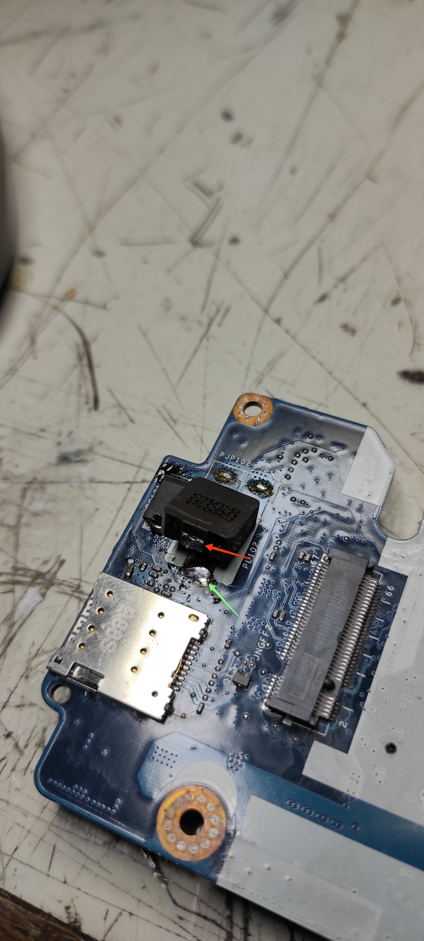

                  #48
                  PL102 lifted and short circuit is gone, no more 20Ω but several kΩ instead.
                  Short still remains on lifted coil (red arrow short, green arrow no longer short)

                    #49
                    Remove PL102 completely. Which side is which? Green arrow is pin 1 or 2 (referring to schematic).
                    Is PJP102 and PJP103 present?
                      • 21932
                      #50
                      PJP102 and PJP103 are after pin 2 of PL102. +5VALWP -> +5VALW

                        #51
                        Yes, side connected to PJP102 has 20Ω, the other is on ~300KΩ (with PL102 removed)
