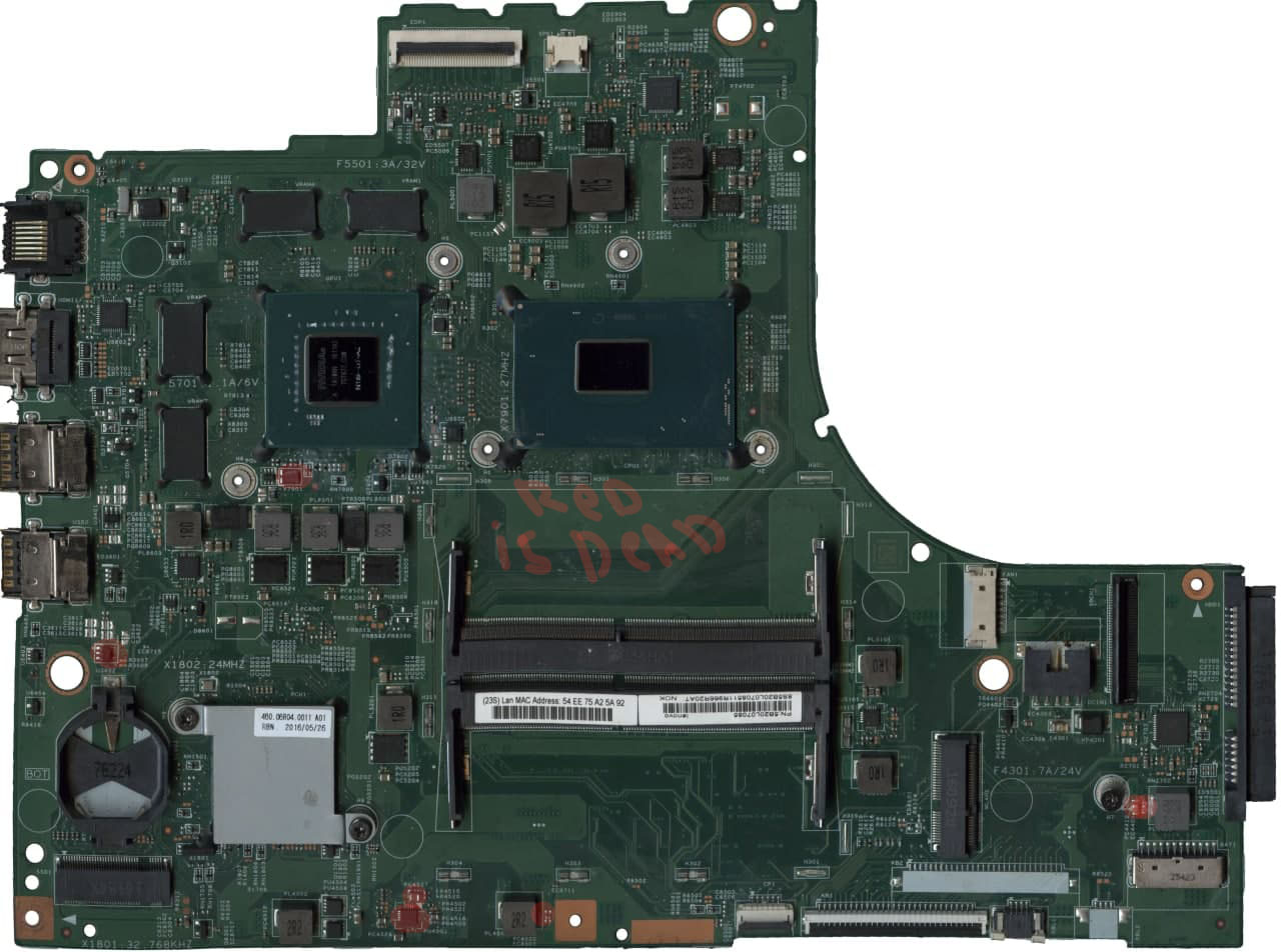

    In Short: the laptop was flooded with water 3-4 years ago, but after service cleaning was working fine, except battery wont charge on it. After years, a month ago, laptop just shutdown itself and never power on.

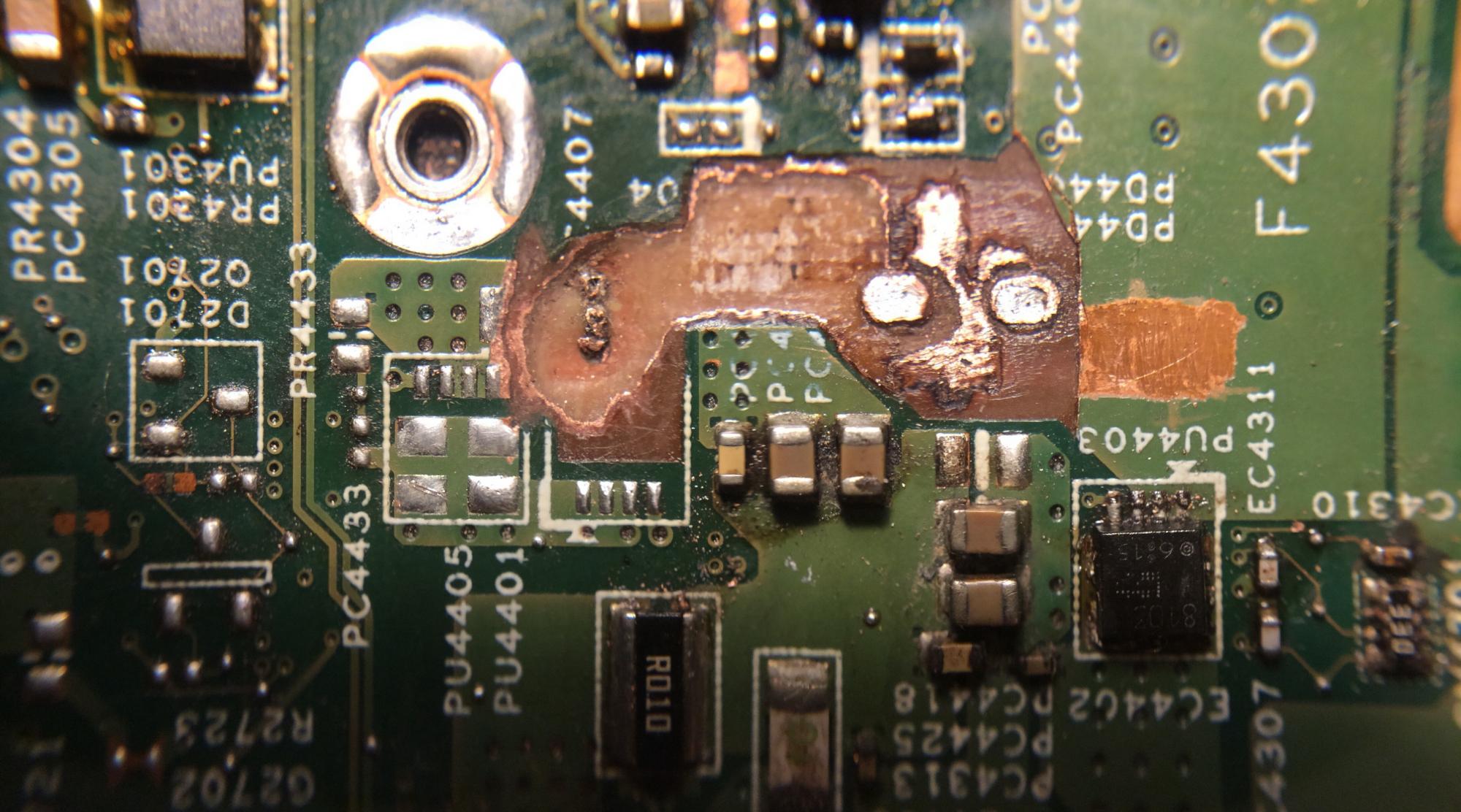

    After first board review, the short circuit was found. The capacitor died and burned pad. The temperature was so high that the two layers of textolite were burned. Good news that the layers was GND, so nothing critical. The burned fragment was cleaned and the short gone. Replaced them, but no standby voltage. When plugin DC, the 3.3v and 5v comes on but on one second and then off. the 19.9v are onboard.
    Adding schematic, boardview, scanview at zips

      I done force applying 5v on usb/hdd line and the board becomes really hot in the location of up4501 (can't remember the label). That ic responsible for generation main voltages: 3.3v, 5v.
      Almost forgot: the power button reacting on power on, but only on one second. So I think the best way to replace that IC and power controller, as it looking like after hard times.
      The main question: why so many capacitors were died... because of corrosion or high pulsating on pwm controller?

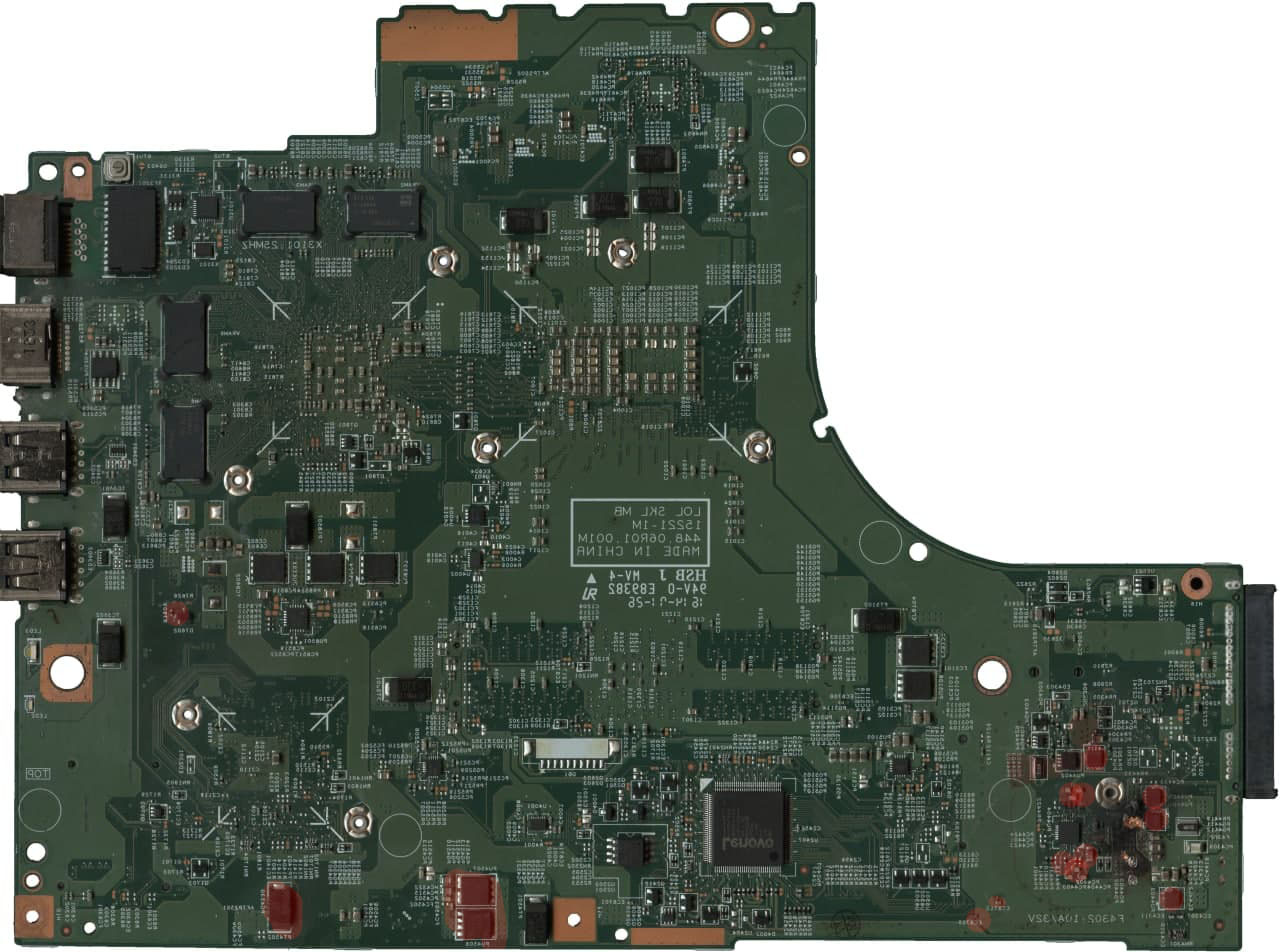

                  Added images. The first HiQ scan at first post.
                  Red - mean dead.
                  The story of board is sad: it was flooded with wine, after few years was extremely overheat (the isolation plastic is heat deformed) and the last is short and burn of layers

                    Is the carbonized laminate section scorched down to deeper PCB layers? Dig that black stuff a bit, it could be a multi layer short, doesn't look good. I've sometimes had to grind out mosfets that were completely welded in.
                    • EdwardGeo
                      • Mar 2020
                      • 109
                      • Ukraine
                      Re: Lenovo 700-15ISK-80RU - Standby voltage missing
                      Yeah, three layers. But seems that they were gnd

                              I think this board is a complete loss looking at this laminate, especially with layer to layer shorts. Once the FR-4 gets carbonized, the laminate gets permanently conductive in that spot and only gets a lower resistance with time.
