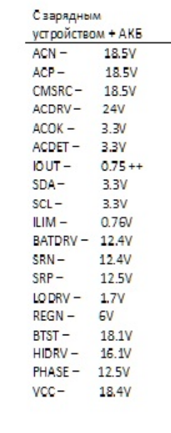

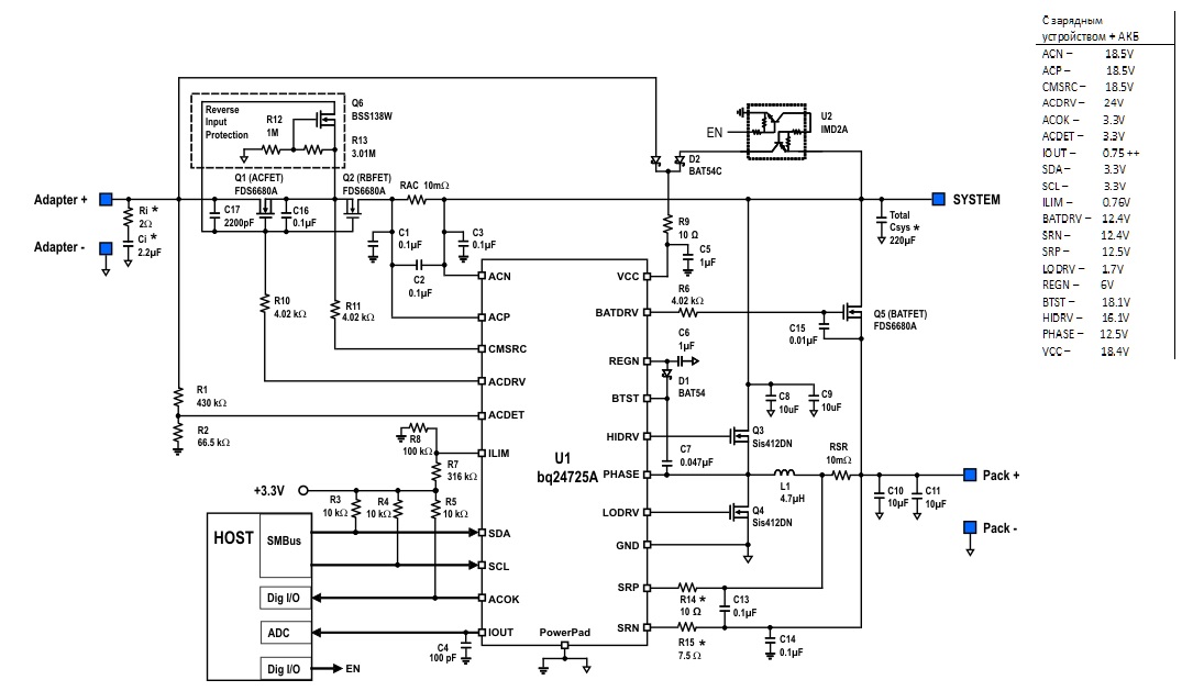

        Maybe this will help.
        I don't provide help for people using CH341A and a clip.
        • mon2
          • Dec 2019
          • 14662
          Re: HP LA-D711P no power after not charging
          @DanielDacko - great document !
          @incorrect, what is Vcc on this charger BQ IC ?

                          From @DanielDacko (see above post), attached are the normal voltages for this charger IC.
                          Do not remove and bridge mosfets - this can lead to possible further damage.

                          With the mosfet on the logic board - do you see the adapter voltage reach the right side of the 2nd mosfet ? What is the voltage ?
                          • incorrect
                            • Nov 2017
                            • 22
                            • Greece
                            Acn= 0.8v
                            acp=0.8v
                            cmsrc= 0v
                            acdrv= 0v
                            acok= 0v
                            acdet=2.6v
                            iout=0v
                            sda=0v
                            scl=0v
                            ilim=0v
                            batdrv=1.88v
                            srn=1v
                            srp=1v
                            gnd=0v
                            lodrv=0v
                            regn=6v
                            btst=5.8v
                            hidrv=1v
                            phase=1v
                            vcc=19.5v
                            Edit: Please note that if i replace the 1st mosfet with the shorted one, the machine works. battery doesn;t charge of course
